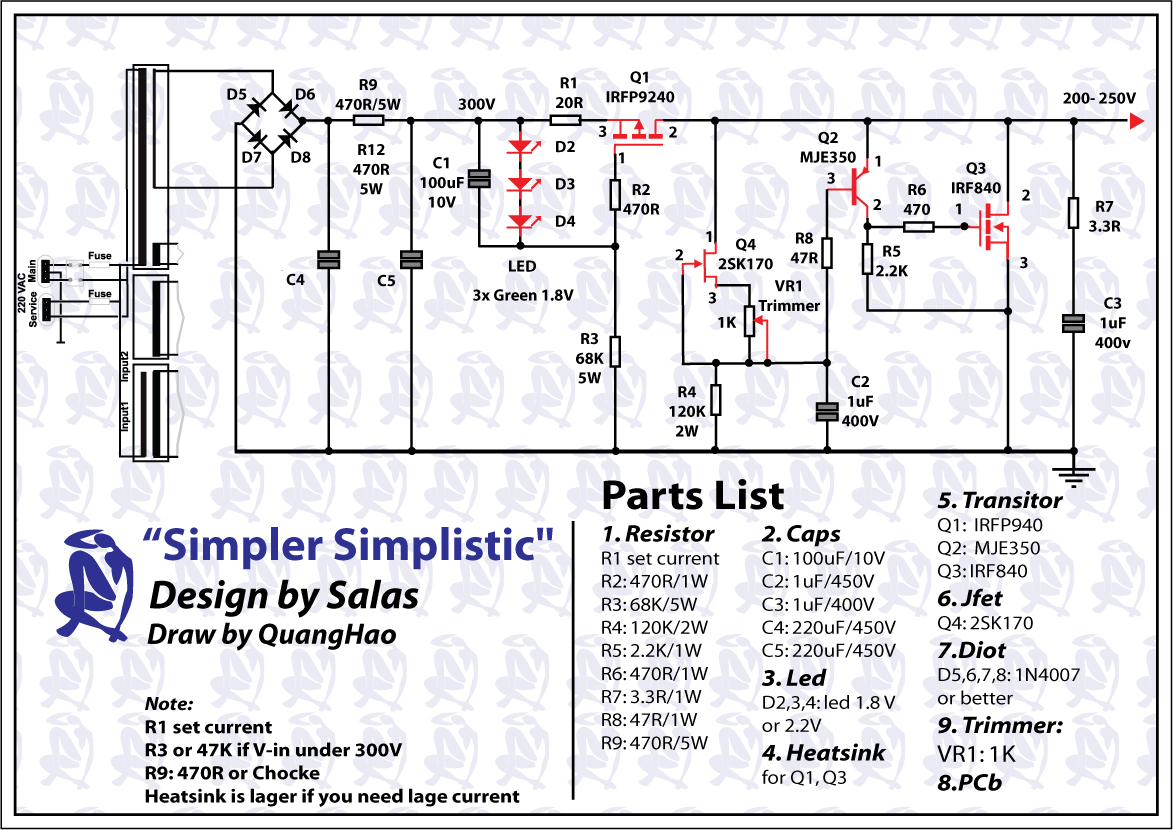

“Simpler Simplistic'' Design by Salas
Salas Welcome, welcome everyone!
After practicing with Salas shunt regulator, I show the “Simpler Simplistic''
Design by Salas is better than last vesion.
I redrawn cricuit I practic and value components of the doctor invited views and suggestions!
Thank Salas!
Thank everyone!
Quanghao

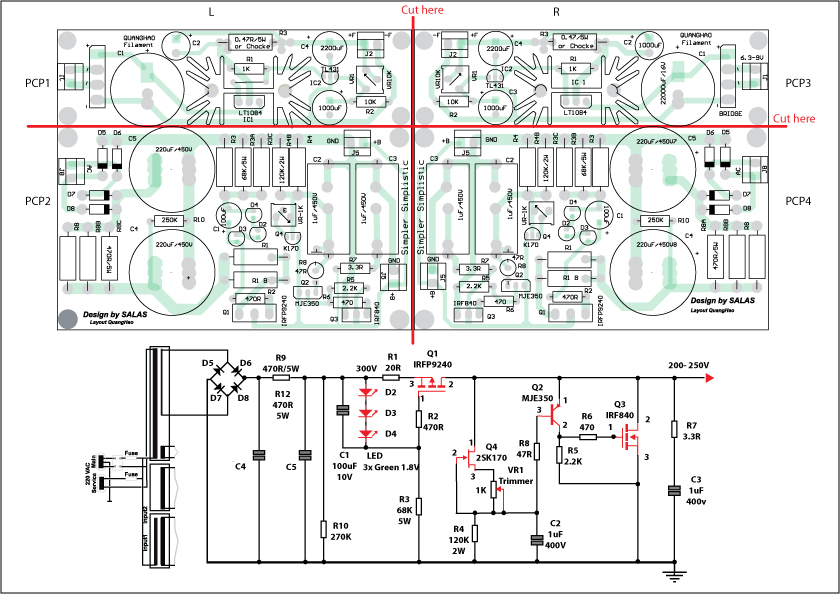

“Simpler Simplistic'' Design by Salas layout Quanghao
Dear, Salas and all friends!
I have completed the layout “Simpler Simplistic''.
One board with 4 separate:
1. PCB “Simpler Simplistic''x 2.
2. Filament x2. on the first sheet can be separated into 4 pcb with cuts.
The next weeks I will made 3 PCB for me and 5PCB for my friend, 5 PCb for gift!
I will gift 5 PCb to 5 member in diyaudio.com, if you interested please send me information on addresses, and e-mail, thanks!
invite you to view layout please!
Quanghao

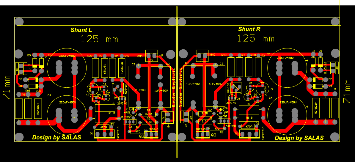

Dear all friends!
There are so many members want to do PCB “Simpler Simplistic''
I am always ready to help you!
However you must obtain permission Salas! Because It is Design by Salas!
If Salas agreed, and if allowed, I will make the PCB and share for all member like it!
Thank you Salas, thank all!
Quanghao

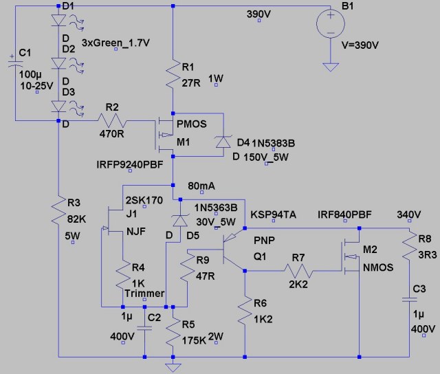

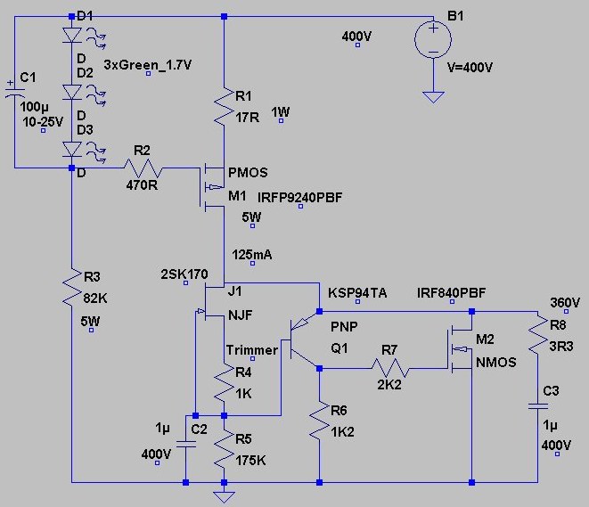

Here is my attempt for your shunt regulator for a line amp.
The amp's idle current draw is about 50mA (Salas 6V6 Line Stage). I chose CCS current of 125mA that on one hand should suffice for smooth operation and on the other hand will enable me to use EZ81 as a regulator. I prefer a regulator with the lowest possible filament power consumption. Also, I prefer not to draw more HT current than necessary for best operation of the regulator.
The way to choose R1 value is explained on the thread. I had to try and figure out the way to choose the values of all other resistors from the various variations of the regulator posted here. I'm concerned especially about the value of R5 on my schematic. 175K would be good for 2mA passed by 2SK170, but for 1mA it should be around 330K.
Any comments about the values I chose would be appreciated.
Also, a general question. Wouldn't the 2SK170, which has maximum -40V V-GDS, blow up, especially on startup, while C2 is being charged? How about 30V Zener across it to protect it at startup?
You would need 340V for the 6V6 line pre, not 360. Also 125mA will create much heat, 70-80mA will be enough since its a class A preamp. 30V Zener across the 2SK and a 150V Zener across the CCS Mosfet are good measures. Although it works without a problem in 2 recent 6N8S perf anode 2 stage preamps that friends made @ 250V B+ , I am not sure what will happen at 340V and your current, so better be safe than sorry. 47R base stopper for the driver BJT is also a good measure. There with those preamps we had the opportunity to directly compare a double mono Maida to a single Simpler Simplistic, and by their 3rd party impressions, there is no way back.
