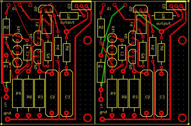

salas said:
Can you avoid double layer by routing the green traces differently?
I struggled with that and, so, far, am not able to avoid it. Is there a particular advantage to avoiding a double layer?
I don't know, cost? Elegance, ease for home etchers? Maybe better usage of the bottom layer as a ground plane than just 3 lines?
Here is a quick idea. I guess feasible if moved to center it again for some very little upper and left side edge clearance.

Thanks. You have helped me alot
Thanks, Salas, that was brilliant.
One of my big concerns was the possibility of a short with a trace above Q1, but I guess it must be OK...
Still fits on half a board, but only one half shown for clarity.

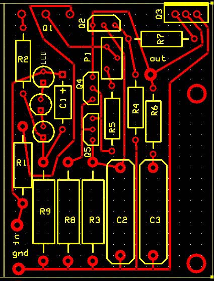

Class time!
I wanted to offer some pointers on board layout for better performance. Wanting to use to use an example I started moving parts around to improve the layout. I find laying out circuit boards to be a great puzzle. Much more fun than trying to put together jig saw puzzles... You can use the layout I've come up with if you like, tweak on it some more, or just use it for a learning example. The mouting holes are on the far end from the transistors. If the transistors are mounted to a heat sink you only need to support the other end of the board.
With a shunt regulators low output impedance and good high frequency response we need to be carefull of where the signal currents flow on the regulator board. The output loop needs to be as short as possible. Just like you would do star grounding in an amplifier or pre-amplifier, you do the same thing in the regulator layout.The first thing to note on the original layout is that the ground terminal is all the way across the board from the output device (Q3). All the components that are referenced to ground are between the output and ground points and on a small trace to boot. This is not a good thing.Shunt regs work by rapidly changing the current drawn by the output device to keep the output at a fixed voltage. With the long light trace you will have bad ground loops within the regulator. This will limit the performance and posssibly be unstable at high frequencies and or high currents.
The new layout has the circuit broken up into 3 main loops. The output reference loop, the output snubber loop, and the bias loop. The output snubber loop is isolated so that when it is doing it's job at high frequencies the currents will not effect the rest of the circuit. Like wise, the reference loop is as short as possible to help with frequency response and parasitics. The bias loop is all high impedance bias currents that should not have much signal current.
I took the liberties of using 1/4 watt resistors on the gate stoppers to save a bit of space. The rest of the small signal resistors could be swithed over to 1/4 watt also. Check the layout for errors- not having the schematic to match I was not able to link the board and schematic for error checking.
Look over the layout and let me know what you think. Personal preference would have larger pads for Q1 and the wire connections.
Here is the ExpressPCB simplistic.zip file for downloading. Be careful with the file as I did not rename it! Don't want to overwrite your copy...

Thanks Gary for helping the PCB for the people. I only do P2P with hardwired sub star grounds etc so I would never develop and test a recommended PCB. I have read your concepts about the layout and I agree. Regards.

And maybe Q1 not so close to Q2? Its better to spread the heating points on the sink.

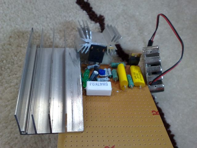

Hi Salas
Got all the parts, and has been arrange it PTP like the Gary's Layout.

hi Salas
nice.. i got some heatsink confusion. attached the picture of several heatsink i got. can i use the smallest one on the irfp9240? the other one is cpu heatsink with fan. then the other one is for 2n3055. thx in advance
thats the board that i arrange with Gary's suggestion layout. haven't soldered them in. but should be find as i am going to prove read it again before soldering.
erwin
