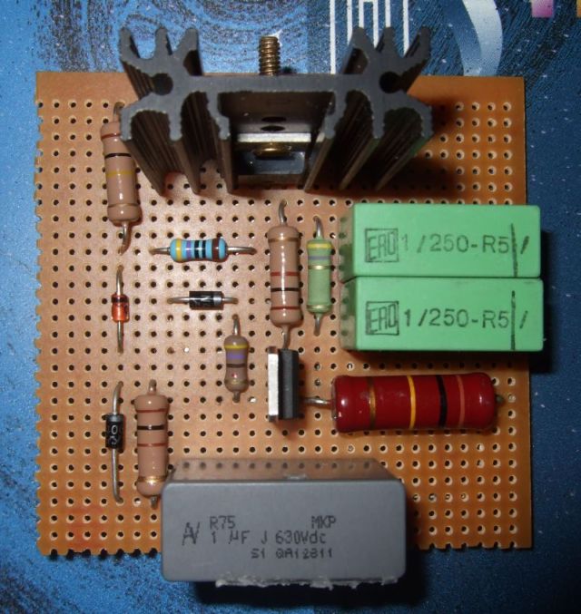

They look OK for the moderate cuurent and voltage difference you gonna use. Put thermal grease for the surfaces to contact well. The aluminum looks rough.
hi Salas
yep the aluminium is rough. i cut them into half myself. lol. they are cheap. they small one on the back of the irfp9240 is just around 15cents.
thermal grease? does the drain of the mosfet need to be isolated from the heatsink?
JC951t said:
Hi Gary,
You missed out Q1
i think its there on the top left conner. just not labelled. Gary?
erwin
If the 2 Mosfet heatsinks are separate, and no one of them will ever touch ground, you can not isolate them, but if you touch them they will be on high voltage. Since there is always chance for an accident, I would highly recommend you use mica spacer pads and thermal grease, plus isolated screw for 840, 9240 normally has isolated screw eye. Best of luck with your project, let us know more when ready and listening.

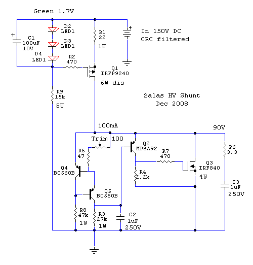

Hi salas,
I would like to try your regulator in a a low voltage triode line stage. The target voltage is 90 Volts.
Could this be done with simple changes to the schematic at post #2 or use the schematic as is and drop the voltage to 90 volts using an RC ?
Your advice will be much appreciated :worship:
Marinos said:
Hi salas,
What is the bias current?
Set the 100R trimmer at about half before firing the shunt up. After half an hour of thermal stabilization, set for 90V and forget. Happy listening.

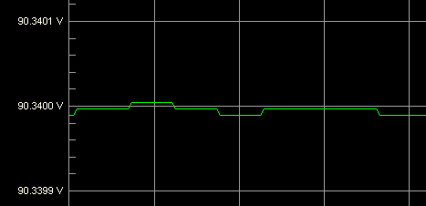

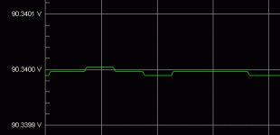

revintage said:
Hi Salas,
Ripple seems a little high when I sim this. Maybe I have the wrong ripple for the rawsupply. How much ripple do you consider at input?
Its not meant to be a great ripple filter. I made it with always assuming at least a CRC or lightly CLC pre filtered DC input. It says ''Rectified and filtered'' on the schematics. Its a part of the philosophy behind this reg so to make it simple and with the tone I wanted. That is why I don't boost the CCS with current sourced controller BJT, just LEDS. You can consider up to 100 or 200mV P2P input ripple just for test purposes, but in reality, after a typical CRC that is so common in HV tube practice, it receives much less.
That was one of the ideas. Sans extra caps. I get less at output with even 200mV 100Hz P2P input ripple in my simulator, but this is beside the point. A passive filter before the reg takes care of this minor issue.

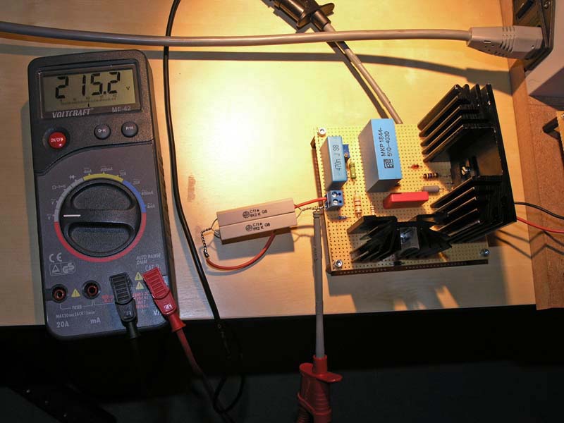

Still waiting for the custom transformer to test my shunt reg....
BUT, while I was at it... I also built a Maida regulator with an IRFS450 / LM350 combo for my Aikido headphone amplifier.
After I flipped the switch it started to work flawlessly, only a few turns on the trimpot was needed to set the desired voltage.
Very much to my surprise it generates very little heat, after an hour the Mosfet heatsink just gets warm to the touch.
Which leads to a question (OK, doing a bit of threadjacking here, but it basically also applies to the HV shunt reg 😉 ): How much voltage should be dropped across a Maida regulator? Right now I am dropping 35V...
First listening impressions were very positive... the amplifier is much quieter than the proverbial churchmouse 🙂
I hope I can do some comparing once I have the shunt reg running.
PS Total cost of the Maida was a little over 10€ using parts from my parts bin, surplus and items I scored on E-prey...
