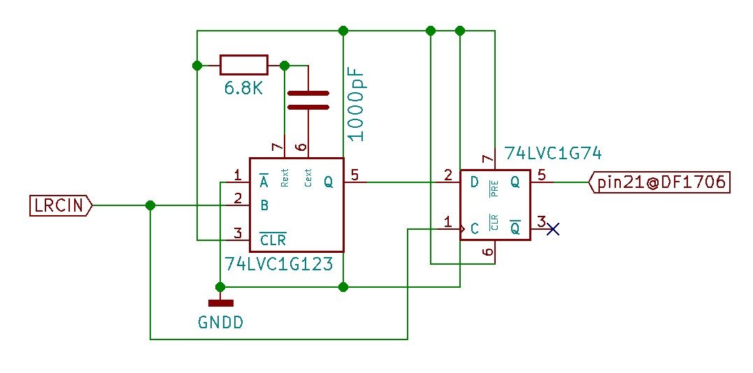

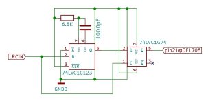

Another approach for sample rate detection:
Actually, it is literally the same as I describe.
Start a timer with an LRCK period, latch the result. If the timer expired, the sample rate is "low" and if it still runs the sample rate is "hhigh".
Main difference is that what I propose can detect multiple sample rates (up to 3 with a 4-Way Flip Flop) and and it can reliably the difference between 44.1 & 48kHz. Making the circuit you show 3 times allows three different sample rates to be detected, as for the difference between 44.1 & 48kHz, that's something that I think is beyond RC levels of precision.
As a pure 1X detection is probably fine.
Thor
Reactions: jpk73

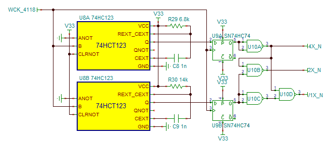

As a 74HC123 & 74HC74 have two sections each we can easily make a 1X/2X/4X detector. RC values may need empirical adjustment:
As the N Suffix on the outputs suggests, this is active low logic.
As both 74HCT123 sections will be switching with appx. FS decoupling and isolation of the power supplies is needed. On the + Side, there is no extra clock with an different clock frequency. And it is totally stand alone with on WCK supplied, no extra clocks etc. VERY SLOW logic can be used without problem.
As said, testing for 44.1/48kHz is not valid given tolerances and other factors. As alternative DIR9001 plus a 24.576MHz can do the same with a single IC and can detect 44.1/48k but cannot detect 2X/4X.
Divider Cascade and Crystal clock is able to detect everything but has a lot more switching noise.
Thor
Reactions: jpk73
I built the circuit shown above and tested treshold: there was a very distinct frequency where detection occurs. So if you could adjust RC precise enough it should be no problem to distinguish between 44.1 and 48k. Maybe use a trimmer for the RC...? Or are there fixed parts with low long term drift...? Also Amareno/JLsounds have pins that provide SR rate indication. Using 4118 would allow detection as well I guess...
And for your tasks maybe there is no need to detect 44.1 vs 48 based rates...?
Yes, but the frequency threshold is supply voltage and temperature dependent. Even with a perfect Resistor and capacitor there will be drift.
The cycle time of 176.4kHz is 5.66uS while 192kHz is 5.21uS. That is cutting it extremely fine for RC timing.
If we throw in extra dividers, why not use a crystal based reference?
Good luck.
Yes, but that is USB only.
For that you need to do a few things. Software mode is essential, so we are looking at programming a CPU and controlling the AK4118 via SPI or I2C.
And we need to run the build in crystal oscillator which destroys all the nice low jitter. For AK4118 with low jitter, use hardware and no crystal.
It seems the AK4118 really gets low actual jitter on MCK if used right.

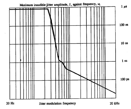

What is the generally acknowledged limit for jitter audibility with sine waves:
Now this is an artificial case, but it is clear that very low jitter frequencies allow much higher P-P jitter levels before becoming audible. Interesting note, the "knee" in the curve happens around where where the head shadow disappears and hearing uses time of arrival difference to determine location while where there is high sensitivity if where in effect amplitude difference drives localisation.

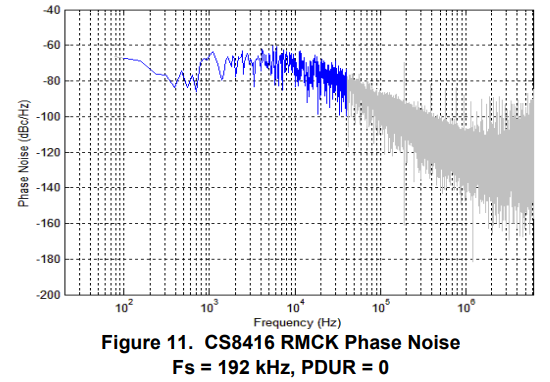

Are there no good ICs for that task available that allow us to clean out the incoming jitter?
There used to be ones, it has just become unavailable. Another decent one disappeared before that. A lot of stuff that looked interesting turns out to have usually jitter rejection corners in the kHz region and shitty LF Phase noise.
So now we need two VCXO's at 22.5792MHz and 24.576MHz and the necessary analogue PLL and all that.
The generic VCXO at Mouser all deliver -70dBc at 10Hz offset, that's not great. There are a few specialist devices but not easy to get. And designing a complete PLL that is low noise and locks fast etc. etc. does not to me seem like a good proposition.
So no, there are no ready OTS "jitter cleaner" IC's that are worth having.

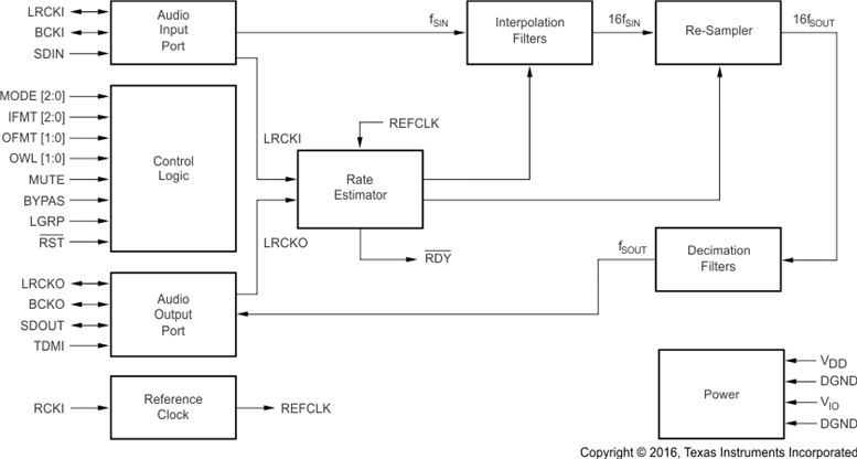

An ASRC is tool and like all tools it needs care to use. Lets look at a relatively well understood ASRC:
Let's take the usual option, Crystal to REFCLK and divider from Crystal to BCKO and LRCKO.
Do we need to care about BCKI & LRCKI? The rate estimator is a 2nd order lowpass at 0.0005*FS/2. That 12/24/48Hz at 48/96/192kHz.
So we probably want to take care of reclocking BCKI. Asynchronous reclocking that scrambles jitter to >> 48kHz would probably do the trick of pushing Jitter out of band.
