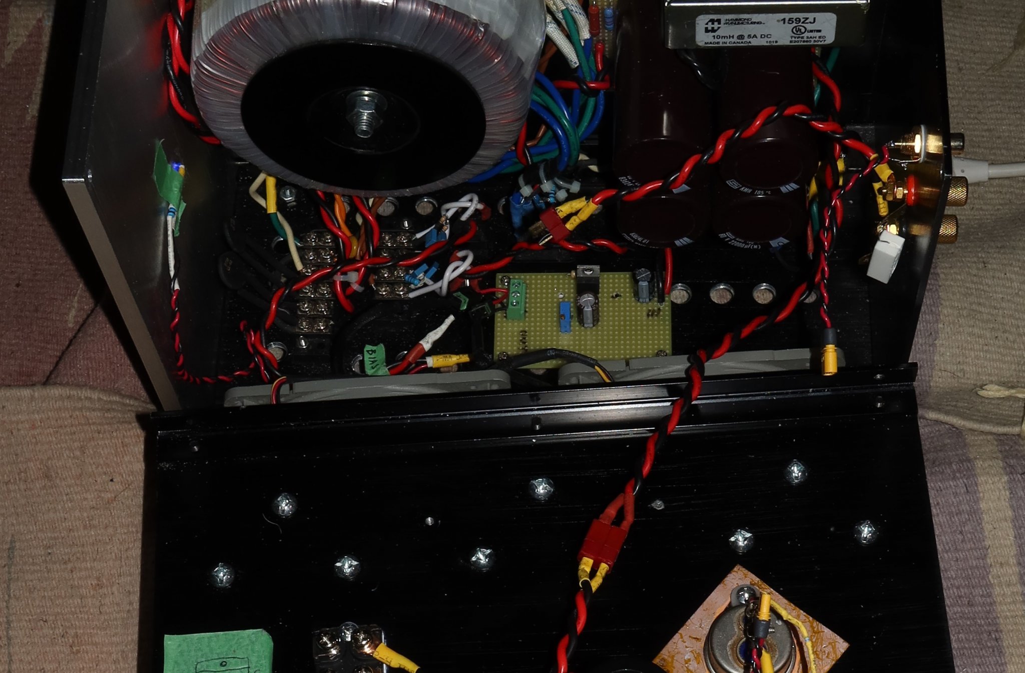

I am nearly done pulling together what I want for this build. I'm going to do a dual mono power supply with a single Antek AN-10450 transformer in one chassis. The 5U/500mm chassis will hopefully be big enough to allow passive cooling but if not I'll stick a couple of fans outside or under it. I believe I have all the parts in my cart on Mouser or already ordered from DigiKey.

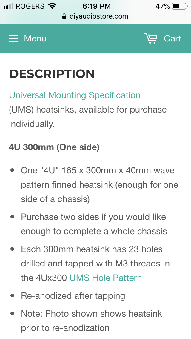

Three holes at top and bottom are different (larger) than the UMS holes for transistor and stand offs. I have M3s at hand and can confirm these holes are larger. I don't have M4 or M5 so...I can't check.I can guess and shotgun it....but figured someone would know.All the UMS heatsink seems to be tapped with M3, see pics.
DiyAudio store / Modushop 300x210x40Where is your heatsink coming from?
No fancy control circuit. I built a simple LM317 regulated supply with a trimmer pot to adjust the voltage, all on a piece of perf board. The raw DC is provided by a winding on the Antek transformer and a bridge rectifier. The PS board can be seen on the bottom of the chassis.
The fans are on with the amplifier, and they run at a reduced voltage.
