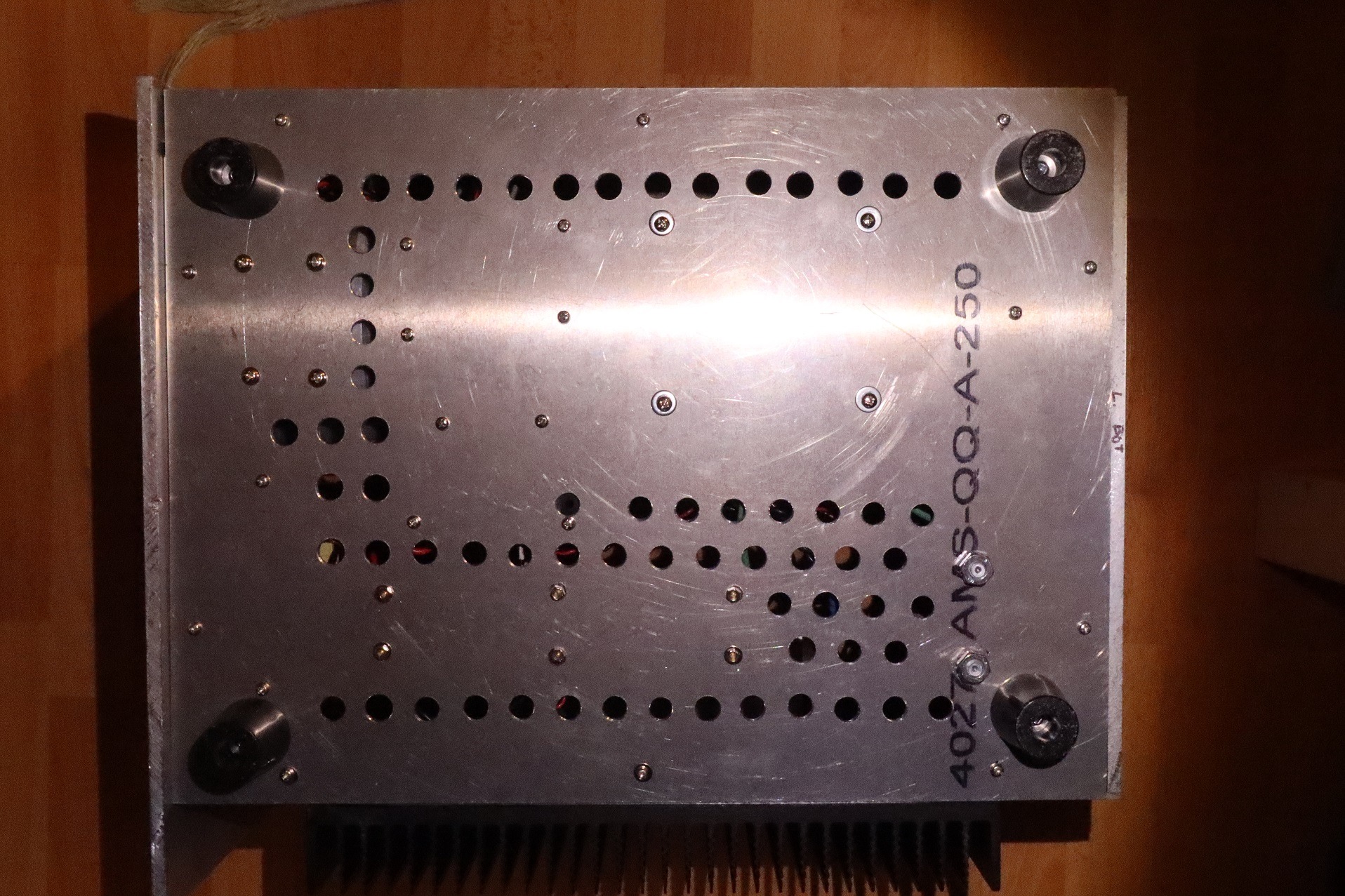

Here is my diy chassis of my choked 2SK180 follower mono-block amplifier. It is aluminum with one 300mm x 40mm x 210mm modu heatsink available from the diyAudio store. The heatsink dissipates 88W from one 2SK180. The heatsink gets mildly hot, but not hot enough to burn. I can keep my hand on it indefinitely. There are cooling holes in the bottom plate as shown, and also holes in the top plate. There is enough natural air flow that the interior of the chassis gets only a bit warm.

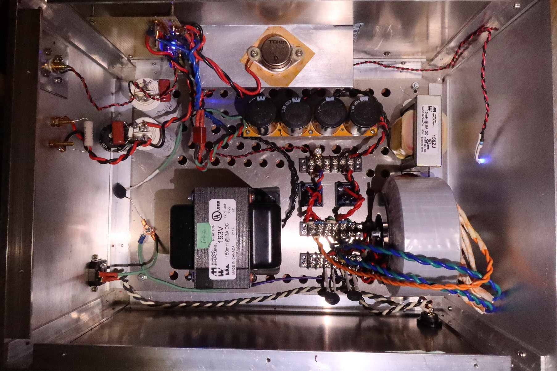

All of the ancillary products are in place and tested. Next is to spend the weekend double checking polarities , connections and values of the boards. Then hook em up and start cooking.

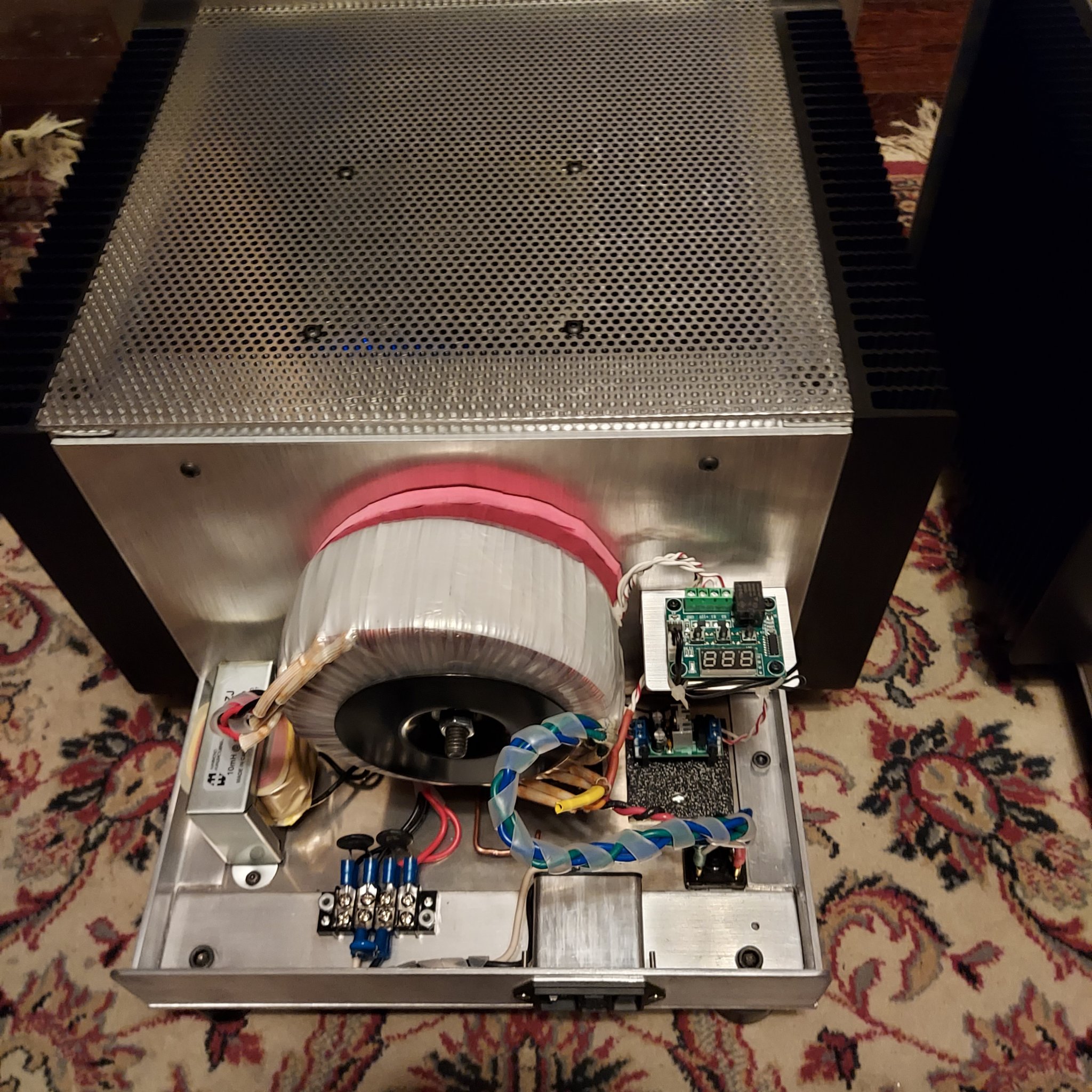

The fans are surprisingly quiet yet still barely audible from a couple feet off. The noctua voltage dropper is in place for now , may remove it later. Will see what can be heard from the listening position and if it is a non issue.
Sensor for the temp control is mounted to the power supply cap and reads the same as my infrared thermometer. If the controllers survive their placement near the heat sinks, I will at least have gained an easy spot to check temps. A layer of silicone sheet can be placed between the bracket and case if needed. If the controller becomes problematic I will remove them and use the bracket as a stand for a Nelson Pass bobblehead.

The exposed AC power is not safe. It should be enclosed to prevent a person (or animal) from contacting live AC.
It should definitely be enclosed - with at least sturdy mesh. Apart from the risk to humans and pets as Ben points out I had a lizard crawl into a similarly exposed test rig I was using some years ago and it managed to incinerate itself and fry several parts on the amp! So there’s also risk to your hard work in exposing those high voltages.
Thinking of a half height enclosure for the rear with a toroidal enclosure . All of the brackets needed to mount said enclosure are present, just need a solid plan. Haven't found the xformer cover yet either. Antek has the CA-400 yet I am not convinced there is enough clearance for the wires (designed for 400va units while these are 500va). The covers somehow have costs compatible to the transformer? I will do something......No Lizards will be harmed in the production of these amps!
That must have smelled incredible !It should definitely be enclosed - with at least sturdy mesh. Apart from the risk to humans and pets as Ben points out I had a lizard crawl into a similarly exposed test rig I was using some years ago and it managed to incinerate itself and fry several parts on the amp! So there’s also risk to your hard work in exposing those high voltages.
Exposed Ac wires are of course a big no-go.

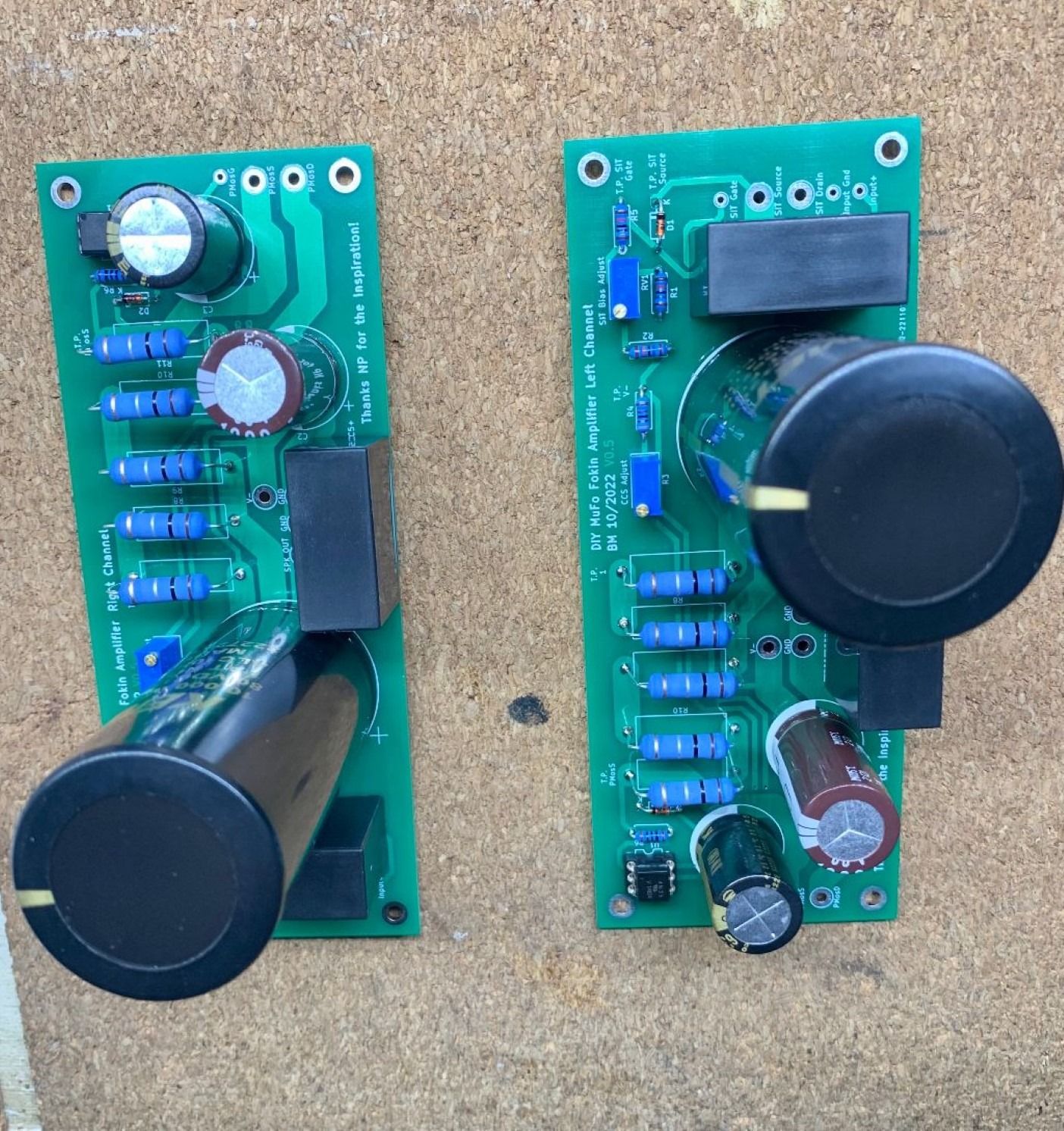

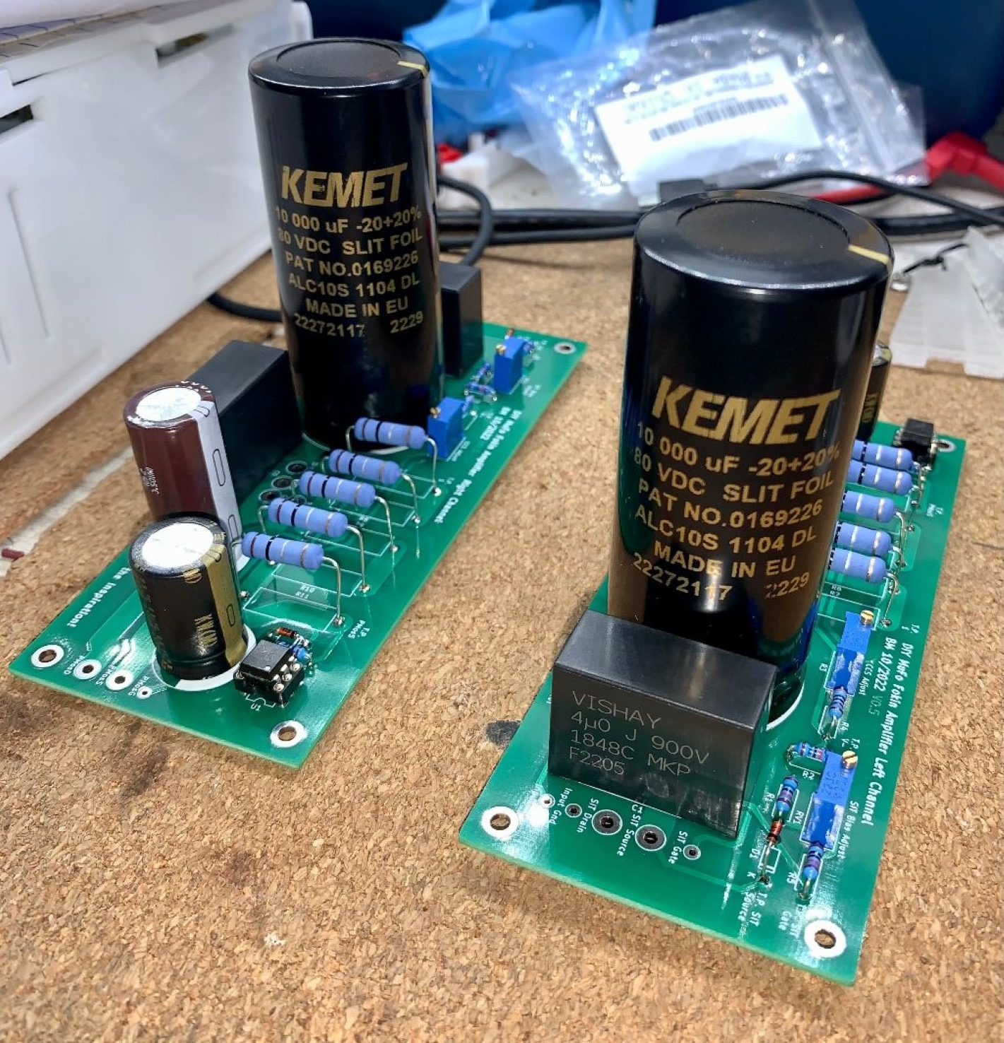

Hi,My runners (they refer to themselves as 'mules', claiming exploitation) arrived back home for Christmas bearing cargo - liquid and solid. Among the solid were the boards Ben kindly offered earlier as well as the Bits Of Material to populate his boards. Once the dust had settled after the festivities and the runners had returned to the cold north I built the boards and the next step is to go to the friendly local metal purveyors and scrounge through their 'waste' for chunks of aluminum for temporary radiation duties.
I intend using the 800VA transformer I salvaged from the Krell KST-100 chassis I used to build an M2X back in 2019 Before Covid. Secondaries are around 42VAC on an average day so rails around 54VDC I expect. It's what I have on hand so for now at least... have to prioritise the runners' loads each trip.
So here's a couple of images of where I'm at. Progress may be slower than most as, not only am I having difficulty remembering where I stored the caps from the Krell, but there's also cargo from His Mightiness on the way as well as the All Mighty's lottery amp kit hopefully on the way from it's temporary stop in Florida. It's not all for me (sadly) - the locals say I have not yet attained GB status, I'm merely their db (designated builder). But I'm aspiring to Greedy Boy status....
