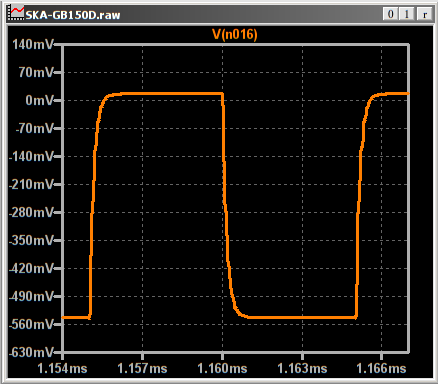

In simulation this amp has much less distortion than the measurements in this thread. That's even using known accurate models.
The amp may be stable, but it may still have a ringing problem based on simulation and some scope shots in this thread. However there are many things that could be hiding this problem:
1: 750R/330pF low pass filter - only hides ringing, doesn't make the amplifier more stable.
2: The signal generator must have a fast risetime of 10nS or so, otherwise the test falls out of the scope of possible misbehavior of the amplifier.
3: Thick lines on oscilloscopes, especially pixelated digital ones hide the subtle ripple that shows the ringing.
The ringing looks like the image below in simulation, using 10nS risetime when the LP filter is removed.
Let me mention briefly that just because an amplifier rings does not mean it will ever oscillate. There is a high probability, yes, if it's the feedback loop that's ringing. However sometimes you will have film decoupling cause ringing which will show up on the output. Although it is still possible that an amplifier may have a ringing feedback loop without ever breaking into oscillation. It is of course considered undesirable and bad practice, one reason being that a resonator is like an antenna, and can cause RFI sensitivity.
