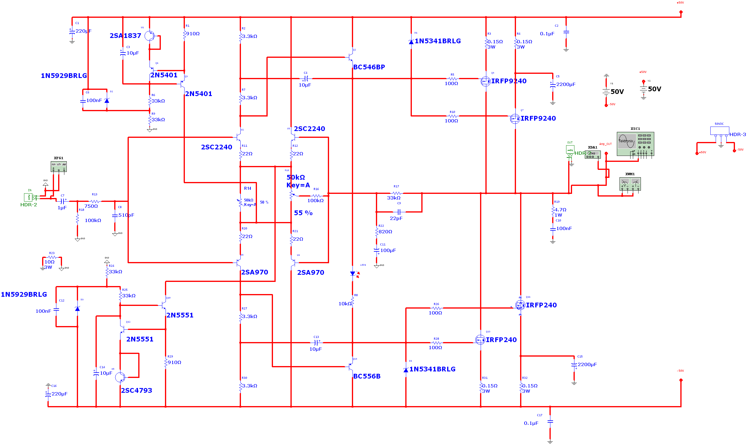

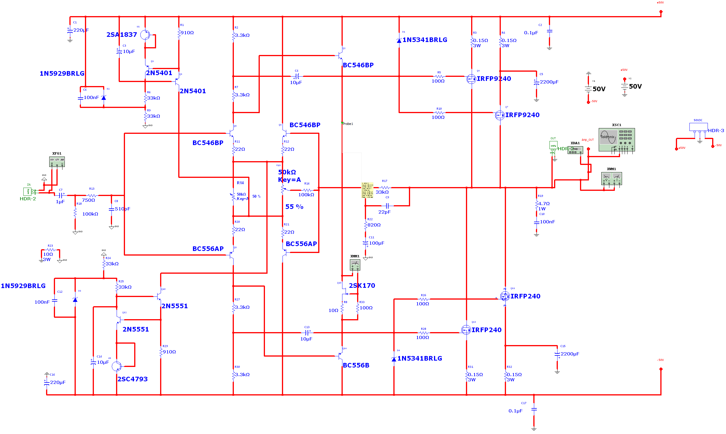

I find yellow on white very difficult to see.
Is that my problem?
How about this, sir?
Forget K170, it's there for fun only
Why are you using very low gain Grade a input stage transistors? Even the b grade are low.
Amp Guru (if I have the correct name) arranged a group buy, on this Forum, of bc546c & bc556c specially for this amplifier.
Is the input current temperature compensated to the output stage?
That was a fairly important parameter of the original amplifier.
Sir, as mentioned, I use 2240/970BL because I have some stock, convenient to me to use them.
Why post the wrong sch and then ask question about another sch?
My apologies. Sorry if that bothers you a lot.
I understand AndrewT!
You post a diagram impossible to see, then you put another with further references, and you say it's for fun.
It's a big mess, how to find?
My apologies again.
