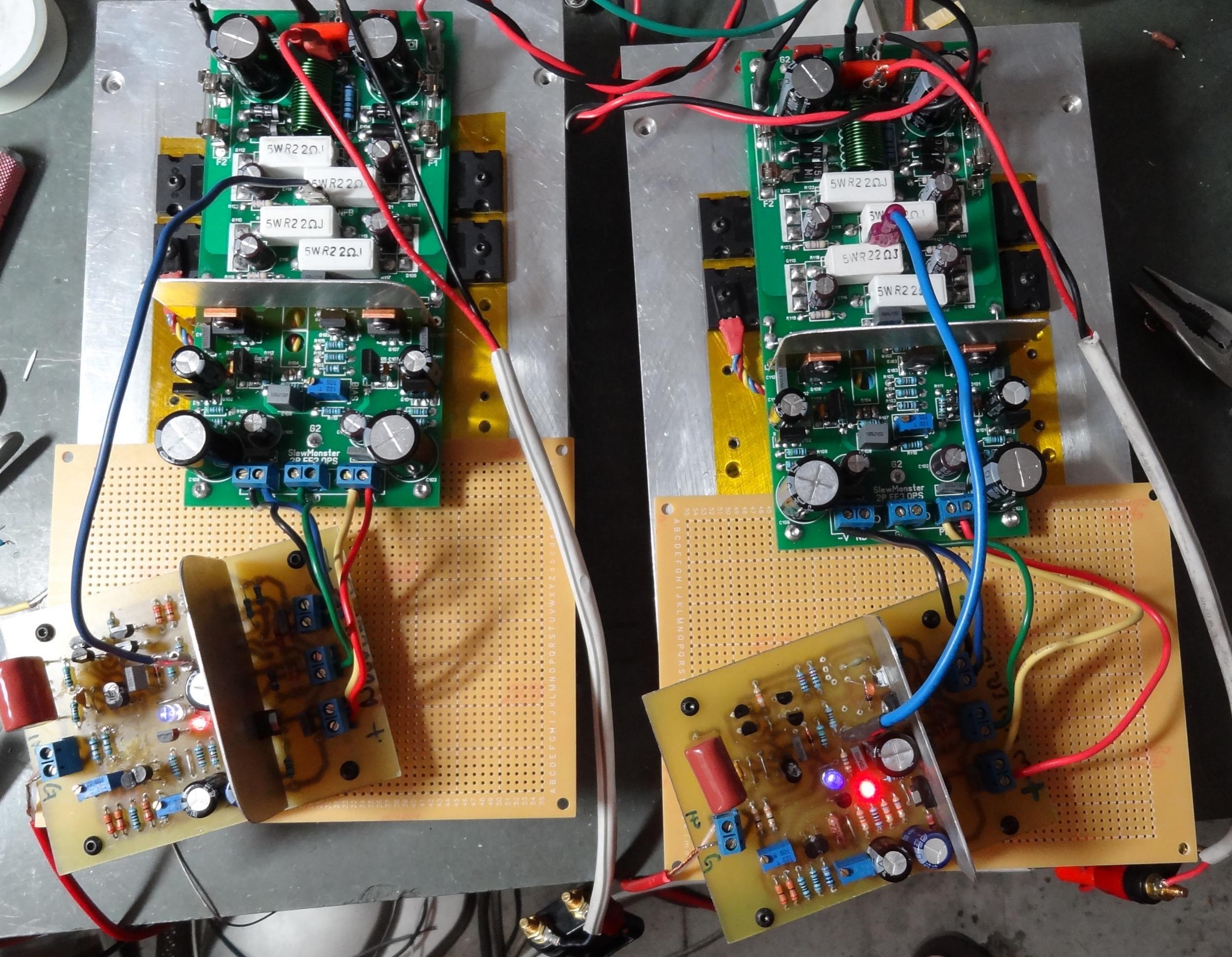

The Slewbaby is playing!!!! I hooked it to my home etched Wolverine IPS. Really sounds lovely. I have a question about SOR. I never understood how to measure that. I'm using MJL4281/4302 for my outputs. What is the highest voltage I can use into 4 ohms and still be OK? Right now, I am using a variac to hold it at about +-54V. It is running nice and cool with the bias set to 25mV across a pair of emitter resistors. I would like to go up in voltage some if I can but I need to know about the SOR.

That's what I was afraid of. Nothing wrong with that except that just puts it in the same realm with all the other small amps I have but with a much larger footprint. I guess it does have the advantage of accepting different IPS topologies. I'll compare it to the Ovation nx and see how it does.

Thanks Jason, my second board is good to go. The DC offset now is 1mV and set bias at 75mA. The 2OPS/symasui are next.Bring the OPS to 10mA or the minimum you can get if it doesn't go that low when connecting the IPS for the first time. On the CFA-XH, centre the adjusters as a preset. Use the adjusters to get minimal offset and then adjust the OPS bias. The actual VAS current has a limited range and will be in the ballpark with the adjusters centred. Try that and see how it goes.
The testing procedures for checking the sections individually is just for verification, when joined together they should be setup together.
Quan
Another good thing about building the baby slew was that while testing it I discovered that the oscillation issues I was having with one of my Slewmonster boards had damaged one of the previously good CFA-XH IPS boards I was using. The new baby slew showed that which is why it was being tested with the Wolverine boards above. So today I hooked up the Wolverine boards to the Slewmonster boards and the oscillation is gone. Very happy. It's cool that Jason is tackling the Wolverine next. It is really really good sounding, as a Blameless should be.
