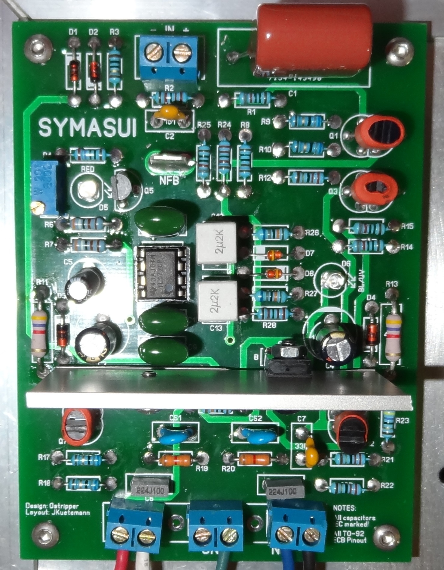

Here is a picture of a Symasui that I know works.
Looks like a few of the capacitor values on this board are different than mine.
I used NJW0281/0302 for drivers in my latest boards. They work fine. I will try to get time to take some voltage measurements. Double check all of your resistors and make sure they are all right. One one OPS board I had the wrong transistor in the cap multiplier and had a 5v drop instead of 1 1/2V. Just recheck all the TO-225 devices for proper device and orientation.
