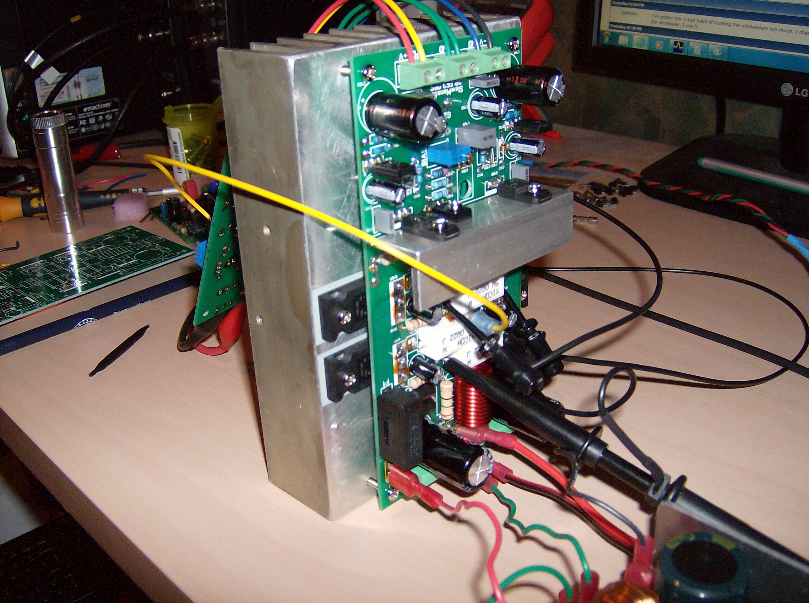

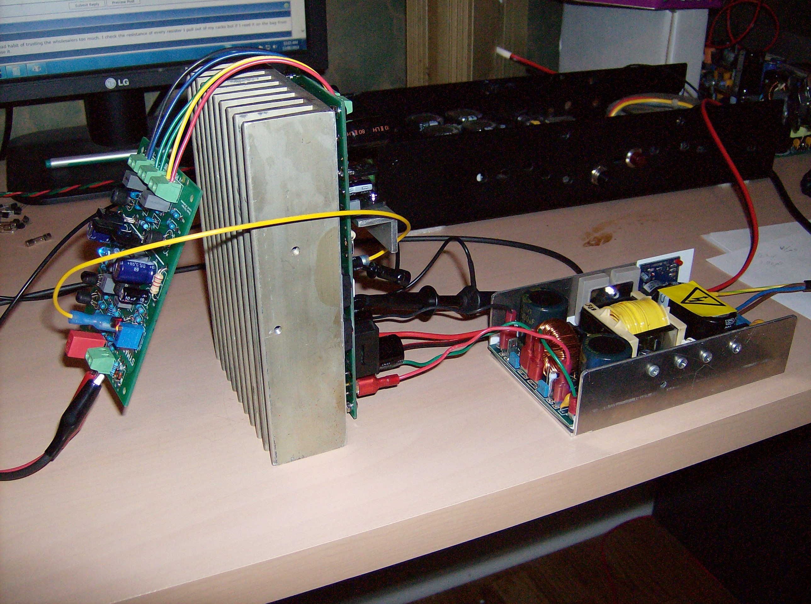

MOSFET Option
I can now confirm vzaichenko's (Valery's) findings about the ability to adapt the design to the use of MOSFETs without much ado. No physical 'hacks' required. I built my example on a 2P OPS board.
I chose to use 470Ω for R113 and to install C114. Transistors Q105 and Q106 are omitted and a jumper from B-E installed in their place. Components C107, C109 and R110 are omitted. The original 4.7Ω BJT 'Base Stoppers' R116, R119, R120, R123, R124, R127, R128, R131, R132 and R135 become MOSFET 'Gate Stoppers' of 220Ω. Driver compensation CSA and CSB are installed. Gate protection zener diodes are installed on the back of the board to protect the MOSFETs. I used IRFP240 and IRFP9140 outputs from Vishay.
R103 and R107 are 100Ω and 2.2kΩ respectively, but this is quite overcompensated. Running on +/-45V rails the OPS bias starts off at 170mA per pair and takes 30 minutes to settle to 90mA per pair on my smallish heat sink that reaches a terminal temperature of 41°C (a 16°C rise over ambient). The small driver heat sink operates at about 30°C. Clearly I need to tweak the thermal compensation temperature coefficient to better control the OPS bias, but overcompensated is at least erring on the safe side.
Is this reversed? R103/2K2, R107/100R? I read back through the other thread and didn't see or understand why the predrivers were removed. Can you explain?
Thanks, Terry
Thanks Terry, I reversed my values. Too late to edit it.
The pre-drivers are smaller TO-126 devices and aren't on any heat sink, so getting them to pass enough current to drive the MOSFET gates will make them hot. Using the drivers instead allows some heat sinking and thermal compensation for them, so they can be run hard enough to properly drive the MOSFETs. Valery tried using both and felt there was little to be gained by doing so. Without any direct measurements I can't say, but my feelings are we are likely best to just use the single EF stage to buffer the MOSFET gates. Seems to work in practise.

Very cool Jason!
Yes, because of significant change in bias voltage, Vbe multiplier overshoots a bit, so there is some room for improvement here (though, it is not critical, just a matter of inspiration for perfection 😉)
Terry, one pair of drivers is still needed - yes, it works without them, but distortion is higher. One pair of drivers is exactly what we need here.
