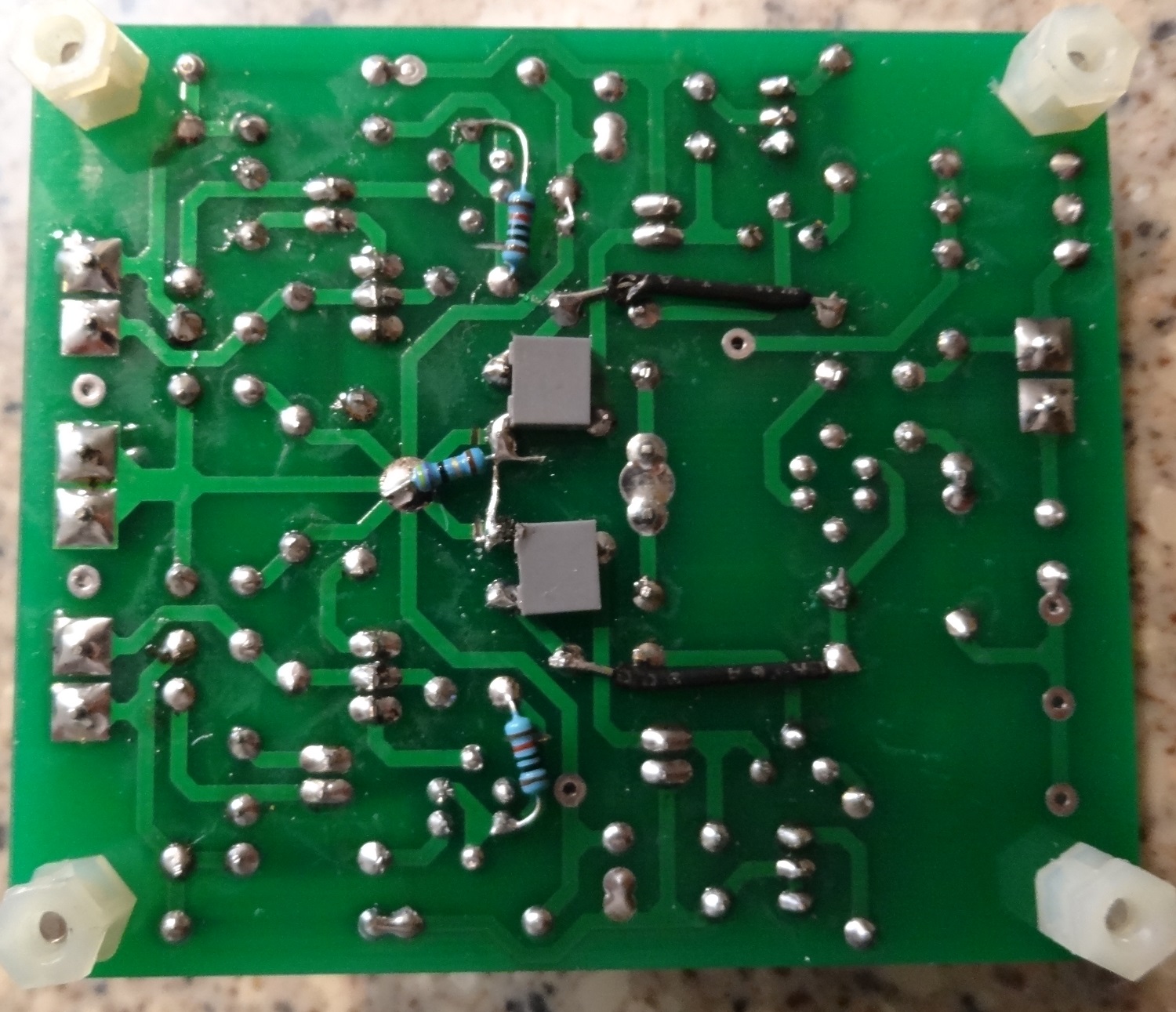

I wanted to wait until the mods were proved before I posted pictures of boards. Now that I have it working here are pics of the top and bottom. The little input cap is just for testing. I have better caps coming.
Blessings, Terry

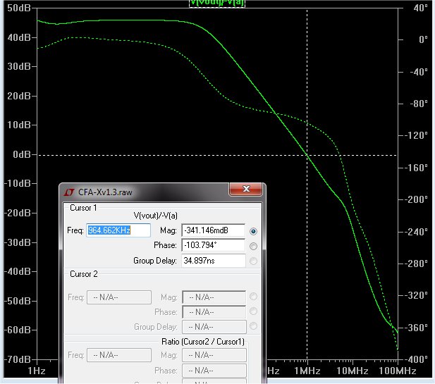

Edit - 2.7K /68R /33pF = 1.2mhz UG , 78 degree PM , 27db gain ...

How about 2K7/47R/33p? That is what I have in there right now.
Just a little lower UG (1mhz) - same margin. (below)
<30db gain, 964khz UG , 77 PM. (nice and stable)
Edit - at this config .... >200 V/us slew (plenty).

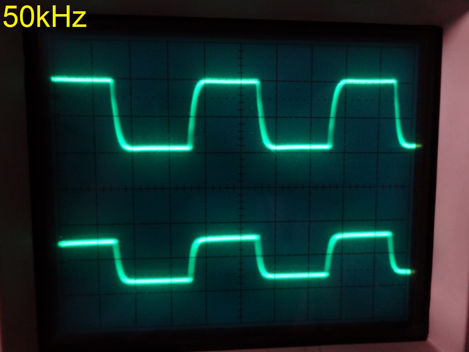

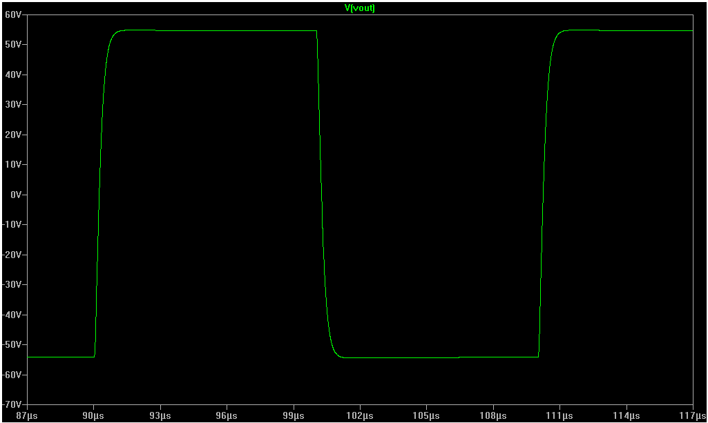

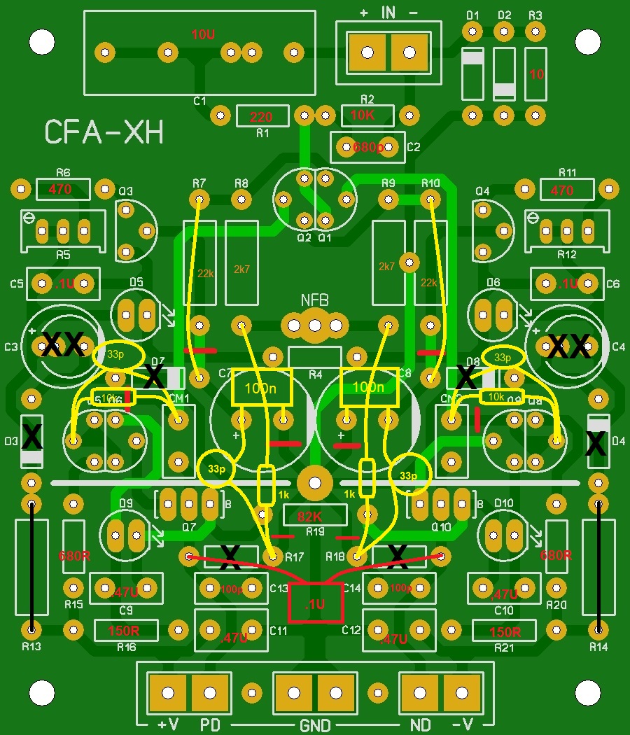

Hi BV,
It's weird because the generator by itself show very good square waves all the way to 150kHz. I have to believe that the wave shape shown at the input is coming from the input on the amp. No matter really, it is good enough for what I do.

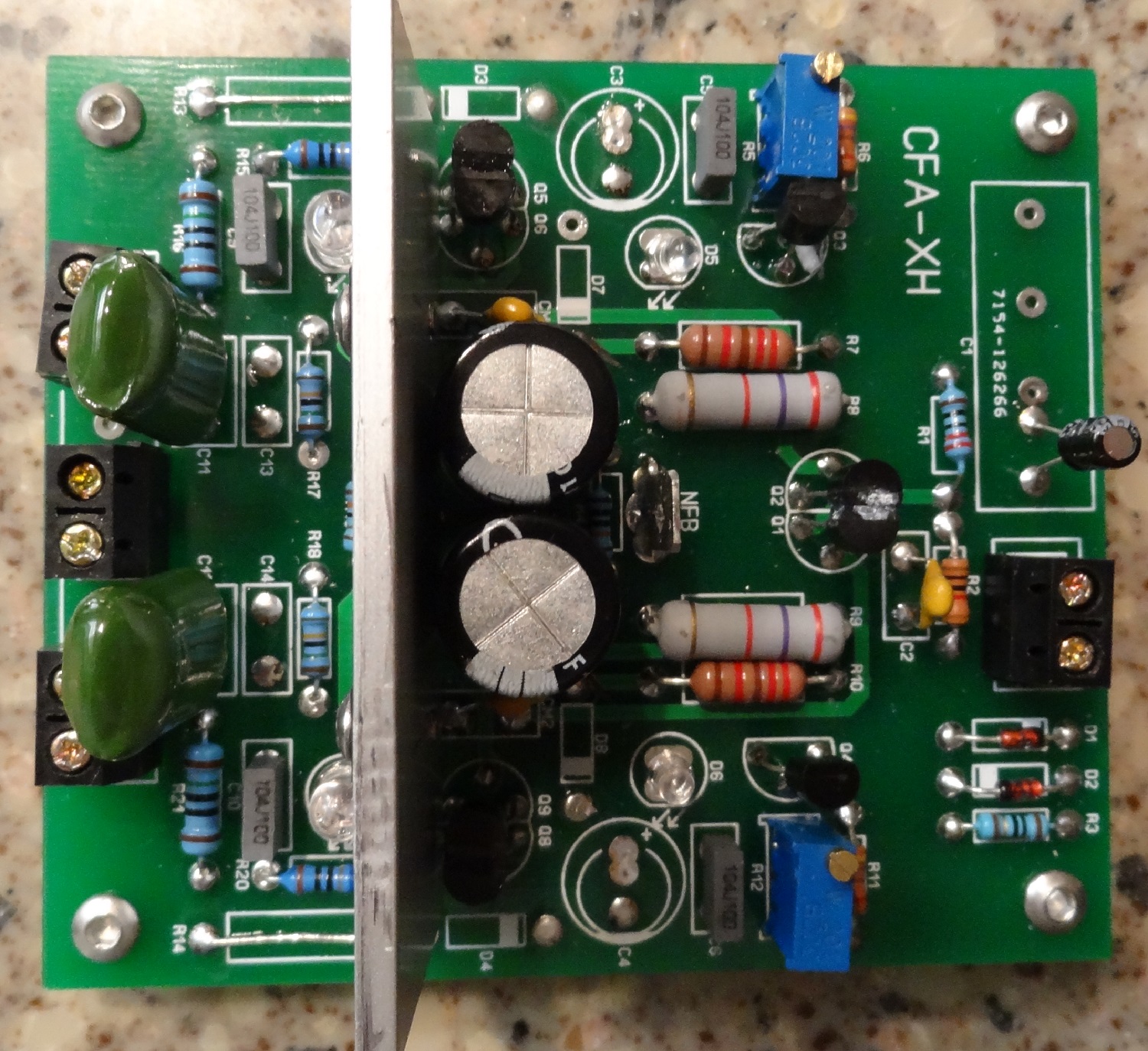

I have made a drawing of the modifications needed to make the latest circuit that you shared. Look over the board and see if you find something wrong. I may try building it just for fun.

Some trouble
Tried to fire up the CFA-x"h" that OS released long time ago.
OPS is the baby.
However when I connected the combo to my PS both 150r resistors on the ips cascode smoked.
I do not have a proper bench supply to slowly rise the operating voltage so I am not properly able to measure the voltages over these resistors.
Could someone give me a hint where to start the troubleshooting?

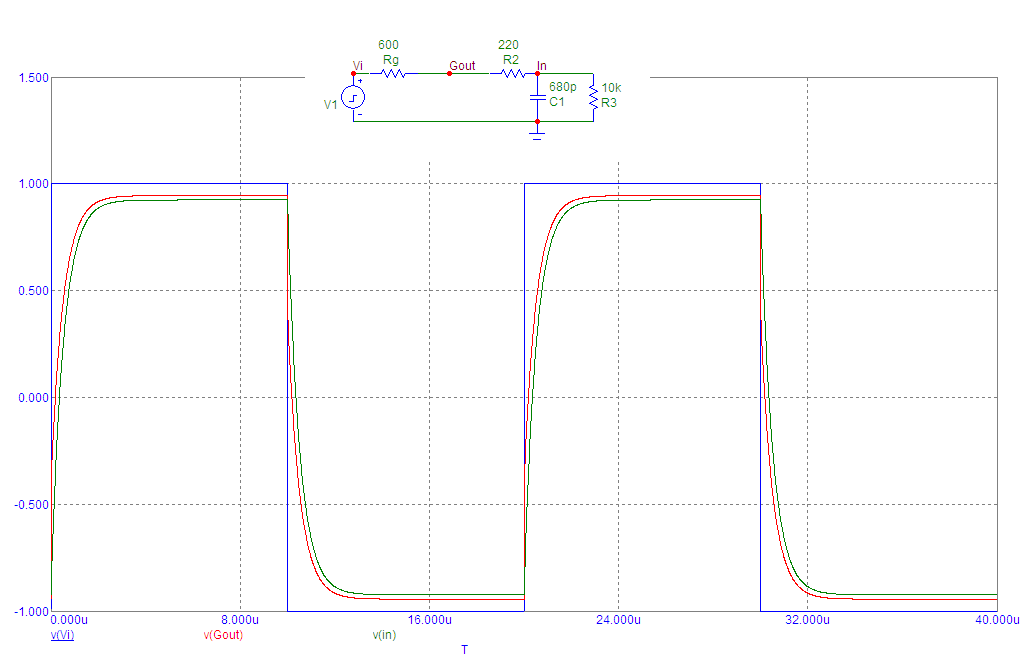

Nothing is weird , Terry. Look at attached picture, Rg is generator internal impedance, I suppose it is 600ohm. Omit C1, and You got ideal square wave signal.Hi BV,
If You will make new PCB, make ground traces as wide as possible, or as poured copper ground plane.
