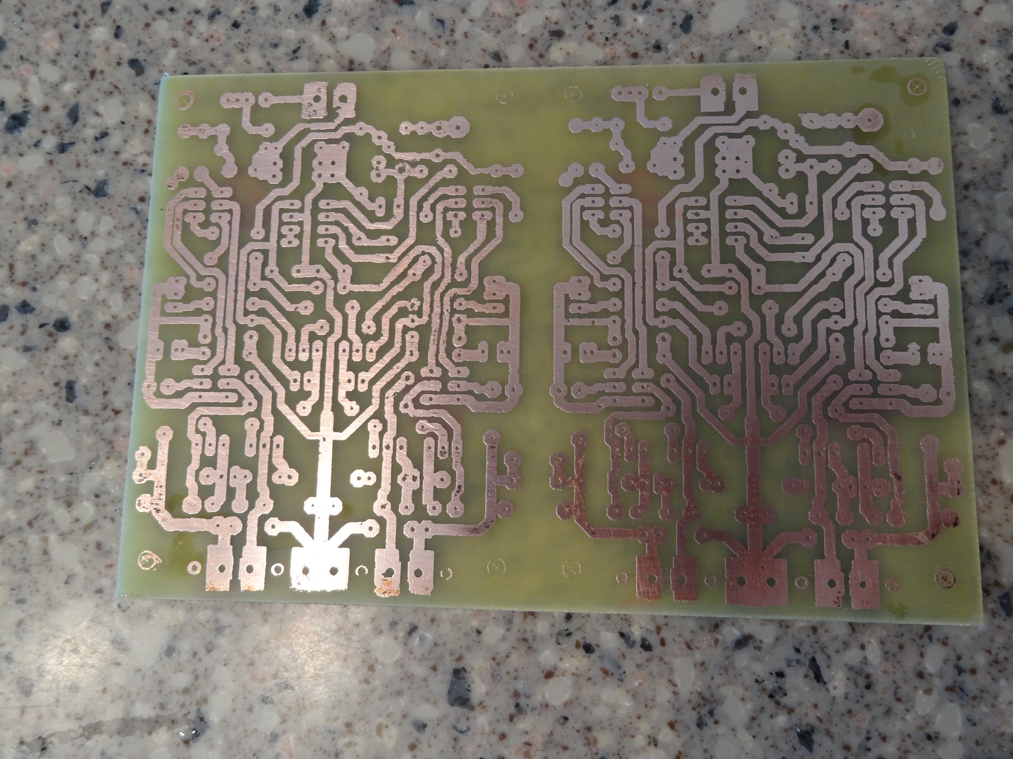

Yes I read that when you posted it. I got very interested. I even made a UV LED panel. Problem is those Photo sensitive boards are very expensive. I already had several one sided copper clad boards so the toner transfer must makes more sense for me at this time.
The only reason I etched the Wolverine and Spooky today is that Jason is planning other IPS first for gerbers so this will give me something to work on while I wait. I probably should have waited on the Spooky. I think OS is planning an upgrade on it.
I didn't quite finish the Worverine today. I didn't quite have all the parts I needed in my parts bin so I had to place an order. I should be able to at least one board for each IPS next week.

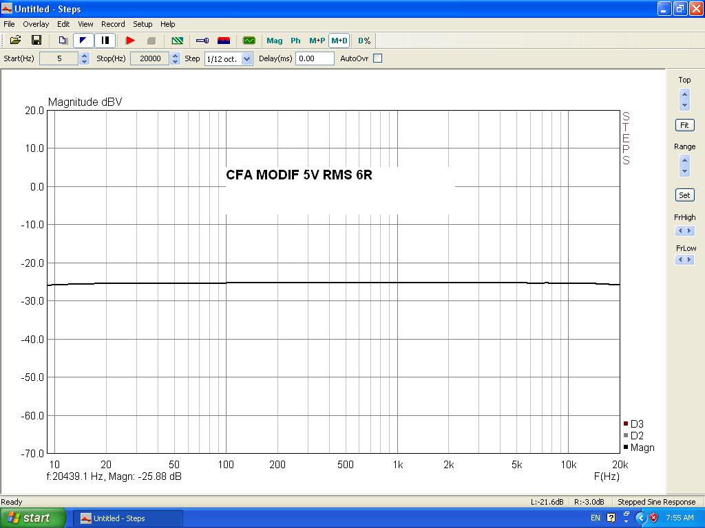

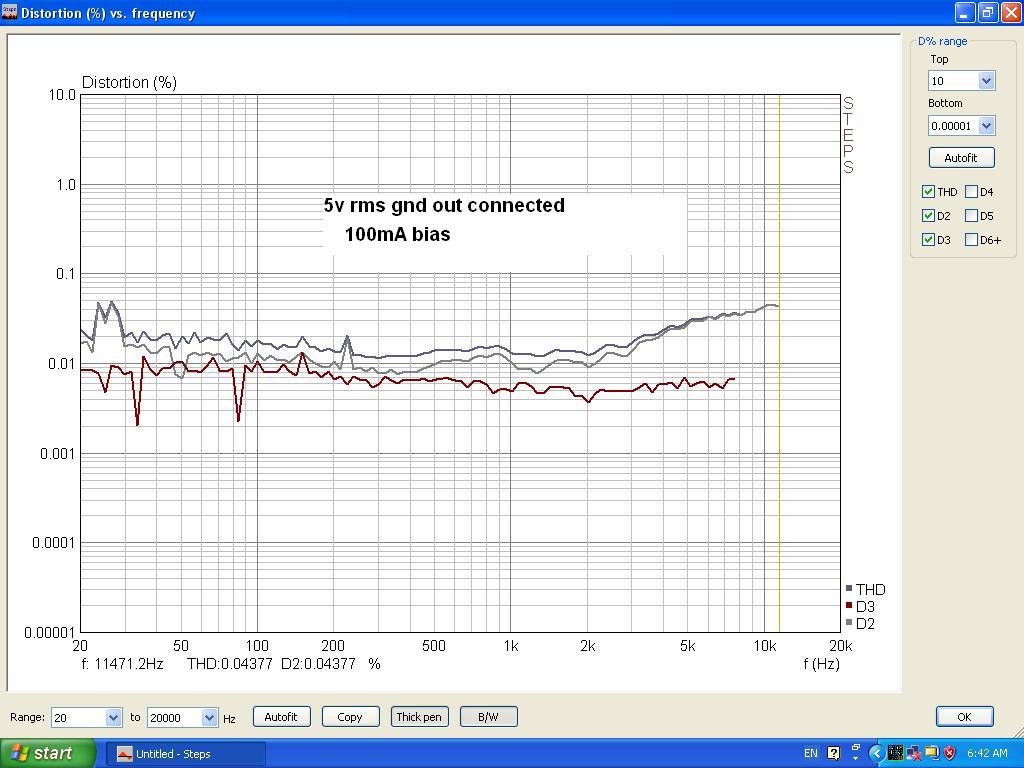

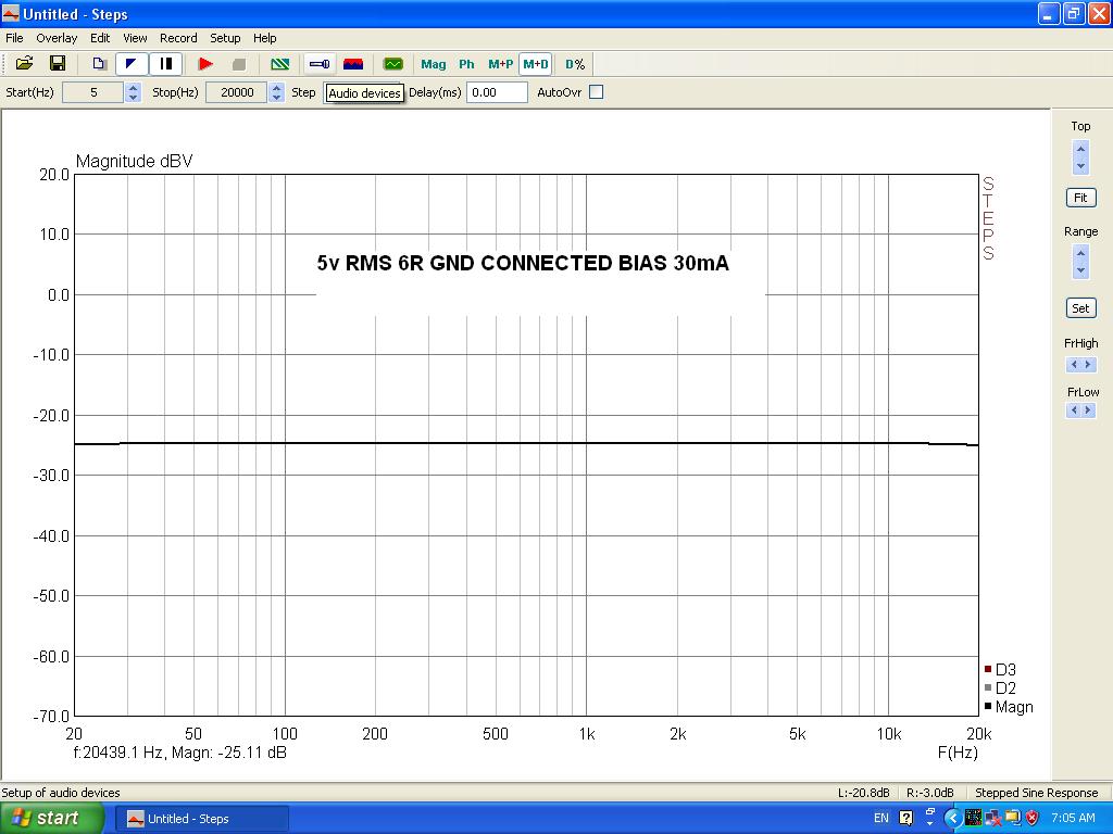

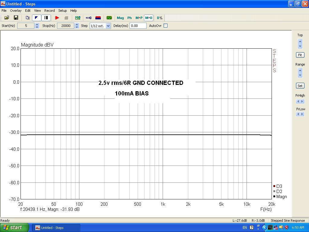

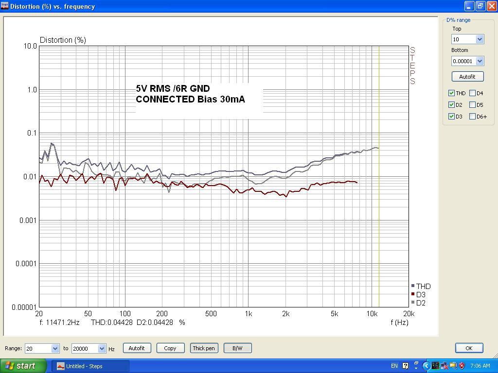

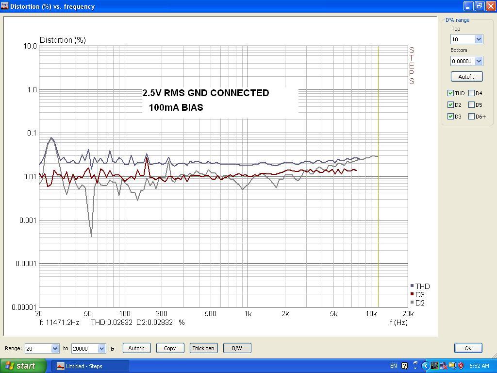

measurments again
some new measurments.
All these from "Spooky"

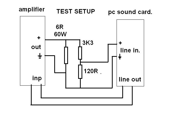

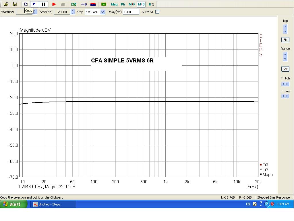

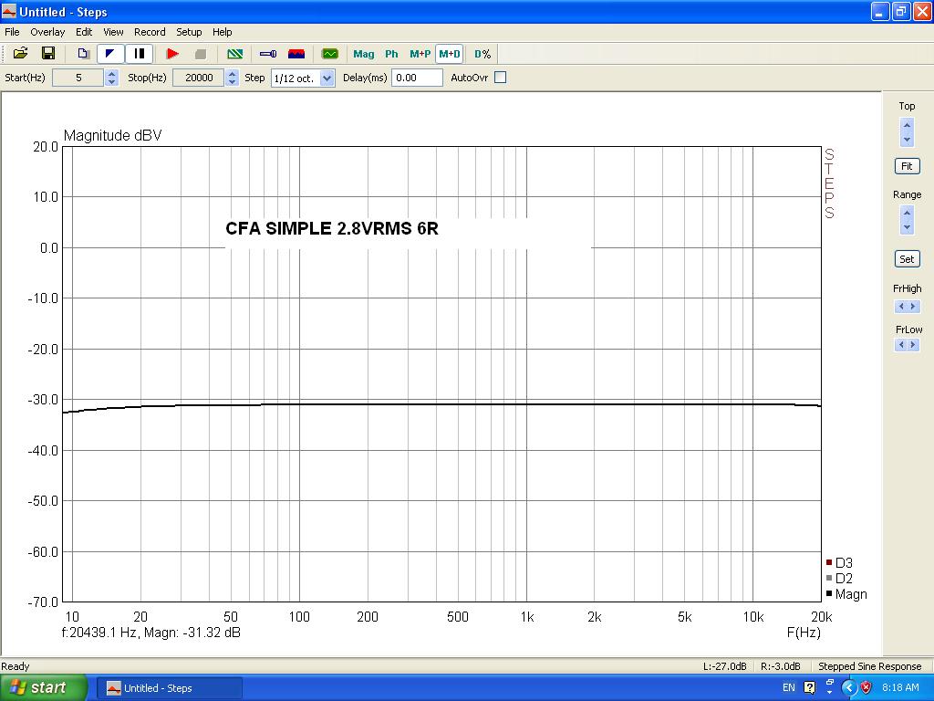

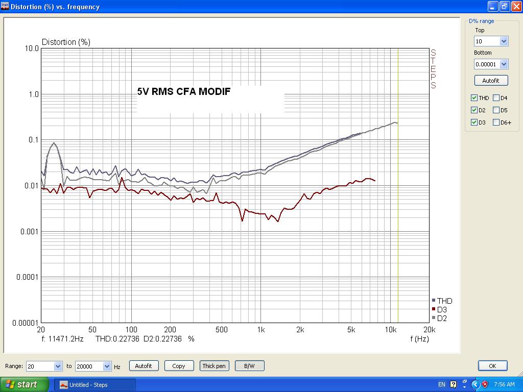

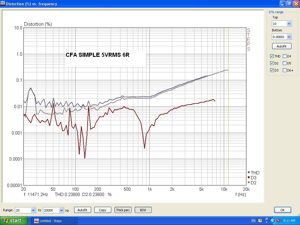

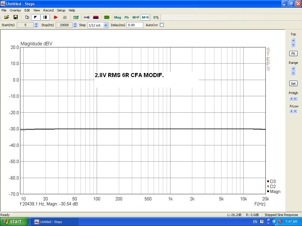

measurments again
ALL THESE FROM SIMPLE CFA
Same test setup
Same test setup

I should have been paying closer attention. I thought the Spooky was further down on your list. I may wait and not populate the Spooky boards. I forgot how hard that was without screen print. I'm missing a few of the components anyway. Also I have been searching back through the thread and there is a lot of info on the Spooky. I see an option 2 and some of the schematics don't match up to well with the foil pattern I etched. Probably better to just wait. the only reason I etched those was because I already had the etching tank set up and I had extra boards so I just kind of picked one to try. I'm not sure if the foil pattern matches the latest layout. I think the last layout that OS posted was in a sprint file that I can't seem to open.
I have another question. In both Wolverine and the Spooky OS uses the KSA1015/C1815. Will KSA992/C1845 work just as well there?

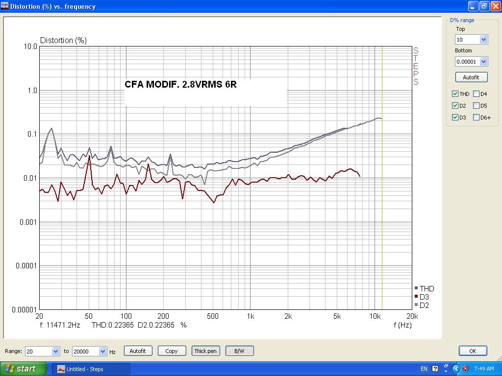

I am very surprised by the rapidly rising distortion numbers on the CFA-XH vs the Spooky. Perhaps someone can explain why that would be so, I though the CFA was supposed to be better on top and the VFA on the bottom of the frequency ranges? Is there a reason that the readings do not go past about 10Khz or is that just because you are using a sound card for the measurements?
Yes ,the only reason is that my sound card stops there by default(unfortunately)....Jason,

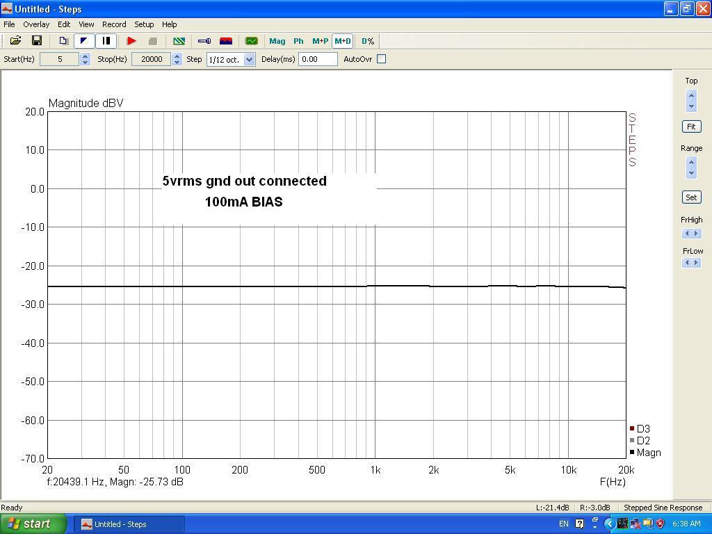

Measurements i posted in previous posts are with a different setupthimios
Measurements you posted today differ more than one order from measurmenets you posted in #3016 . It seems to be something wrong?

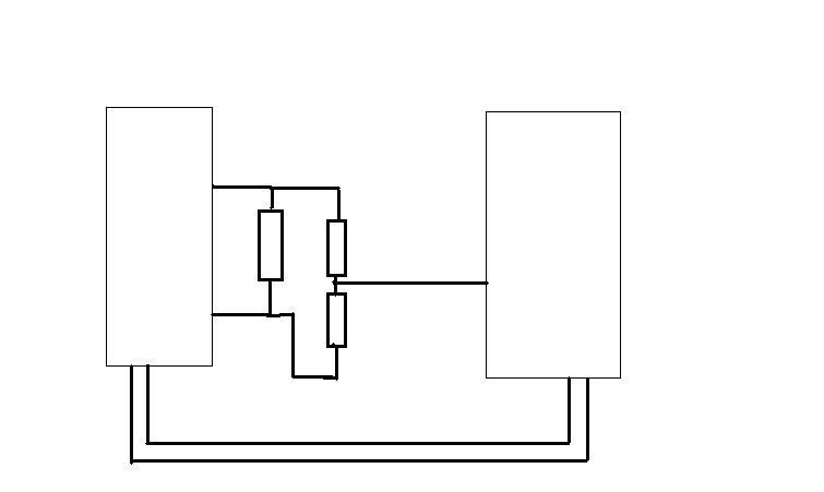

The difference is that now i do a connection out gnd to line in
First setup
Next set up
What is the correct method doing this?

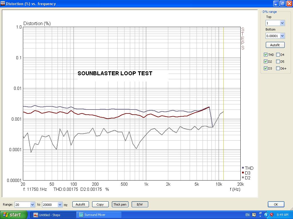

loop test always doneSo you have serious problem with ground currents contamination. Try to do loopback measurement of card only, and then connect ground (shielding)only of this looback cable to ground of amp (switched on). Those measurements are very unreliable.
and make again loopback measurement, compare this with "clear" loopback. Results should remain unchanged, it should be the same picture as above. According your pictures, connecting input cable shield (so creating ground loop) worsen results more than one order of magnitude, for the same amp. Try to measure spectra e.g for 1kHz for both setup.and then connect ground (shielding)only of this looback cable to ground of amp
