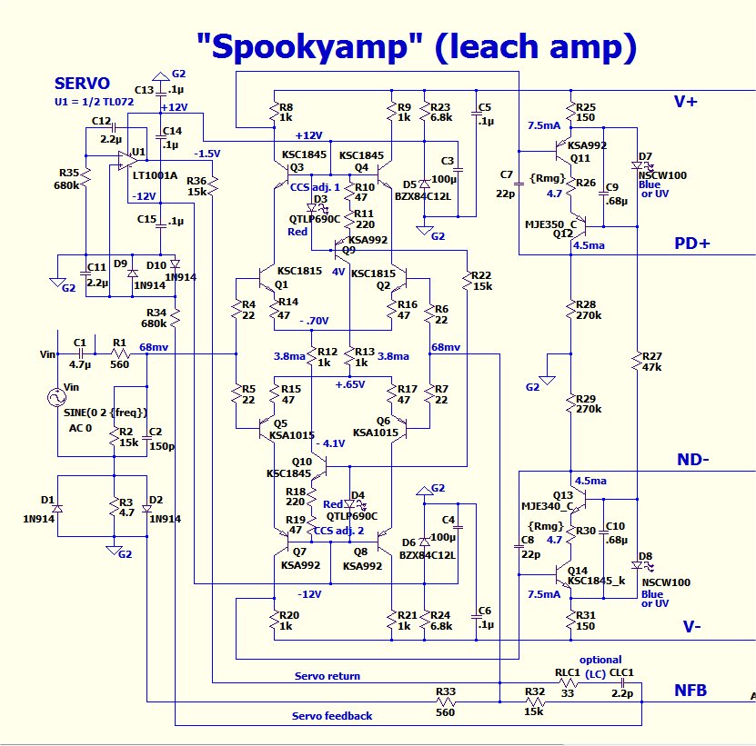

Terry have you tried to adjust trimmers in opposite rotation each other for offset adjustment?
Hi Thimios,
I can adjust to zero offset but by the time it gets there the one side running way hotter than the other. Something is wrong somewhere. It reminds me of a peeceebee that I built. The offset would change drastically as the vas would heat up. I matched all of the transistors except the VAS so I guess it's time to replace those. I'll replace them in the morning and see how it goes.
Terry,
the only what can cause voltage across R2, is flowing current . And the only source of this current can by base current Q1,Q2. If Q1,Q2 are beta (the same as h21) matched, base currents should compensate, and the only current flowing through R2 is current difference between base currents Q1,Q2. If voltage across R2 is about 0,5V, Q1,Q2 bases current difference must be about 50uA, and this is way too much, normaly it should be "something" lower than 1-2uA. If this current (and so voltage, too) is after switch only slowly increasing, here is something faulty( e.g transistor with too low Uce, ouside specs, or faulty). Disconnect signal source and short input pins, and try to measure DC. If it will be still here, than short R2 (base Q1,Q2 direct to signal ground) and measure again. Try to change input transistors for new ones.

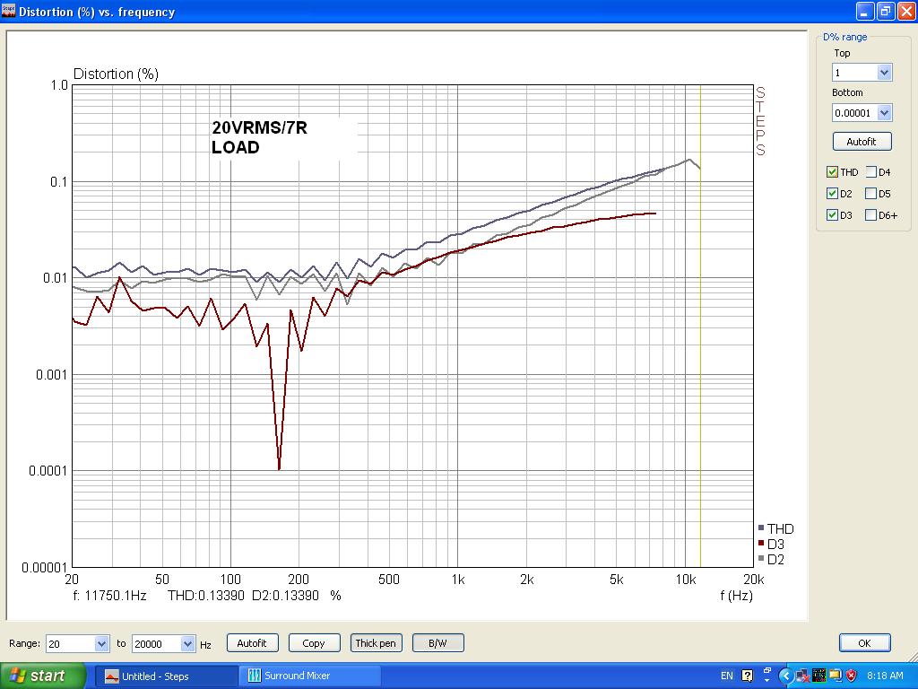

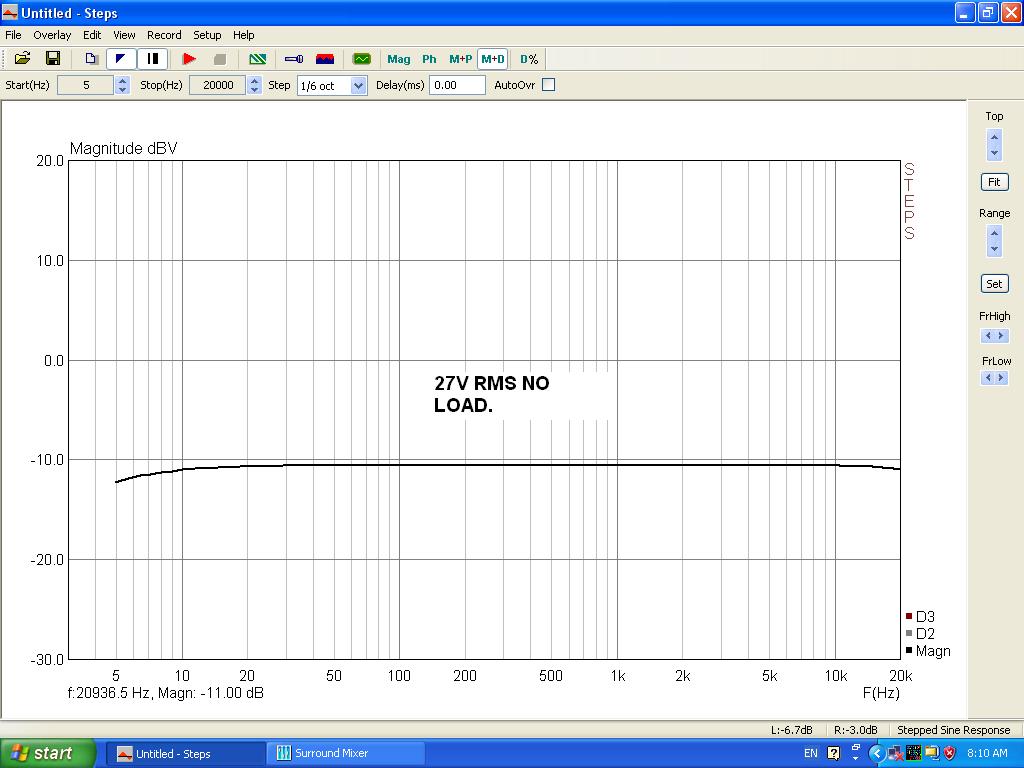

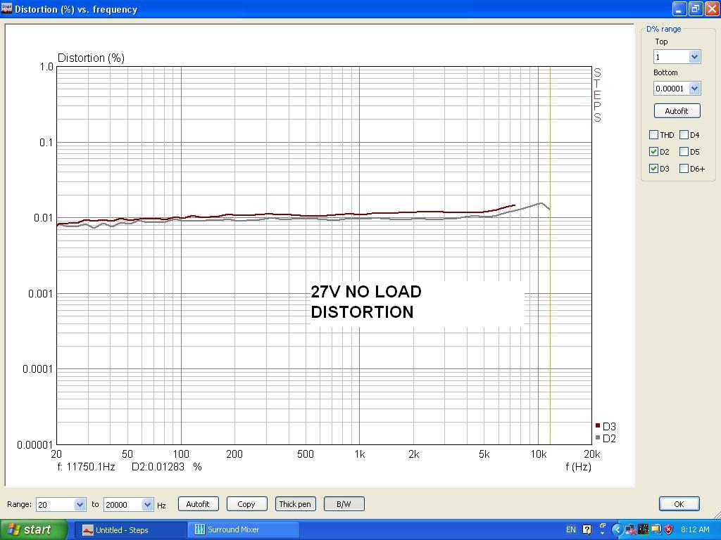

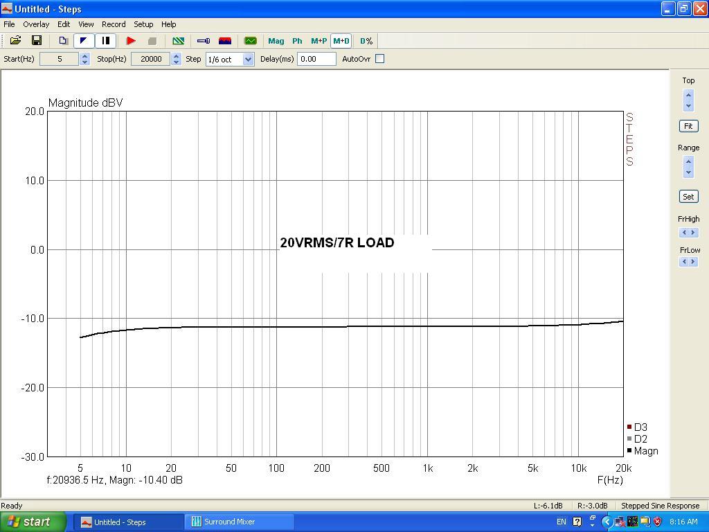

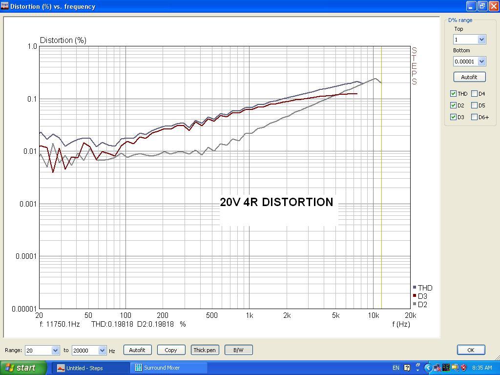

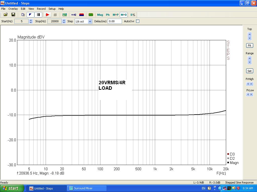

spooky more datails measurments
Spooky measurements.
Matt and Gareth Ingram, look here.
Any other opinion is useful,

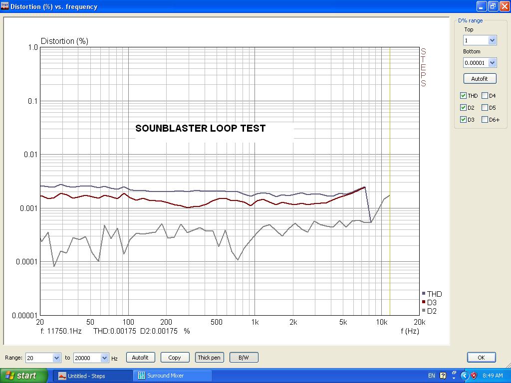

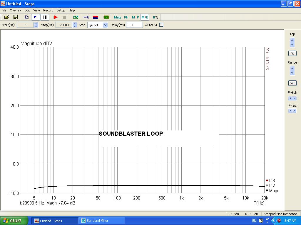

From the graphs, where there's a load connected, you've definitely got what could be severe induction based distortion going on. Now this could be inside the amplifier itself, or it could be because currents are flowing where you don't want them to. You've got the classic distortion gets worse with rising frequency and it gets worse as the current increases.
It might be informative to see a distortion sweep at a low output level, one where the amplifier should still be within class A, say 1 watt into an 8 ohm load. Class A is magic in that it eliminates certain distortion causing mechanisms and can help in isolating where a problem might be.
The most troubling part is the high distortion without any load connected. Usually you see problems of implementation and measurement set up when the load is connected, this is because it makes large currents flow and perhaps flow where you don't want them to. Without the load connected this tends not to happen and everything can appear great.
If you run the distortion sweep at 1 watt with the amp biased into class A it would be interesting to see what the performance is like both with the 8 ohm load connected and with it disconnected.
Some issues within amplifiers, that appear without the load connected, are voltage dependent only. That is resistors/capacitors in the feedback network, or the resistors used within your resistor divider before the sound card. If you lower the output voltage of the amplifier this will reduce these effects significantly and it should improve the performance.

I am no expert on these things or anywhere near that but couldn't some of the distortion product we are seeing here be caused simply by the test leads or setup? A few inches of parallel lead wires could cause a fairly large inductance current to be picked up and shown in the results. Can we see how the test was set up and under what the conditions are? I have seen this talked about in so many other threads that it was a simple test setup problem or a temporary wiring situation causing a false test result.

I think, in posted measurments it is mostly caused by excessive resistive and capacitive loading of VAS. It is very crude "compensation". Where is actual schematic of "spooky"?
Yeah, I was searching for the Spooky foil pattern and couldn't find it. There must be one because Thimios built it. Hopefully he will see this and chime in.

The Spooky Amp schematic:

Thank you Pavel. Would the ground loops be between the amplifier under test and the sound card and not necessarily from the amplifier circuit itself?
Spooky is on the post #803I think, in posted measurments it is mostly caused by excessive resistive and capacitive loading of VAS. It is very crude "compensation". Where is actual schematic of "spooky"?

The trouble with measuring distortion is that experimental errors tend to be all +ve, you can't average them out, and you have to work hard to minimize the THD as much as you can - I never had the chance to do this as I don't have the equipment. I would probably look to have a 'control' sample, a simple circuit that I could use to establish the baseline of my test set up that was closer to the wiring set-up of the amplifier than a simple loop.

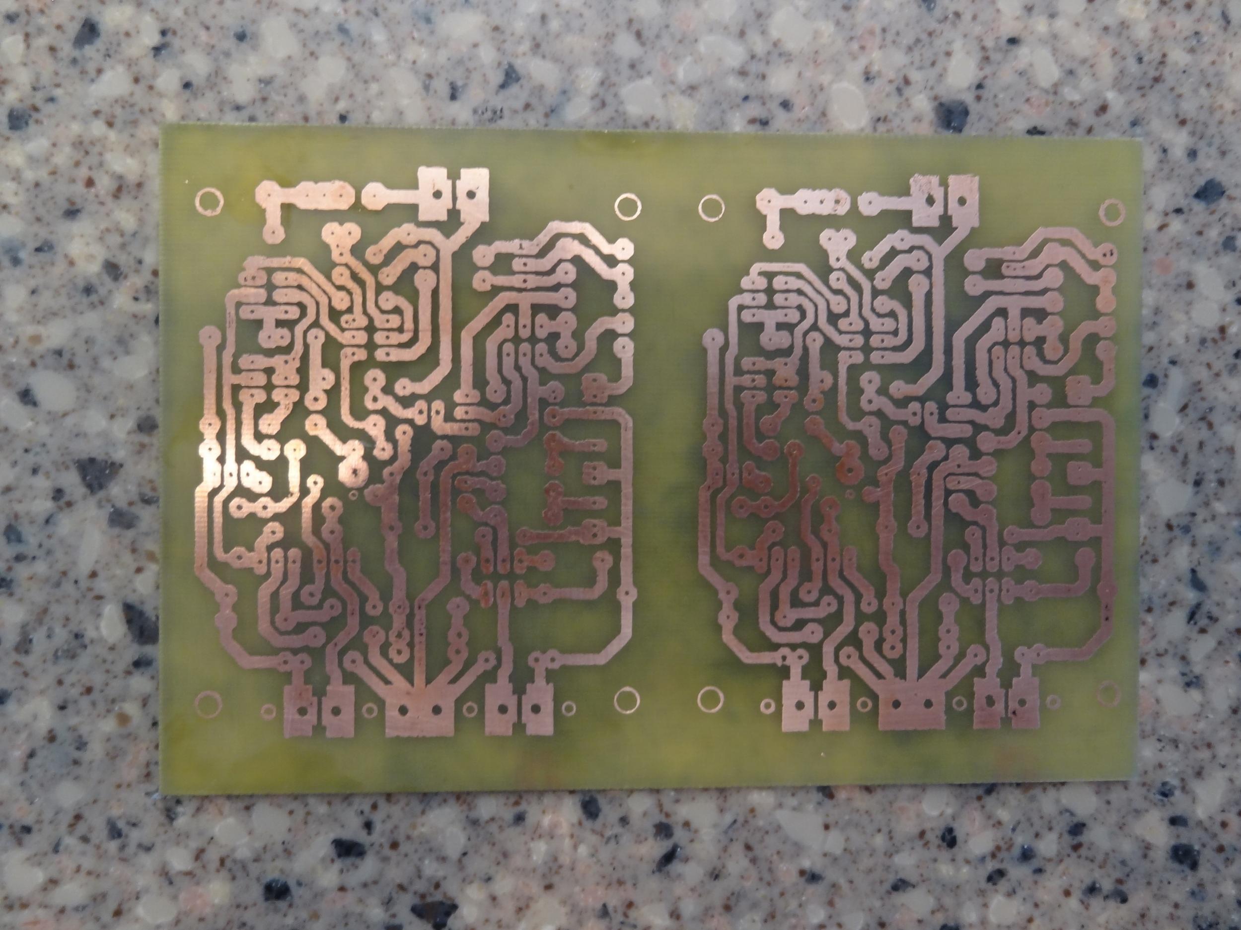

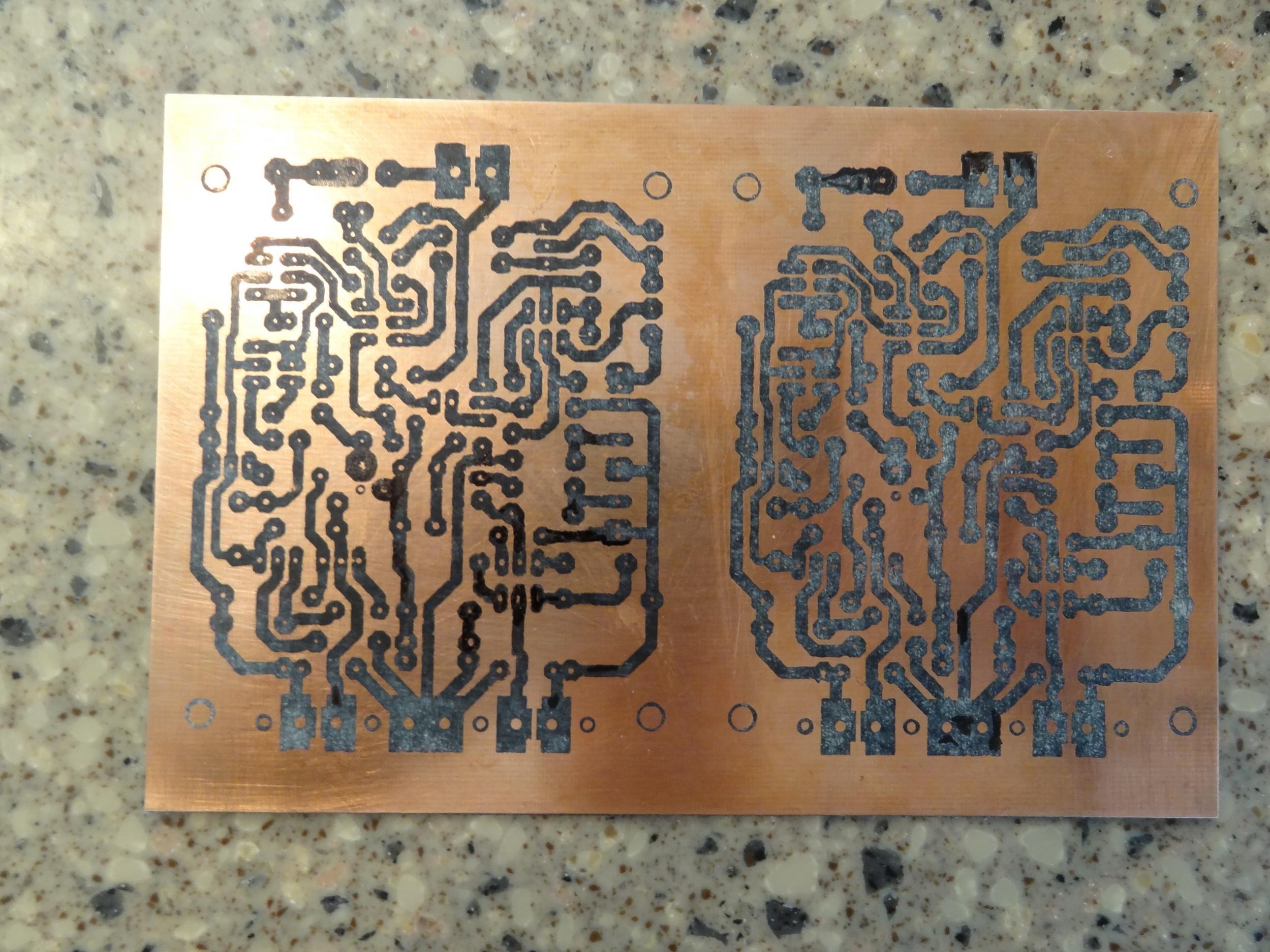

nice Terry that looks really nice that etched board 😀Juan
Agree!
But drilling all them holes is a pain - worth to have plenty of drills on hand as they blunt easily and this results in rough edges on the metal.
