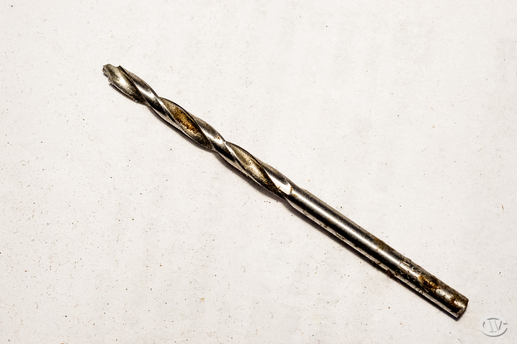

I have some special drill for metal, looking a little like the ones for the wood, with a a central spike that work pretty well in Aluminium.
But it is true that this metal use to prefer the holes elsewhere than you.
I've never seen a special drill bit for aluminum but you're describing sounds like it would work. Aluminium needs to a very sharp cutter with higher relief angles much like wood cutters. I've never tried it but a good quality brad point wood bit with enough coolant might work.
They are like this (And they work very well on the plates too.):

Those drills are called pilot drills. The smaller diameter is the pilot and starts the hole. If you use a center punch or transfer punch before you try and drill a hole it won't normally have any problem staying on center with a simple drill press. If you have your heat sinks before you build the amplifier section you can clamp the board to the sink and use a transfer punch to accurately mark the centers of the holes you will drill and they will line up perfectly every time. It sounds like the taps sent to OS are high relief 2 or 3 flute taps made for soft materials such as aluminum. Just stay away from 4 flute taps as they have a tendency to break in aluminum with not enough clearance for the chips you make with the tap.
