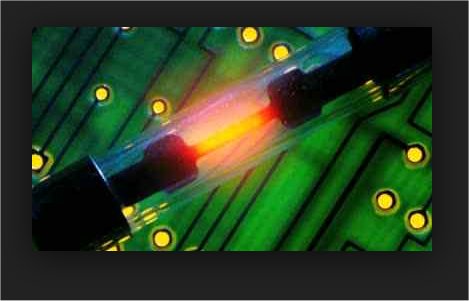

I actually watched fuse distortion on my test rig last week. I had a couple 1 amp rail fuses installed. It looked like clipping on the positive rail only with a sine wave going. The fuse was just starting to go liquid at the peak, then solidifying again on the negative swing. Cool to see!
High Z - liquidification / low Z = solidification ....wild !!

What was the frequency, for you where able to see-it, <10Hz ?Cool to see!
I was seeing it at a bunch of frequencies and input voltages. It took a bit to figure out what was going on. I thought I had damaged an input transistor at first. Then I remembered what I'd put in for fuses. The positive fuse was discoloured and the filiment was sagging.

Fuses glow ... sometimes they can glow for a few seconds before failure.
seen it.

I'll have to see if I can duplicate the fuse distortion with the office lights off and see if I can get the fuse to glow.
My question was about "The fuse was just starting to go liquid at the peak, then solidifying again on the negative swing. Cool to see!" with the inertia of the thermal effects and the 50 (or 60Hz ) remanence of the eyes."nothing but a DOUBTER " (polar express film) .

Of course i have seen many fuses in different states, including very hot or blowing in front of my eyes. But i was never able to follow their instant changes following a constant sinusoidal signal, reason of my question.

I should have been recording the waveforms. I was surprised the fuse didn't fail at lower frequency or higher amplitude. It would be neat to record the actual fuse on video so it could be played back at low speed and viewed physically. Maybe I'll try it some day when I'm bored.
