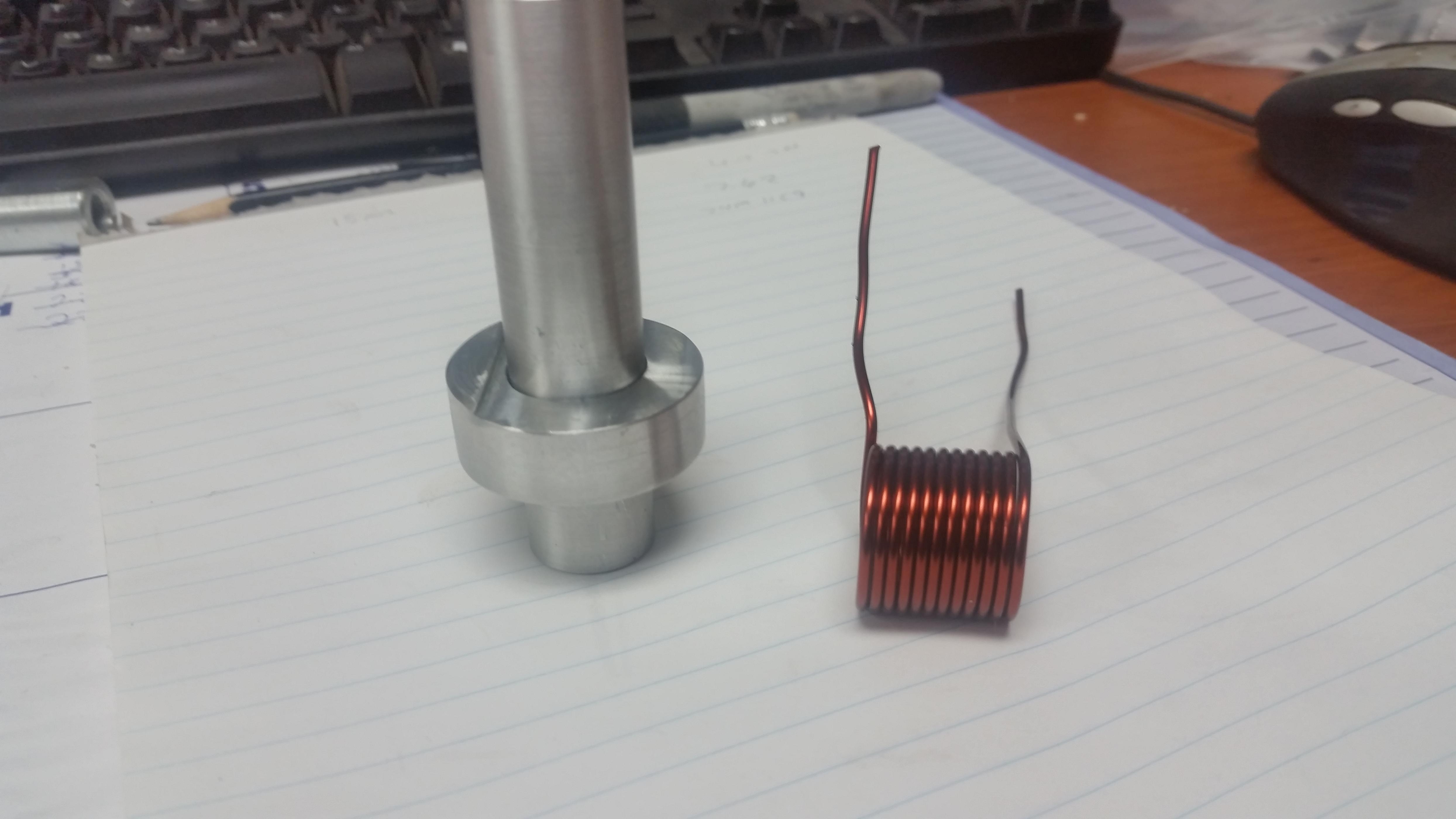

For what its worth, I just use an AA or AAA battery as a coil form and use 14ga magnet wire (that was a mistake, I meant to get 16ga and the rolls were mixed up at the local junk monger's store). With 14ga I think I get 13 turns. For the ideal number of turns 16ga is good, though 14ga does fit the holes.
I have a 10mm shaft that I chuck in my cordless drill. I poke one end of the coil wire in between the collet tines and just run the drill slowly while guiding the wire. I usually make a coil about 6-8" long and them cut what I need from that. I leave the remainder in a drawer for future use.
That sounds like an easy way to do it!I have a 10mm shaft that I chuck in my cordless drill. I poke one end of the coil wire in between the collet tines and just run the drill slowly while guiding the wire. I usually make a coil about 6-8" long and them cut what I need from that. I leave the remainder in a drawer for future use.
Yes, I found I had to run the drill in reverse for Valery's board. I just figured it was a Russian thing.I use a "special" felt pen of the right diameter for that purpose
Sometimes I wind in a wrong direction, so that the coil doesn't fit my PCB, then I wind the other one in an opposite direction. Trial and error method![]()
Yes, I found I had to run the drill in reverse for Valery's board. I just figured it was a Russian thing.![]()
