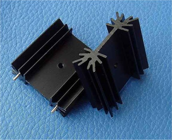

I'm not really coming up with a vertical supply board design that I like. The heat from the TO220s is an issue. I'm thinking maybe mount them under the board on the mounting plate.
That's actually the best option - the "infinite heatsink".
Consider the device ...
a typical 30-40A device http://www.mouser.com/ds/2/196/IDP30E60_2_5-79626.pdf (infineon 30A) will be rated to 175C .
Besides being able to run much hotter than an output tranny , dissipation is mostly
just conduction and switching loss.
I have a Tabbed 10A bridge on my "tester PS" mounted on a 25 X 75mm strip of
AL. I have never felt it more than warm running a 100W load with a connected
amp.
(Below) is what I've seen even on 20A industrial power supplies costing 1K$ or
more. These also are common on ebay/DIY modules.
If the builder was at the >20A or greater level , the external full bridge option
would be used.
