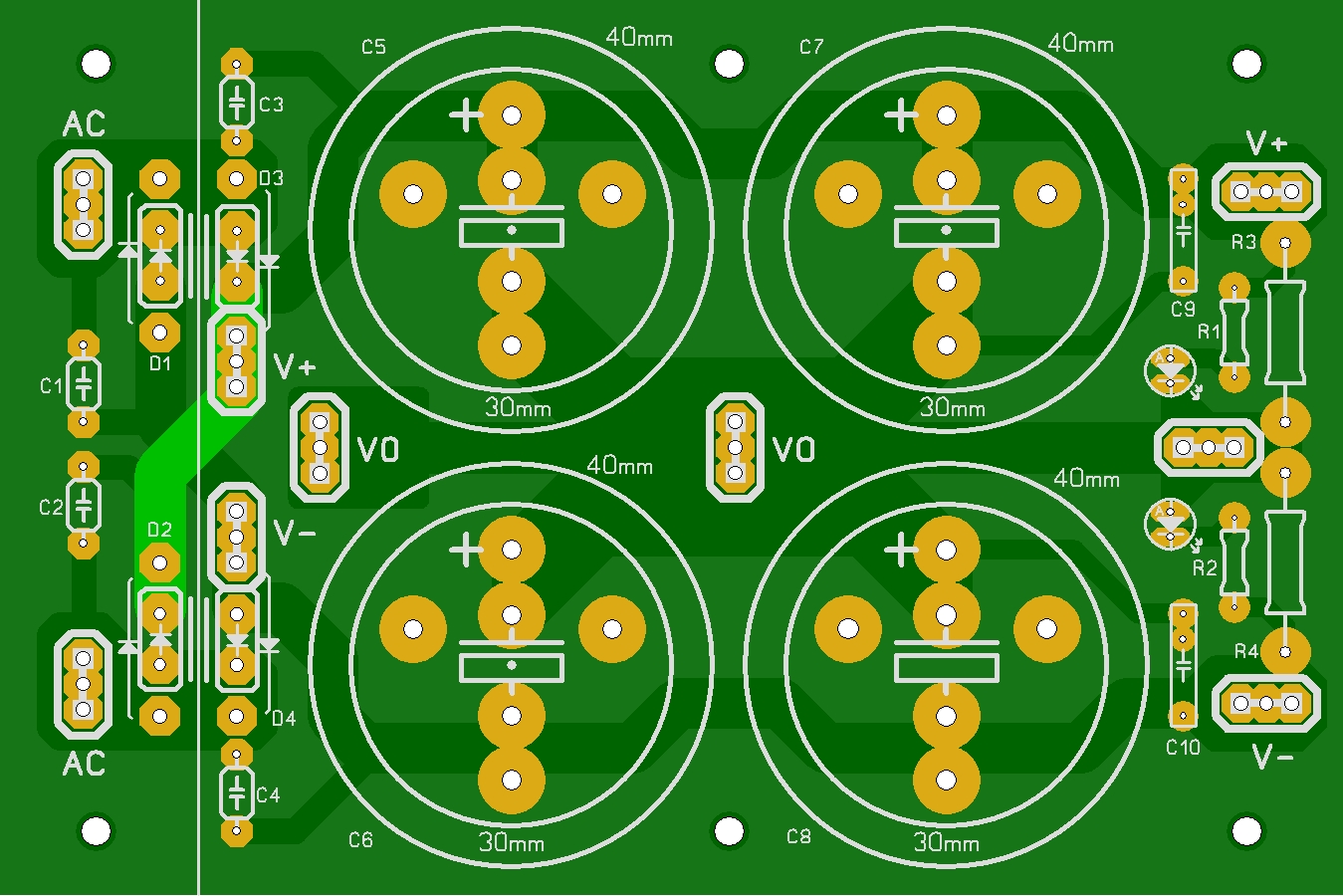

Your right on that .... actually have 2 groups of 4 caps (below) -
NEED POWER
Many big bridges and large rectifiers - Albany NY prime E-waste.
To "fry up" some new amps - A "uni-cap" PCB (below 2).
-Takes DO-xx /TO-220 / or external bridge and can be snubbered.
- 10mm/2-pin and 22.5mm /4-pin pitch ... 25mm-42mm caps.
-starred / led / and bleeder capable.
- Up to 40Kuf with the 40mm units (slew-monster ready) !
UNI-CAP .lays and a bitmap for toner below in zip
PS - the "35mm snap-in .lay" is for jeff. Infidel will be working on mine first.

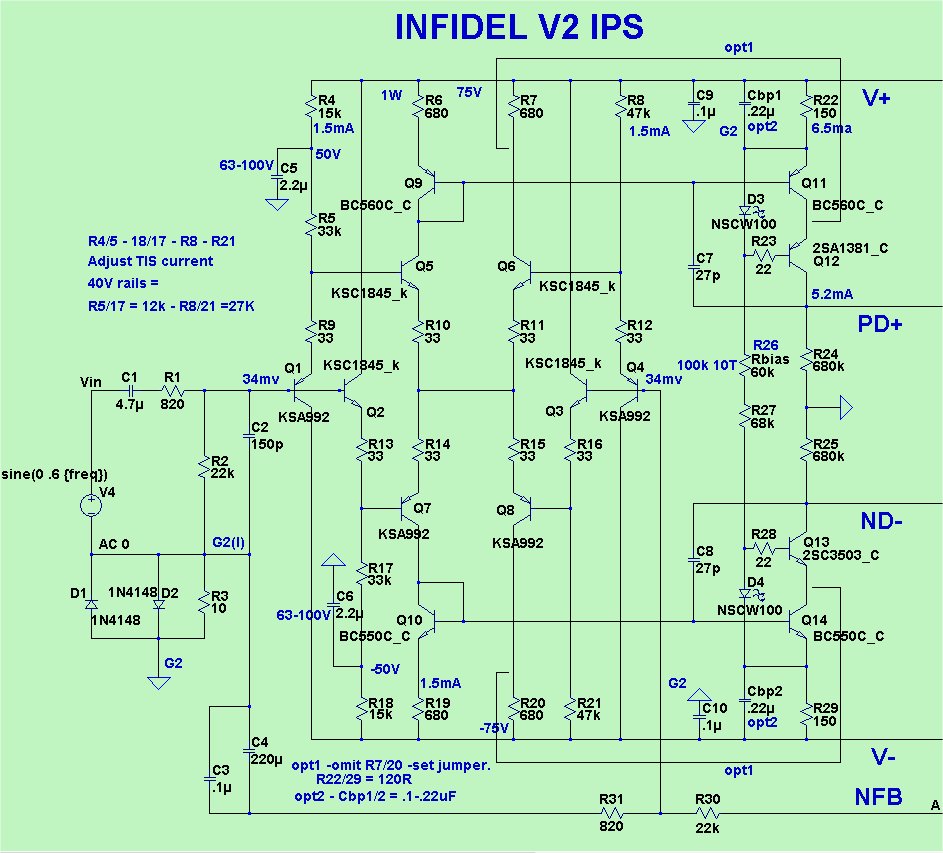

On the Kypton-C input, I'm testing in 42 volt rails with 3.9K resistors in R18 and R19. I'm only getting 11.8 volts at the input side of R18 and R19. I'm trying to adjust the pot but the voltage never quite settles and is a little high. Do I need lower resistance values for R18 and R 19?
35-42V rails = 1.8K-2.2K , On the "C" you are not only running the first stage CCS - but the servo , as well.
On some amps (cfa-x) just the CCS is using the regulated supply. 3.9K is good here for lower rail voltages.
I simulated , it took 1.8K (14ma) to get a rock solid 12.25V on the zeners @ 40v rails. 2.2K gave 12.1V /11ma.
This is what most of my IPS's normally do at 60-75V rails (3.9-4.7K).
Edit - I plan on jury rigging 2 more 4.7K's on to my spooks zener circuit to get my 12ma+ , for
"bench testing". PS - the pot will not affect zener voltage , just trim the red led bias of the second stage. (VAS I)

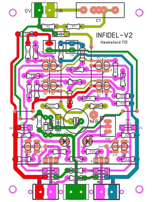

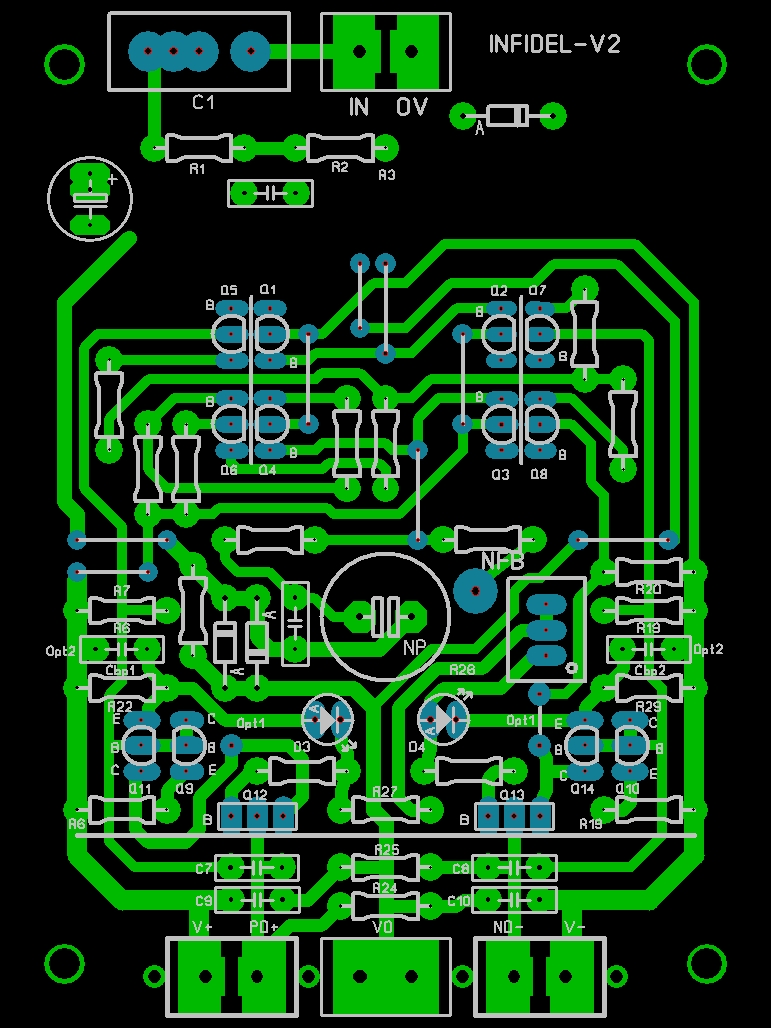

It is not just changing the parts !! By having the diamonds face to face AND being
separate from the other "{face to face) "bridge" pairs , even if you made the
electrical changes the physical issues would still exist.
The tiniest temp. difference between the coupled diamond pair and the coupled bridge pair would be magnified on your board ....
even if you made the electrical changes.
In the new layout , ONE HALF of each diamond with its "bridge partner" is paired.
Opposite thermal effect of the last layout.
This IPS is very different than the others.

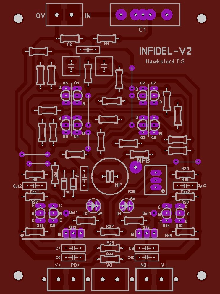

Infidel-V2
Here it it ....
-Schema with 40V and 70+ V notes (below 1).
- Layout with verbose voltage guide (below 2).
Physics of the P/N devices says it HAS to be thermally stable.
Package attached.

All 4 pairs just plain "face to face" = great performance.
All 4 pairs with thermal epoxy and a copper/aluminum plate across them all =
"anal / lab" performance.
Simulated individual bridge/diamond pairs (like Q1/5) swept independently ,
less than .05ma ... 0-50C . Global 0-50C (all devices swept) is at the uA level -
thermally. Individual actual beta's of the devices might degrade this ,
but natively it is better than the spooky by a wide margin.

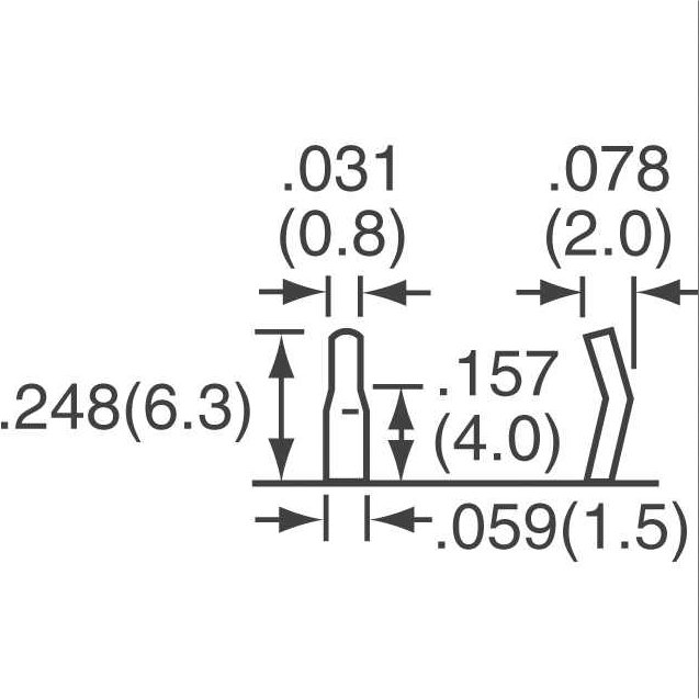

Did you have a 4 pin cap in mind for the uni-cap supply? My pinout is a little different for them. The two stabilizer pins are a little off.Your right on that .... actually have 2 groups of 4 caps (below) -
NEED POWERMany big bridges and large rectifiers - Albany NY prime E-waste.
Time for me to give "the show".
Edit - wife has too many Xmas "chores" for me at times.
OS

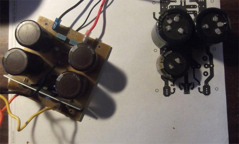

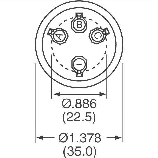

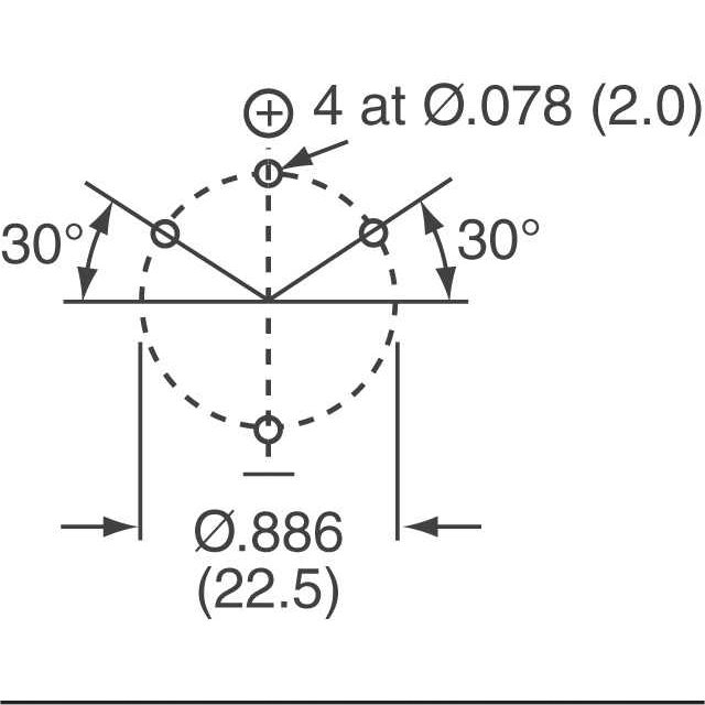

I used my standard sanwha 8200/100v's to "get it close" . I DID NOT use the
30 degree radius spacing for these. I've made several boards with this spacing -
and your right - not EXACT.
Feel free to to get those pins perfect (4 pin). Below are the exact panasonic 4 pin
35-42mm cap spacings - the 3'rd pix is the actual terminal (2mm - got that right).
OS
