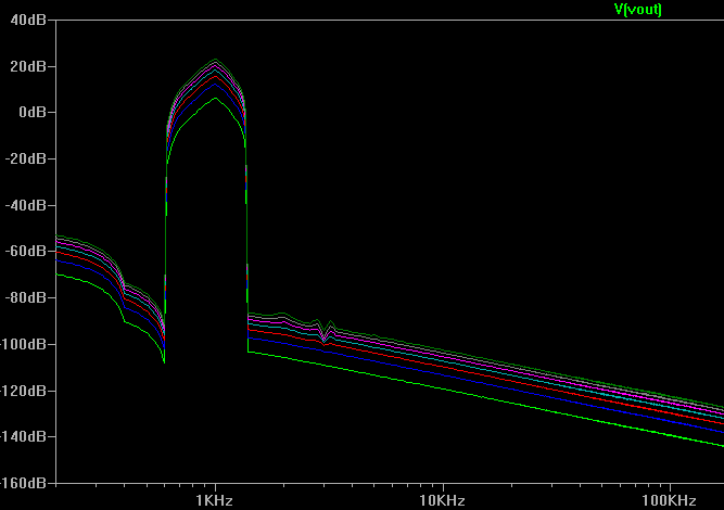

I'm curious what exactly would make Maouna say the Krypton-C sounds more tube like than the CFA-X? Does this mean that the distortion profile has a higher 2nd harmonic distortion product, this is what I normally would expect from a vacuum tube design. So the question becomes does the CFA-X actually have lower harmonic distortion in general or just a very different harmonic distortion ratio of 2nd to higher 3rd and others multiples?
I came across the strange interaction of the super-pair and a CFA stage by accident.
I was going to design a "APEX" like VFA with the baxandall.
I noticed the "current on demand" aspect of a CFA running the Baxandall gave a
MUCH more rounded overload plot - so I kept it.
Kypton-C has dominant second before clip and 2'nd/4'th even during heavy clip.
(much less 3rd/5th/7th)
A "normal" AB amp has 2-7th during overload. C actually simulates differently.
OS

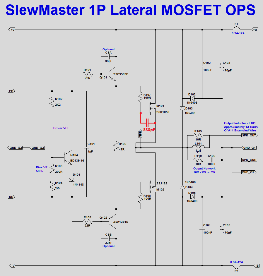

Can you give a link to the schematic of the output stage you used? (EF3 I believe). Does OS have lateral output stage?
BJT Output stage (schematic and layout files) is at posts #500 , 502 , 504
There is a lateral output stage but i dont know if its final ,tested and working.Some interesing comments noted about it :
'' P-channel laterals (2SJ162 in your case ~ 900pF) have got significantly higher input capacitance, than N-channel ones (2SK1058 ~ 600pF), resulting in rather unbalanced OPS at high frequencies.
Try adding a 330pF cap between the gate and the source of 2SK1058 as shown on the picture - this will make the whole thing much more balanced and stable.
Also, slight increased stoppers may help (I would use 470 ohm for R107, R108), however the cap is more important.
Another way to compensate for the different capacitances of the outputs is to use different gate stopper values between the N and P channel devices. Choose the values so the time constant if the same for both.
Let's say the 2SJ162 has a gate stopper of 100Ω and a gate capacitance of 900pF, the RC time constant is just RgatexCgate=RC time constant, so 100x900x10^-12=90nS. If we want 'balance' we need a resistance on the gate of the 2SK1058 that gives the same time constant. So, Rgatex600pF=90nS, solve for Rgate. In this case Rgate needs to be 150Ω.
This could be a valid experiment, remove the capacitor and increase R107 to 150Ω and see if the effect is the same. I'd even suggest since it appears sensitive to set R107 to 470Ω and R108 to 330Ω, same equalization of the time constant, just with higher values overall and see if you can get it to function stably without the added capacitor.
For the VBE, try R104 as 2K4 or even 2K2 if needed and see if you are closer to the sweet spot. ''

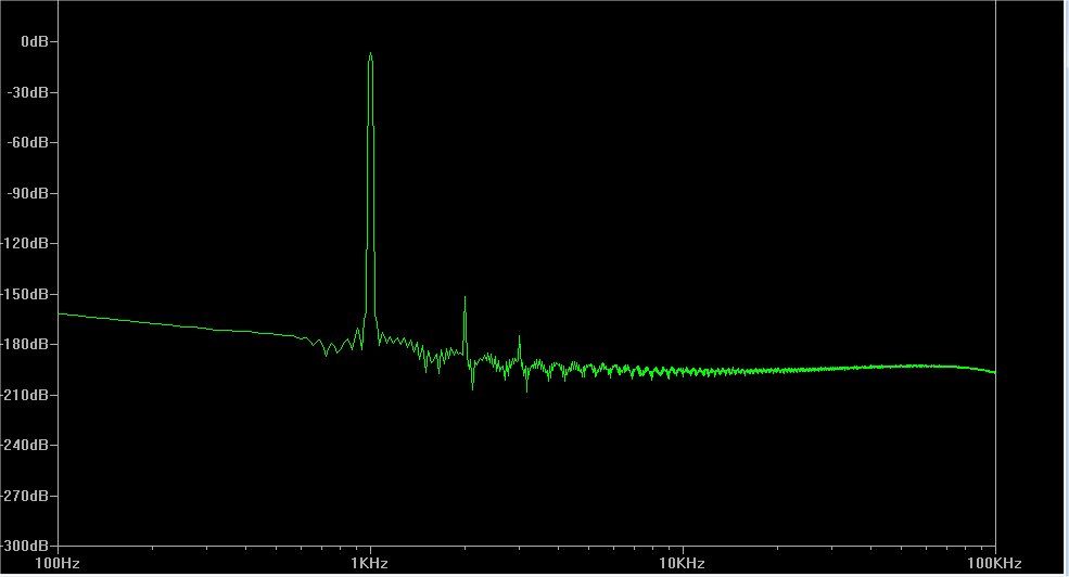

Surprise...!
The attached FFT image could mean nothing to others because it has only subjective/comparative value. But I intentionally present all my simulation FFT in a manner where I can see consistent differences between circuits.
And what did I see in this FFT? Cool... I don't understand this kind of VAS. It's too good to be true, or it hides its "ugly face" somewhere. I will look deeper into it later.
It apparently is not the 2nd harmonic domination like commonly found with tube amps. So, this "tube sound" perception, does it sound "rounded"??

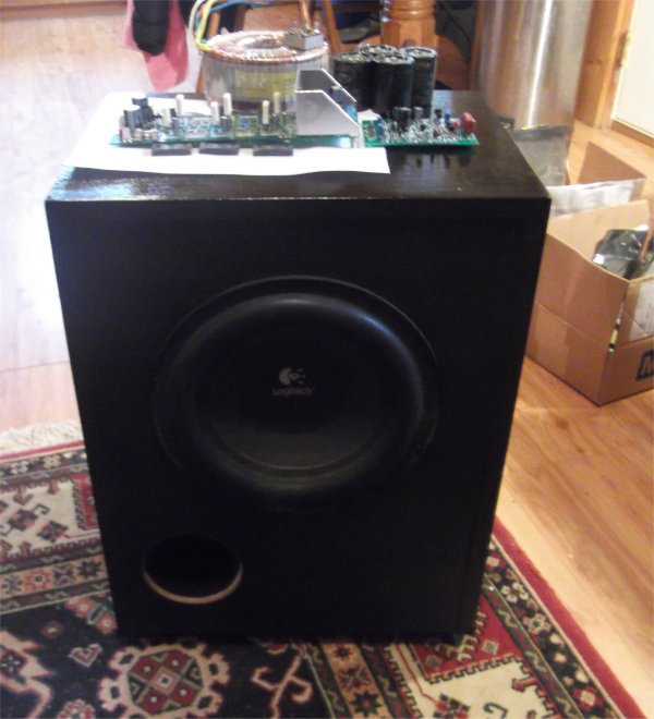

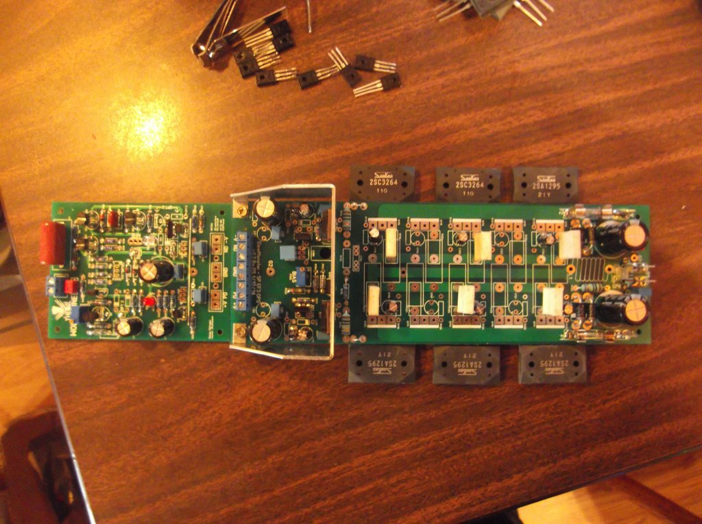

SLEWMONSTER LF
While you all are waiting to hear the subtleties of the CFA "holy grail" , I want to see/hear
the "grunt" factor of these amps. Are they durable ?? we'll see 😀 .
At 60V , a slewmonster with 3 pair MT-200 (below 1) will have almost 25A SOA. And the hungry subwoofer is the true test (below 2)
I'll need to dab some silicone/or contact cement -on all screws/some caps , The LF
microphonics on this amp will be intense. Luckily , I'm ported ... (26hz Fc) with a
100cm port - air will blow on the amp 😱 .
I did not choose a CFA for this - just a non-cascoded "wolverine" with custom
comp. and NO cap multipliers. I want the WHOLE 56-0-56V rail. (EvanC's trafo).

"For the VBE, try R104 as 2K4 or even 2K2 if needed and see if you are closer to the sweet spot. ''
For the BJT Slewmaster, the VAS relies heavily on the 33p compensation cap. With mosfet output the VAS behaves much better. No compensation needed (I haven't checked PM/GM, which should be fine with this topology, but the pulse test was smooth) and 2 feedback paths can be separated. And this is by driving the latfet directly from VAS. So no need VBE and extra driver. Haven't checked THD20 but this could be a winner. So now I have 2 topologies competing for the best (or this one will be special for high power version) :sing:
Surprise...!
It has second (and third) , of course. You just can't see it.
But I CAN (below) - there is the "ugly face" (at 150db down).
Drop that noise floor - there it is. But it is Loooooow ! "C" is the champ.
PS - it also keeps that same H2/3 ratio after it clips - sort of "tubey". 😀
let's see the Valve do 1/2ppm. Ha !
