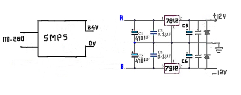

Please bear with my lack of experience....I'm trying connect a 24 v SMPS psu to a linear smoothing stage. The unit itself is completely isolated, but without a separate earth connection. Can I then connect it as shown in the diagram below or what other corrections/components should add to make it work?
I'm thinking especially to the -left- pre LM7812/7912 common & grounding sections of the diagram!
Please bear with my lack of experience....I'm trying connect a 24 v SMPS psu to the linear smoothing psu. The unit itself is completely isolated, but without a seperate earth connection. Can I then connect it as shown in the diagram below or what other corrections/components should add to make it work?
Drop out voltage for the 78XX series regulators is 2 volts. For 7812/7912 you need a min 14 volts of input voltage for a stable regulation.
Your circuit would work if the smps output voltage were higher than 28 V (14+14) with the condition that the currents of both postive and negative outputs are the same.
