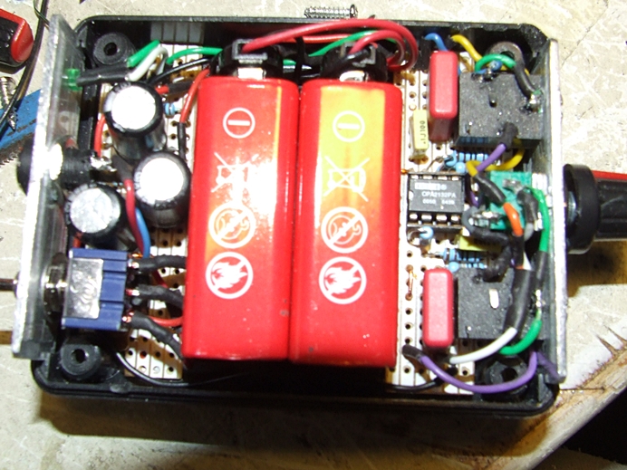

I couldn't agree with you more. I just completed a headphone preamp, & testet it with a 24v/1A /SMPS which splitted to +/- 12v using a TLE2426 v.earth circuit. I was indeed very pleasantly surprised by both the noise and the accuracy compared to the batteries. Almost precise +12.003/- 12.004 volts on the rails and virtually no dc off-sett at op-amp outputs what so ever. Perhaps I've been lucky with the SMPS I bought!

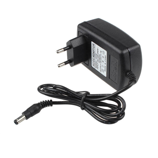

The other option is to use a "standard" 5V 2.1A SMPS. Point is I have thrown away many a "standard" 5V 2.1A USB charger as many are very noisy and mains polluting. Feeding a Silentswitcher with a classic "linear" PSU seems counterproductive
