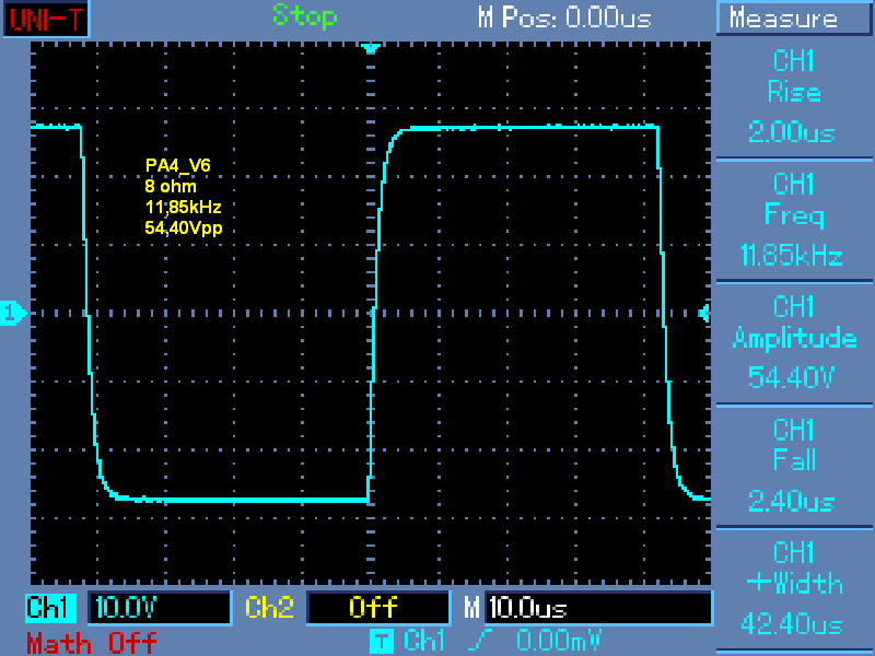

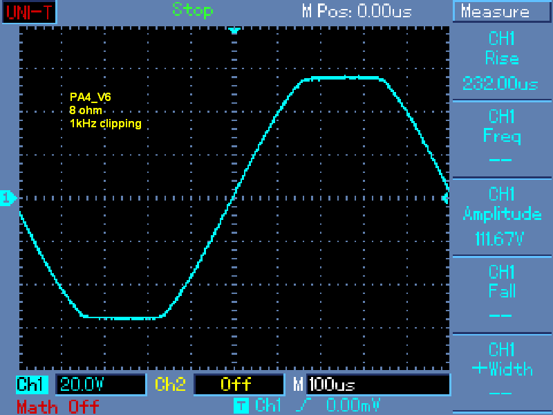

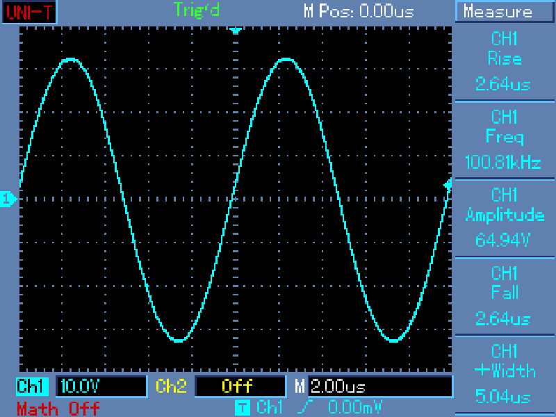

After one year and a half of tests and evaluation, there is some small upgrade to this amplifier. The new version is no. 6, and it is called PA4_V6. It is rated at 2 x 150W/8 ohm and 2 x 300W/4 ohm. It has true balanced input now, discrete, without opamp. The amplifier is quite fast, and does not suffer from any cross-conduction problem, as seen from 100kHz/8 ohm measurement. Please also note perfect behavior when clipping.

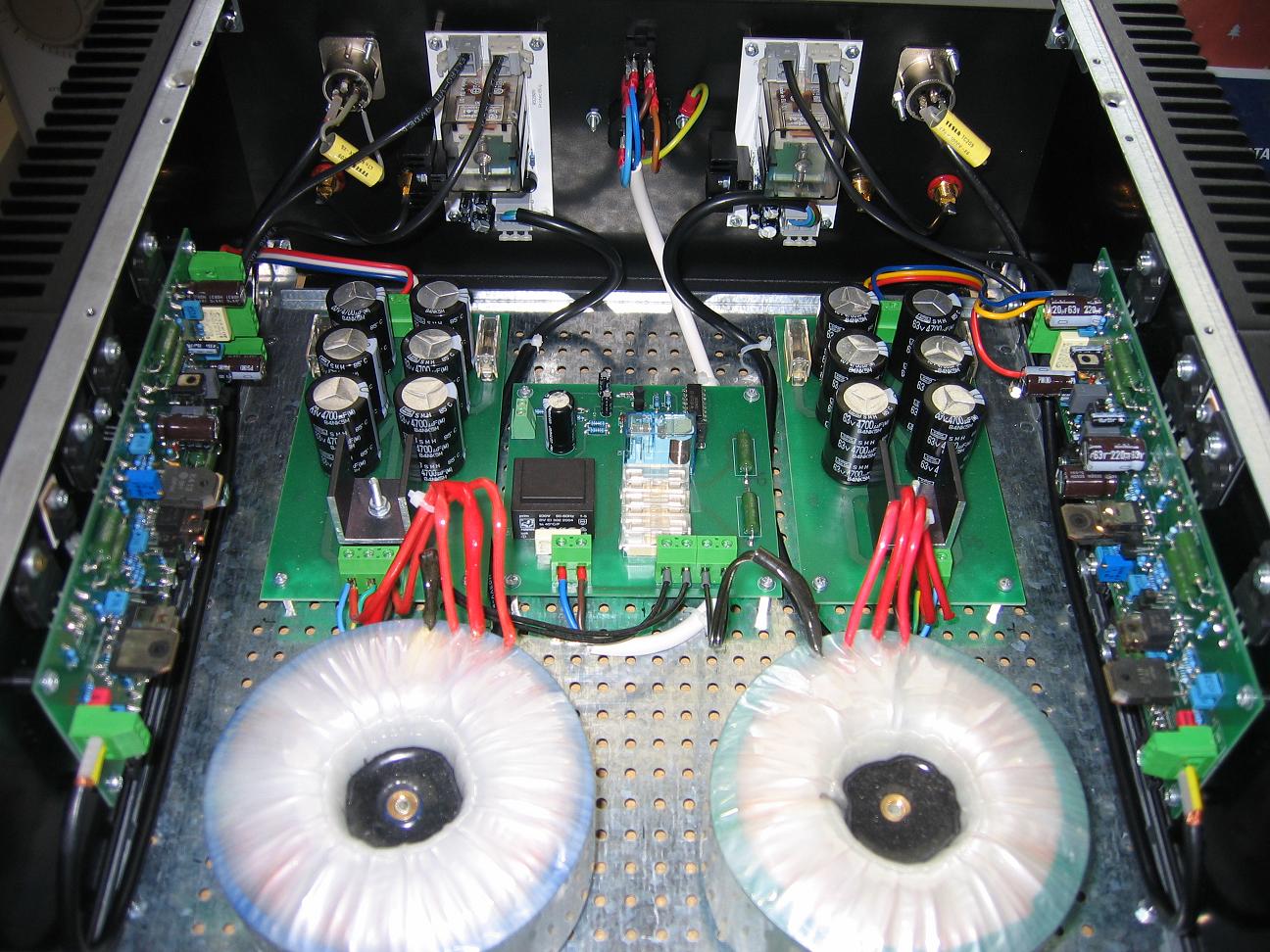

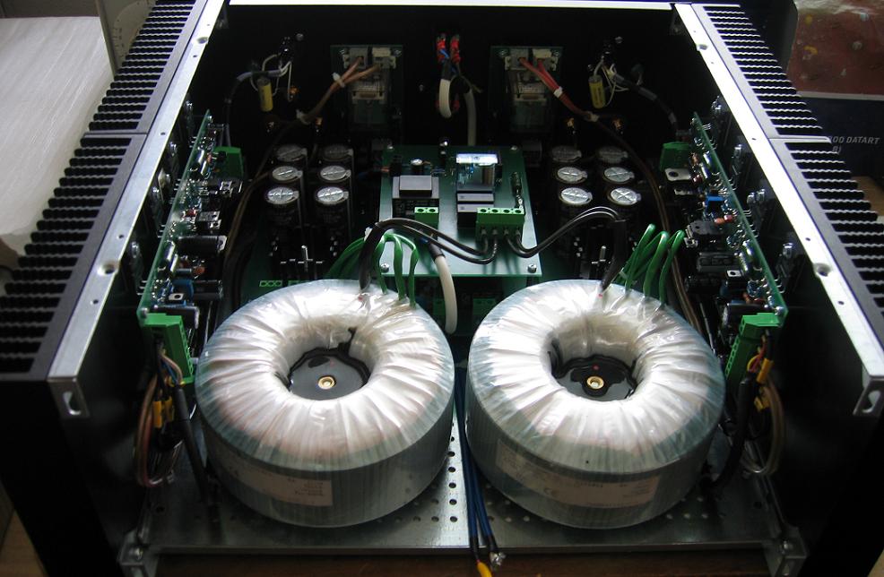

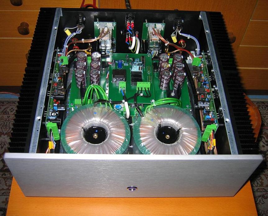

Hi all,
thanks for your kind words.
There is no problem with transformers, as they have wide plastic circular base and there are two plates - perforated mounting plate and solid bottom plate in a distance of some 4mm, so the whole thing is quite solid and does not bend.
Output DC protection is made with power relays. I am quite conservative in case that the amplifier goes to a customer. I still plan to evaluate MOSFET protection for several weeks (at least) before it will be released.
