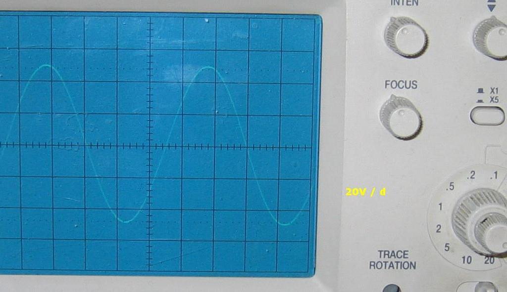

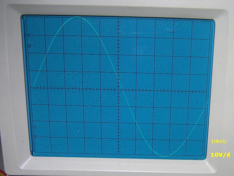

The photos show clipping behaviour with 4 ohm load:
Very nice clipping , Pavel...
High Andrew, it would bring more "smooth" curves, provided sample rate was high enough. With 8-bit A/D, we have only 255 levels applied to full vertical range. The interlaced analog levels are approximated to the closest digital level then, so we can see irregularities. And the A/D dynamic transfer function is not ideal.
