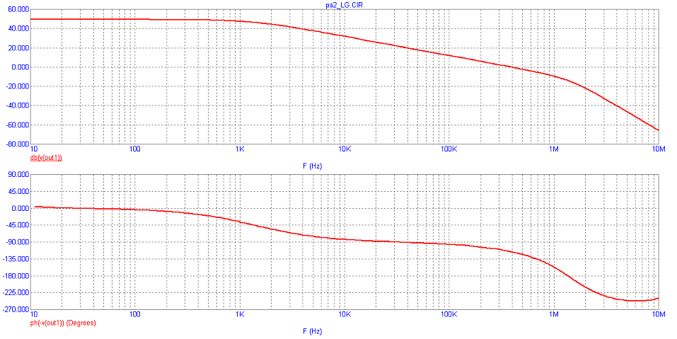

I can't see any compensating capacitors. Are they not needed
(drain-gate capacitance may be enough)? If You simulated
that circuit, can You show open loop Bode plots?

Which amplifier was measured ?I also add the results of measurements
plk said:Which amplifier was measured ?

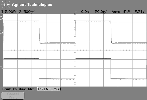

Real measurements from PMA "s laboratory, no smoke, no fog, no fantasy
http://web.telecom.cz/macura/step_response_pa2.png
Real measurements from PMA "s laboratory, no smoke, no fog, no fantasy:
SR= 90%-10% Vout
From you grafic Vout=40 V
so: 36-4=32V for 500mSec = 64V/uSec as said John.
Francesco.
SR= 90%-10% Vout
Francesco.
500nS not mS, sorry
Sorry, its difference between definitions....
-SR represents the maximum rate of change of a signal at any point... max(abs(dV/dt))
Slew rate - Wikipedia, the free encyclopedia
-90-10% - it may be used for measuring rise or fall time, not SR.

agree, but let say that 64V/uS is the mean SR of this amp, as the
(abs(dv/dt)) is the instataneous value...so MOS57 is also right...

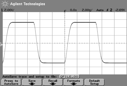

Federmann, what you measured in post 61? It is far away from your simulations and it is very poor result. Or you must it heavily compensate, because it was oscilator?![]()
I know it's not the best result. I used the probe 10:1, and the voltage was greater. As I wrote, yet I can not disclose more.
