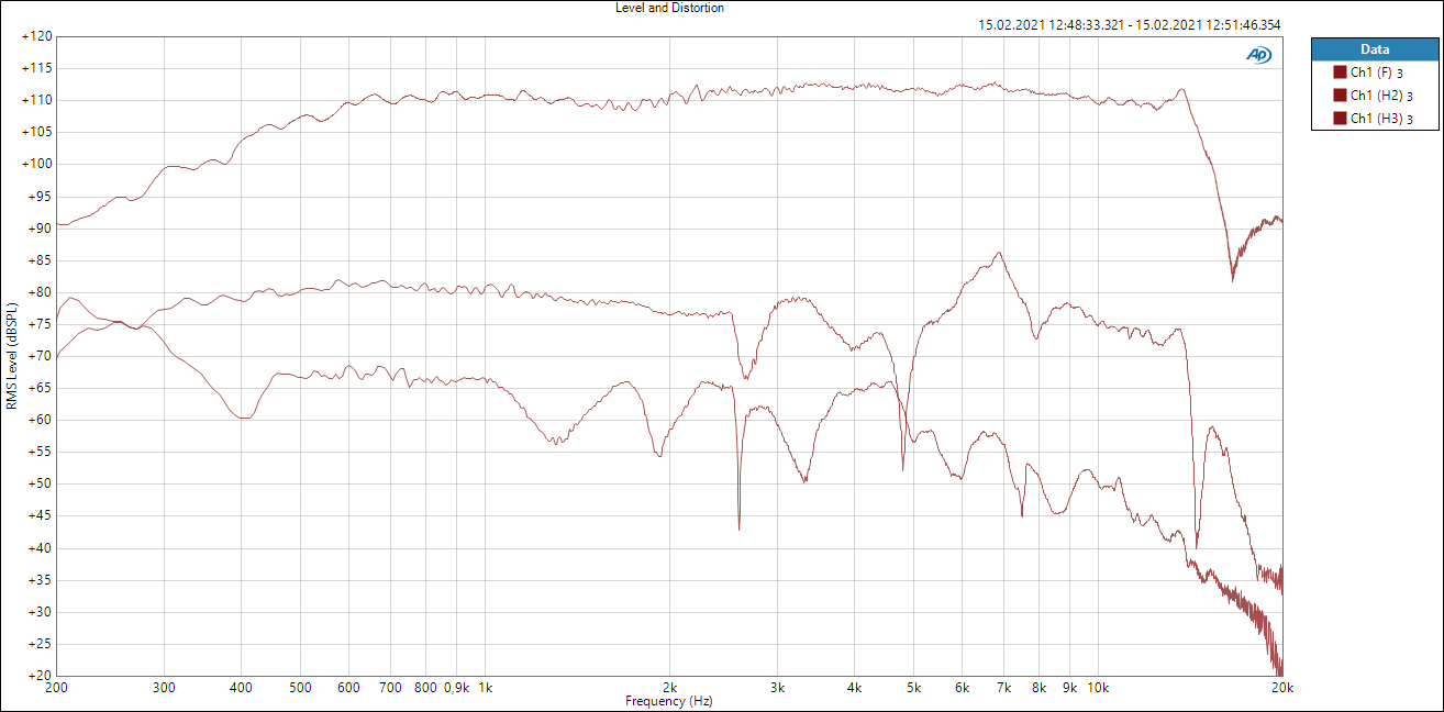

They have higher H2 but H3 is low and stays there. And don't forget - at crossover frequency the level of the driver is already 3-6dB down! This couteracts a rising THD of domes at lower frequency.

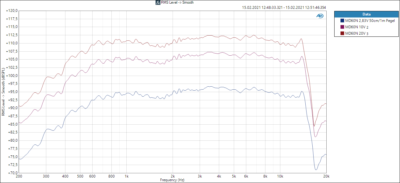

I wonder if you did some testing not only at 2.83V, but at higher levels, will the distortion will go up faster than the SPL?
The graph shown may be somewhat misleading to some readers- one may be be tempted to say it can go as low as 200Hz, as distortion does not appear to be rising. Can AP show the distortion in relative terms? (dBr or %) This is sometimes an aid to interpreting the useful lower limit.
The mechanical parameters of this driver (2.5” piston on sealed chamber with 0.5mm x-max) the excursion limited SPL is 80dB at 200Hz. So yes it can do 200Hz, but only at very quiet levels.
Experienced readers looking at your your graph @IamJF would still say that the lower limit is 700Hz.

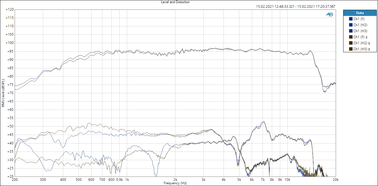

Look - it can easily do higher levels. I'm not talking about stuff I didn't test 😉

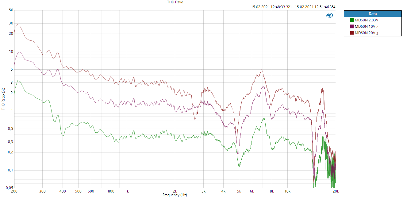

It has high H2 levels but H3 stays low, even at low frequencies. 300Hz is always a huge stretch for a dome midrange, even the 3". 400-500 is realistic with Bliesma 3" but 500-600 is good for the 2,5". 110dBSpl/1m is at 70W and sine - not wideband noise. With music they can deliver more for sure.

Those are measurements of a single MD60?

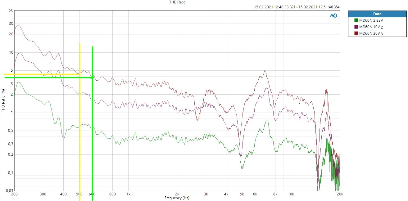

According to your excellent measurements. It can hit 110dB at 600Hz.
And 4% THD at 600Hz is an acceptable limit for that single driver?
I think your data is very clear. Thank you.
I think my tolerance for distortion or exceeding x-max may be lower than yours, that is all (eg. 110dB at 600Hz is 1.5mm; 3 times the rated x-max)

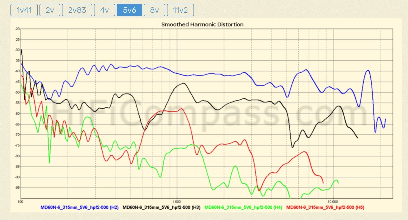

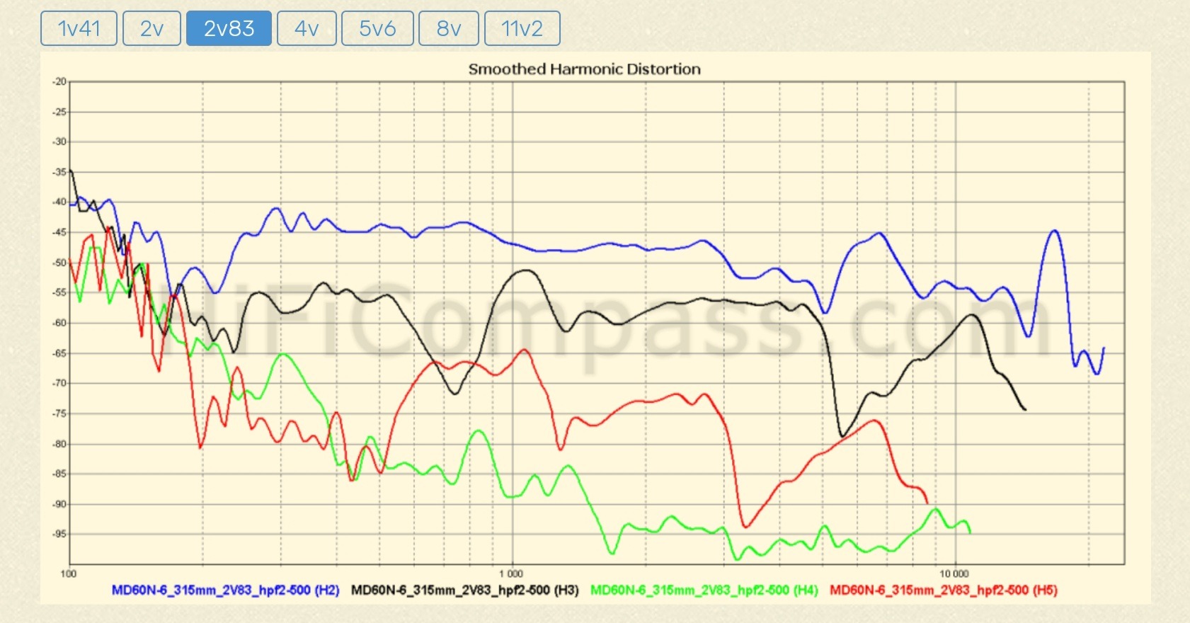

There were some running changes made to the MD60-N, which looked to be related to the dampening right behind the dome as well as the VC former. I had the first gen MD60-N open and found an unvented Alu VC former. That may be why the fundamental resonance peak had another peak right next to it. The double hump impedance usually means HD trouble down low at Fs.
Looking at the posted graph and measurements above, it looks like these are from the current production model. I wanted to love this mid when it first came out, but was disappointed based on my initial findings. It may have been improved to the point its worth giving another listen. The higher sensitivity is attractive to me if it doesn't compromise output capability in the lower mids, forcing a higher xover if one wants more SPL. If those measurements are accurate, there may be some hope. The old version has a big odd order HD peak around 1k, which was verified by Hificompass. That was a deal breaker for me and explained why I heard what I did.
The Scanspeak D7608 is also limited by low xmax, but it has more SD to compensate. It also relies on proper rear dampening to get the best from and this greatly effects low mid output capability. I usually run two of them in MTM or MMT if I need more output.
The other thing to consider before dismissing a driver for low published xmax is some motors are more linear beyond theoretical VC excursion limits, so its important to check this stuff out before moving onto the next greatest thing. In the case of the MD60-N, the even order harmonics aren't necessarily a bad thing. The more detrimental odd order stuff on the other hand can be harder to tolerate if you're sensitive to that sort of thing. Some people swear its not that audible, but I disagree.
So maybe I'll give the MD60-N another chance now that it appears to be improved.
In the case of the first gen MD60-N, the posted HD measurements below are showing elevated H3 and H5 around 1k, which are high in relation to even order H2 and H4. The ones I tried sounded very shouty when pushed harder and not in a linear way. I did quick HD measurements in Clio a few years back and got very similar results as Hificompass. Hopefully this has changed with the revisions.

looks like SBA has already made the change to a non-conductive former! (higher Qms)

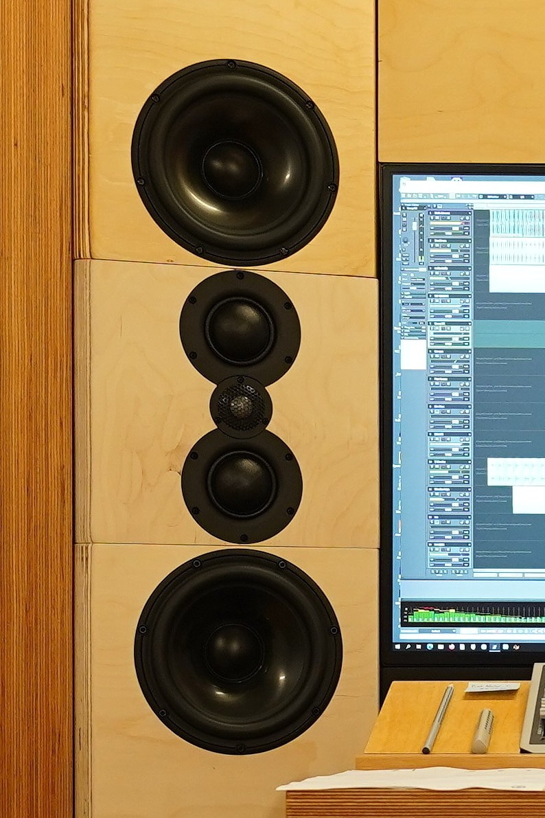

This wonderdome from SBA is getting better and better .. the guys (and girls?) at Dayton Audio are smashed to the ground 🙂
Return of the classical 3-way studio monitor in compact size to the market?
Death to all 2-way sound betrayers!
HOLY TRINITY ;-)
