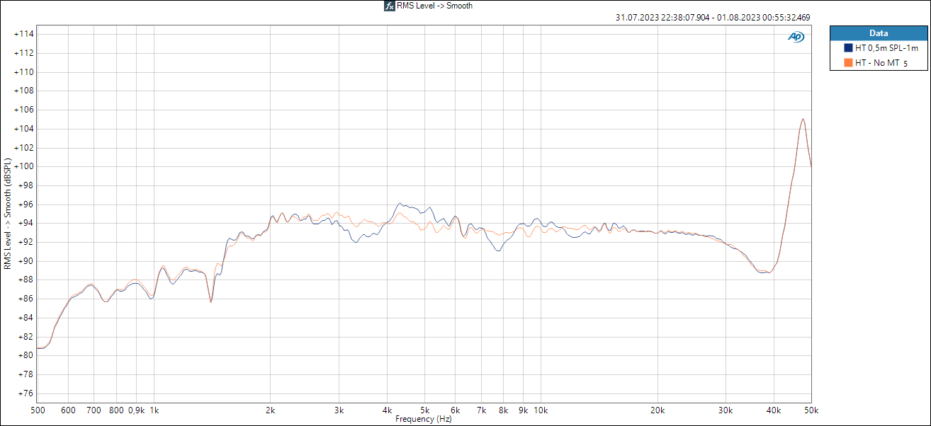

With protruding/convex domes and nearby/close-up tweeters you will get a reflection from the dome midrange ... a suitable sculpted foam absorber could probably fix the reflection ... maybe this reflection is part of the reason why some expensive studio dome midranges have a short horn loading integrated so the reflection is only minor!
In case of doubt , compare responses of the tweeter with or without the neighbouring midrange dome (covering the mountig hole of the mid with some stable piece of cardboard) ... btw , in a MTM layout - the reflection is more pronounced!
@Marveloudio TRUE! And most designer seem to don't care. With my MTM layout for my last project I decided to print new frontplates for the Bliesma midranges to reduce this effect. The short horns etc are also introducing an unsteday front baffle and I also got influences with it. I belive it's more about protecting the domes.

The latge domes from ATC and Volt need to be recessed due to large magnets. They also do this to get the flange smaller to decrease driver spacing. I've seen custom versions of the ATC and Volt domes with partially machined flanges.
Its always beneficial to recess the domes for exactly the reason you stated, which however isn't that significant of a problem, even at higher SPLs. Morel recesses their domes as well as Dynaudio.
I designed a 3 way with D76 and D330 esotar drivers on which the reflection of the tweeter output from the mid dome was repeatably measurable. It didn't however cause any audible issues being so close in time with the rest of the direct audio coming off the baffle. Im sure you'll see a minor disturbance in FR from it but its so small that you couldn't specifically say it causes some sort of acoustic signature.
