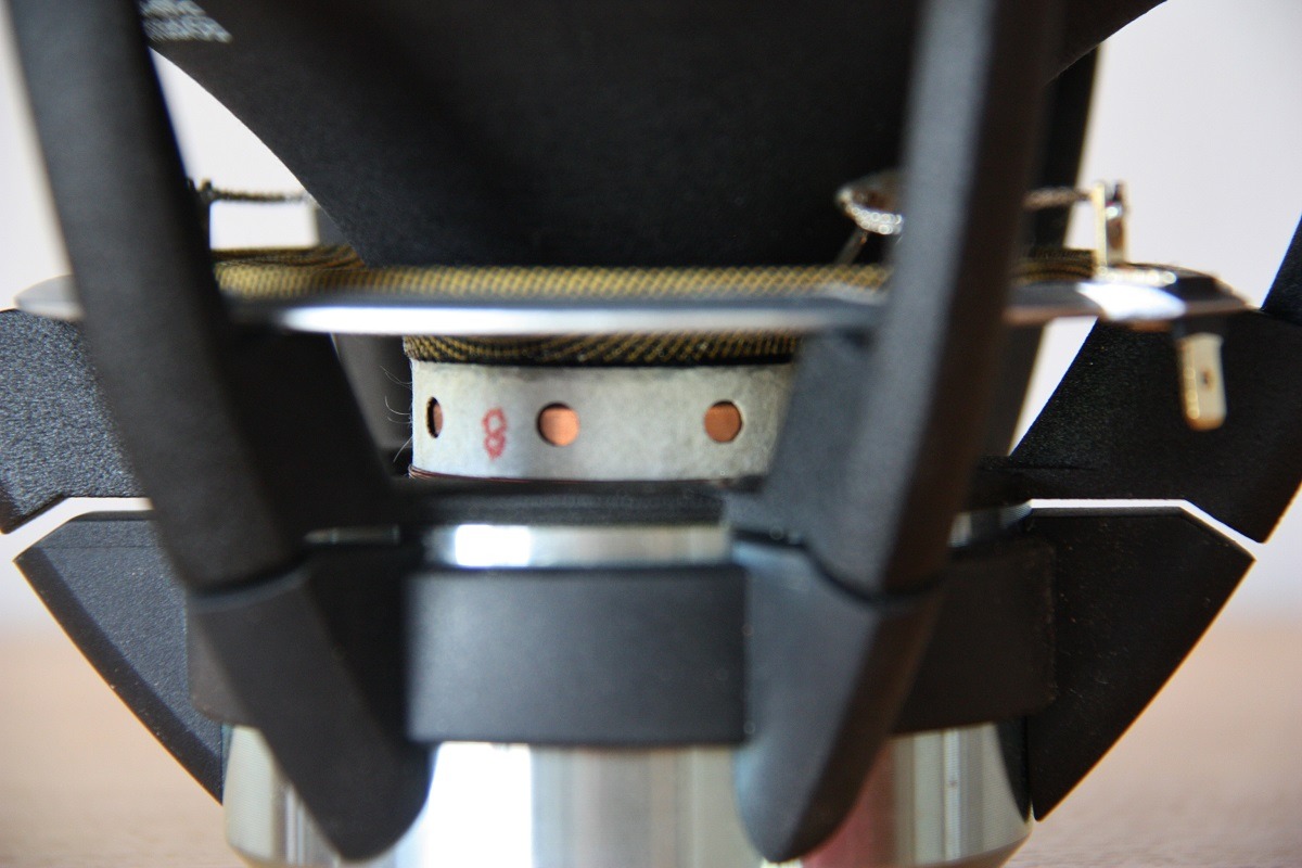

Btw, nobody is talking about that the bottom part of the basket is 100% just for looks apparently and doesn't seem to have any function whatsoever? (look at the gap between)
That's also one way to blow your budget up

Yes and the dark side of the moon is a good resting place for the rich![]()
You have overlooked my smiley? Or have not recognized how it relates to the post before? Some brainwork is your friend here

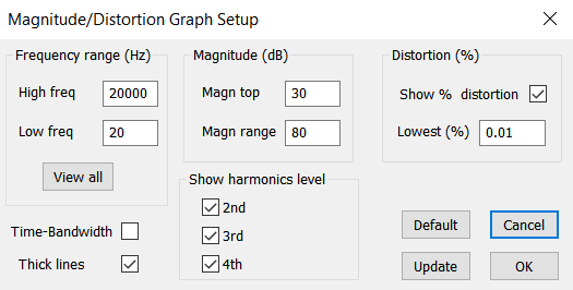

ARTA doesn't show the peak in 3rd and 5th harmonics. I'm so happy I don't have to deal with this software any more ...

What do you use instead?ARTA doesn't show the peak in 3rd and 5th harmonics. I'm so happy I don't have to deal with this software any more ...
