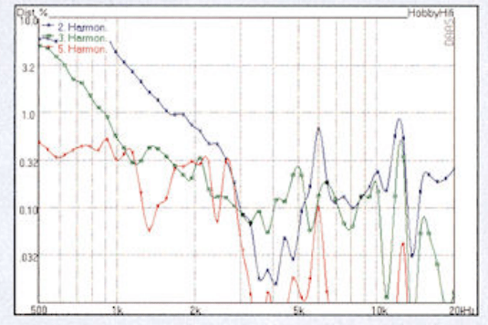

Interesting to see, it looks like the newer model is a lot worse than the old one from 2011;
This is at 90dB
When the right notch is being used, we can get rid of the 6kHz and 12kHz spikes.
I mean it's obviously just a very vintage kind of part, so I wouldn't expect top notch quality to begin with.
But at least something workable.
This is at 90dB
Paper teeeters…. For what is this a replacement part? I’m no expert on Marantz speakers, but I never got the impression these have contributed to the state of art of hifi. It’s quite a flimsy drop in replacement too, just like the original was. Nostalgia has its funny ways…

Does everything has to be state of the art?Paper teeeters…. For what is this a replacement part? I’m no expert on Marantz speakers, but I never got the impression these have contributed to the state of art of hifi. It’s quite a flimsy drop in replacement too, just like the original was. Nostalgia has its funny ways…
There are other cone tweeters that perform better. Read: usable.
I just mostly find the difference between the two measurements interesting.

This is not what I call usable. It's got what I'd call very high levels of high order distortion that make me automatically disqualify it.Does everything has to be state of the art?

I already said that myself, it's also not what I asked?This is not what I call usable. It's got what I'd call very high levels of high order distortion that make me automatically disqualify it.
