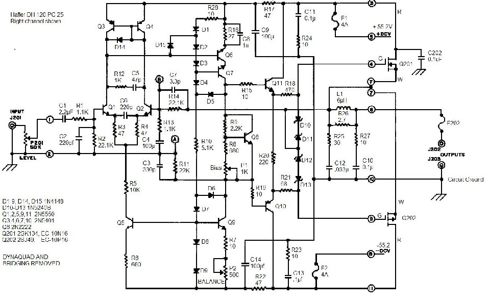

Finally seeing the schematic, that unballasted current mirror with the peculiar diode definitely got my attentionThere must have been a reason, although I guess EB has sworn off the forum.
I was not going to ask about that diode until I understood a lot more.
Looks to me as if it limits the voltage across the current mirror.
I would probably give the mirror some degeneration AND I would look at adding J-Fet buffers to the existing LTP. Use a 2SK389/LSK389 with a 56K resistive tail. In any case, I'd probably up the emitter degeneration resistors quite a bit. Especially with a CM load the degeneration only improves linearity, gain is only minimally reduced.'
Alternatively going for J-Fet inputs, at a minimum with zenner diodes in the drain leads to keep within the voltage limits, preferably fully cascoded may be better.
I'd also look at the VAS loading RC (C3/R11), it seems a bit brutal. It may be smarter to use a higher value and return it to the inverting input (See Bob Cordell).
C9 & C14 can probably use to fit the largest value you can physically fit (a few 1,000uF will do no harm and a Diode in series with R17/R22 may then be beneficial.
Q6, Q7 & Q9 are quite critical to sound quality, I think you can better than what is in place. Samuel Groner's commentary on Self's Power Amp Design Book can serve as beacon (another piece that deserves JAES publication and self publication). You could even use a J-Fet or Mosfet for Q6.
Q10 & Q11 are up next, Goldmund uses some very low Cob transistors there, for good reasons. These used to be "Video Transistors", with very high voltage ratings and very low Capacitances and high Ft, it seems most manufacturers obsoleted these parts with the demise of CRT TV's...
C1 and C4 would be next on my list, C1 for shorting out if a J-Fet (buffered) input is used, and with Fet buffered input you could use a "trick" circuit to deal with C4 - use a 1M resistor from the output to -Input and then a 1uF Film Cap of high quality to the point marked "B" on schematic, with the original connection disconnected.
Your DC Blocker capacitor is now inside your feedback loop and thus it's sonic impact is reduced and you can use a film cap. If you like a little "soft/warm" flavour for the Amp find Polycarbonate Cap's for this, I loved the old Siemens stacked film polycarbs for modding SS Gear, shame they are history.
If you use MKP you will have a bit more clarity, MKS will be even warmer but perchance a bit too soft. Inside the feedback loop the differences are quite a bit reduced.
My final point of attack would be to look at all these clamping diodes (D5, D6, D10, D13, D14, D15 - the others are voltage references) and look for the lowest reverse biased capacitance diodes you can fit.
Have a look at all these compensation cap's. If you can find them, my recommendation is non-magnetic mica of NP0/C0G Ceramic.
As a last item, the rail fuses may warrant attention, both fuse holders and fuses. Not that I'm suggesting expensive audiophile fuses there, but not all fuse holders and fuses are created equal. I would look for magnetic materials, good contact pressure etc. first.

It is a single ended VAS. At clipping it can be driven to quite a decent current, more perchance than it likes.
The diode and other halve of the CM limit the base voltage of the VAS Transistor to two diode drops, say 1V, this limits the current. Nowadays often a protection transistor is employed instead...
I think I like Erno's diode more better. There are also baker clamps and other clamps, they may perhaps be not necessary and may omit them, but Erno was clearly going for "Belts, Braces, Flack Jacket, Ceramic Lined Helmet and a sandbag wall" in his fight to make sure the Amp stayed reliable (nothing for SQ) and recovered quickly and cleanly from any clipping (which does have an impact on SQ though only if we are clipping the amp).
Ciao T
I can't for the life of me see how that one particular diode helps

It looked particularly yucky in open loop with very light loading, even with a very small voltage across the diode (at quiescence, according to my model, it has a very small forward bias, so any signal swing is modulating the capacitance a lot --- but then the voltage doesn't have to swing much to drive the following stage). But I did some more accurate sims with the following stage appended, while still not closing the loop around the whole thing, and it doesn't look nearly as bad with the loading on that node.
If I had some better DMOS models I might go ahead and simulate the entire amp just for fun.
And putting in emitter resistors would vitiate the clamping function, so it's understandable why things wound up this way, one of many design tradeoffs.

Yup. I find whenever I see something in a circuit that has both a decent reputation and is designed by a competent designer, it pays to double & triple-check.
If I calculate right, the diode has 62mV forward bias at quiescent. If I calculate right the Amp needs around +/-100mV on the base of Q6 (including degeneration) to swing rail to rail and the input impedance of the VAS is around 3KOhm.
I'm coming with approximatly megaohms for a low leakage rectifier (no schottky), next to the 10K or so of the undegenerated current mirror.
The CM degeneration would not change the clamping point materially enough IMHO to endanger the Amp... It would worst case add around 88mV to the clamping voltage for 100 ohm CM degeneration.
