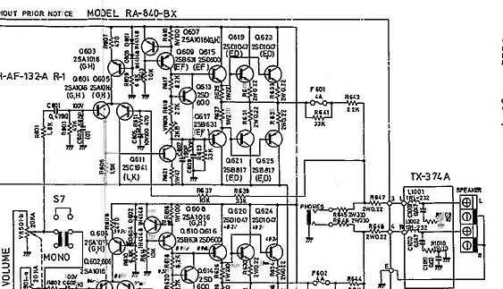

My Service Manual says:
Rotel RA840BX4
That one is definitly an Ottalla/Lohstrom. I would have expected Rotel not to change the whole thing wholesale for a minor revision and that was the schematic I could readily find.
Ciao T

Yes, this is rather different.
Only distinguishing feature, Resistor loaded VAS to reduce open loop gain (the Hafler has it as well...).
Quite brutal.
Ciao T
Mine is just plain RA840 BX. I wonder if the schematic in Jan's article is the one you are thinking of?
