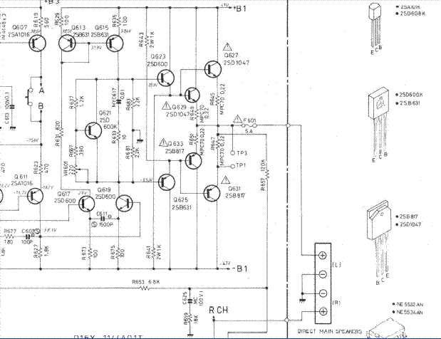

In and out of all my books, this is not discussed. I noticed the difference in the schematic. I know devices are not truly complementary, so I was looking for differences. Q10 and Q11 need only to supply sufficient current to swamp the gate cap. So, if this is not relevant at AF, then why the very large difference between R18 at 470 Ohms and R21 at 68? I do not see this n Cordell or any of the other schematics I have. I suspect something important here as the voltages supplied in the manual have a .2V offset between the gates and ground. I am sure he had a reason.
Another detail I don't understand. Function of R15 and R19. If they were tubes, I would say grid isolation resistors. What are they doing in BJTs?
As I am replacing the Hitachis with the Exicons, I would prefer if they behaved. They are not cheap and a 2 week lead time.

IMHO That's one good reason for R18 and R21 to be different. Those resistors and input capacitances form low pass filters, with delay. You need the top and bottom halves of the waveform to have equal delay.Input capacitance seems to be different between the N and P channel.... Their turn on and turn off times vary too.
The existence of P2 is a mystery to me. Hopefully it's not to adjust DC offset; that'd be about the worst possible way to do it. Maybe it's to adjust for symmetrical slew rate limiting? Whatever it's purpose, it seems silly to allow VAS idling current to be adjusted over a 50-to-1 range. Maybe there's a typo in the schematic and it's supposed to be 50R, not 500R, or maybe there's another smaller resistor connected in parallel to it?Position of P2...
That extra 0.22R resistor may not be a mistake, but the 2k2 in series with the output is definitely a typo. BTW, that circuit's totally different to the RA840 BX4 (see below). I wonder what flavor you have? Labels aside, there's often something in the fine print about "subject to change without notice".RA 840BX..... Like .22 Ohms on each output emitter, but another .22 ohms on the input to the output network.
Same function as grid stoppers; they're for stability. Same goes for R18 and R21. When thinking about R18 and R21, bear in mind there's no DC voltage across them. That 0.2V difference in Vgs is irrelevant.Another detail I don't understand. Function of R15 and R19. If they were tubes, I would say grid isolation resistors. What are they doing in BJTs?

Probably right for the Mosfets. You cannot "overbias" lateral fets.
Yes, I got appx. that value looking at the schematic. It is probably adequate.
The input and reverse transfer capacitances between the P-Channel and N-Channel vary around 1.5 : 1. That's why. The values are common for these mosfets.
Bad copy, drawing I suspect. Traditional R18 should be 680R and R21 470R. This is what is commonly used with Hitachi fets and also works normally with the 2nd source parts.

Trying to understand the bias in the DH 120. I noticed both channels P1 is set to zero. Maximum bias. Glypt from the factory.

Position of P2 suggests the Q9 only carries about 2.5 mA.
Not sure why R18 and R21 are different. Is this based on the difference in dc offset of .2V and the charge rate of the gate capacitance?

I cannot quite read the number, but that is the position and it is 33K Value.
For the DH-120 incidentally it is R11 (+ C3) which pretty much determine open loop gain and bandwidth.
I'd estimate the DC open loop gain at around 70dB and the open loop bandwidth at around 22KHz, which is not so shabby at all, given the age of the design and the pedestrian parts used.
Personally I would be tempted as said to add J-Fet buffers on the input or switch to J-Fet Inputs and increase degeneration of the VAS (Voltage Amplification Stage) and IPS/ICM (InPut Stage/Input Current Mirror).
Changing the inputs to J-Fets would be the easier choice as it requires minimal changes on the PCB. A 2SK389/LSK389 with 39V zenners in the drain leads would do well, giving around +/-0.8V linear input range without degeneration.
The VAS could also use a NPN Emitter Follower to increase the input impedance, which can offset some of the gain lost by extra degeneration.
Bod Cordell actually covers all this quite well in his book. He uses in general 1:10 degeneration.
For the DH-120 VAS this would mean around 100 Ohm Emitter resistor (change C8 to 270nF), for the input stage 510 Ohm per emitter (330 Ohm per source if J-Fets are used).
With the increased degeneration of the VAS we can drop some more voltage in ICM, so 330 Ohm degeneration there would be quite all-right.
Due to all the various changes in the circuit (mainly increase input impedance of the VAS and increased ICM impedance of the ICM due to degeneration) massively increasing degeneration actually only looses us a a few dB of OLG, which should be around 65dB.
You could probably reduce C3 then by around the loss of open loop gain, so if (to be safe) we only reduce it to 220pF we get around 65dB DC open loop gain with a -3dB point open loop of around 33KHz...
Together with the new Dual Die Exicon Mosfets and some passive parts upgrades the rebuild Amp could be quite nice.
BTW, consider changing the 2N5550 for 2SC2240BL and the 2N5401 for 2SA970BL. Whilese these transistors are not "magic", they do offer better beta linearity, lower parasitic capacitance and quite favourable Early-Effect behaviour for the job.
For the drivers (Q10/11) something akin to a pair of BF469/BF470 (which are long discontinued) might be a good choice.

It s even less typical when looking at further this schematic..
The NFB sampling point is taken after the output fuse wich is
in serial with a resistor mistakenly marked 22K , surely 0.22R.
Then another 0.22R is in serial with the output inductance
that has no paraleled resistor, after wich is connected the zobel network....
