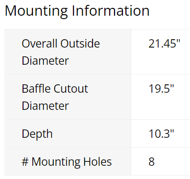

(L12 + L23) needs to equal at least 21.5in based on your Frame Width input.the woofer wont fit where?
Cut out size is different from frame width.
Frame Width = Overall Outside Diameter = L12 + L23.
Cut out size = Mounting Width = Baffle Cutout Diameter.
Surface Area of Cone (Sd) = 1525cm²
((19.5in x 2.54cm)^2) x 0.7854 = 1926.76cm2. Thick surround!
https://www.parts-express.com/Dayto...er-with-5-Voice-Coil-4-Ohm-295-054?quantity=1

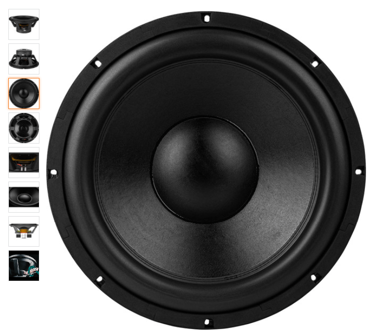

there are opinions that the Le of that DA 21" Kraken is too high at 8.5 , but i was playing with the Le parameter in the loudspeaker wizard
and the response change just a Tad above 200... just a pinch.
almost none.
so i guess it will excel in high compression tapped horns with a strong motor BL=38 and hefty XMAX of 21mm

The spreadsheet came out wrong because you modeled a 20.94in wide speaker mounting baffle with a 21.45in wide speaker!
The speaker will not fit top mounted or bottom mounted in your current model.
S1 and S2 would need a CSA of at least 21.45in wide x 10.30in high (1,425.38cm2) to be bottom mounted.
Your S1 and S2 = 500cm2 each.
No, it's your HR inputs.
The speaker is 21.45in wide.
Your BOXPLAN frame width states 21.50in.
Your HR L12 input = 32.80cm = 12.91in.
Your HR L23 input = 20.40cm = 8.03in.
12.91in + 8.03in = 20.94in.
Your HR L12 + L23 inputs need to match the BOXPLAN frame width of 21.50in for the enclosure to form in the spreadsheet.
Below is a 3 segment TH.
You modeled a 4 segment TH.
Your L12 = from the left of the cone to the middle of the cone.
Your L23 = from the middle of the cone to the right of the cone.
If 21.50in = 54.61cm,
and your L12 = 32.80cm,
then your L23 = 54.61cm - 32.80cm = 21.81cm for the enclosure to form in BOXPLAN.
