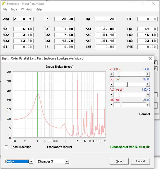

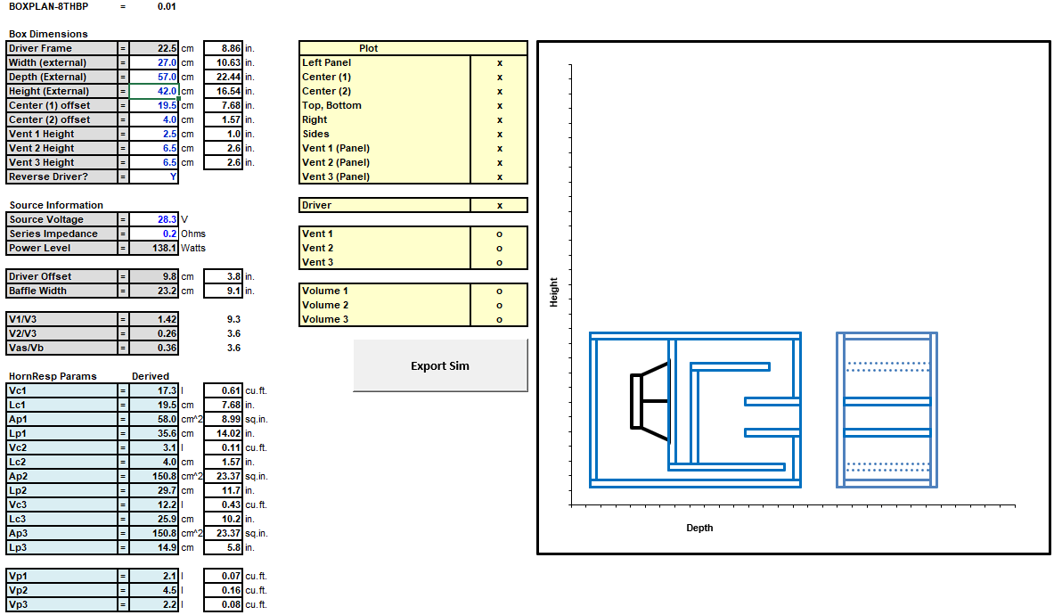

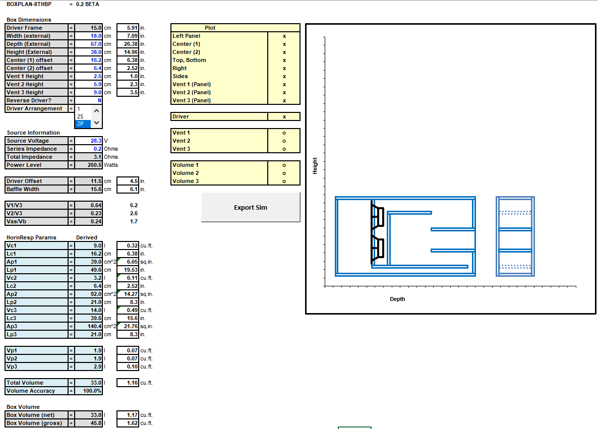

...and for version 0.2, I've added the option to have one or two drivers, and the layout and calculation for Lp2 is done a bit differently (the layout assumed for the previous version of the workbook results in a value for Lp2 that's too long to be useful).

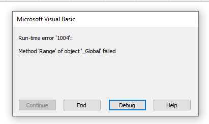

Ok, I think I misread your message - it's an issue with trying to import Driver data? Is it happening with one Driver, or all Driver data that you try to import from HR?Brian,
when i import a driver from HR on the cubo spreasdheet
i get the below error
