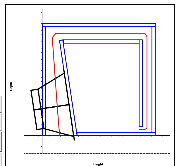

I suggest concentrating on getting the external dimensions and the panel width to match the actual build and the areas at S1 (the start of the line) and S4 (the end of the line) to match the actual build. Then use the "Optimize" feature - the intent is to get the number highlighted in red as close to zero as possible. Just keep clicking on the "Optimize" button until that happens. The result should be a layout pretty similar to what you built. Don't be too concerned with minor differences.
Ok awesome, thanks! And then I just update S1 to S4, Vtc and Atc in hornresp? Do I leave the three Par values at as they are (from Anders' original model)?match the actual build and the areas at S1 (the start of the line) and S4 (the end of the line) to match the actual build
Ok, another stupid question sorry - are the three par figures to transpose to hornresp L12; L23 and L34 in the spreadsheet? I must have input some incorrect panel dims as my L34 seems too high and throws the modelled response out.The Hornresp sim figures generated in the spreadsheet are likely going to be more accurate.

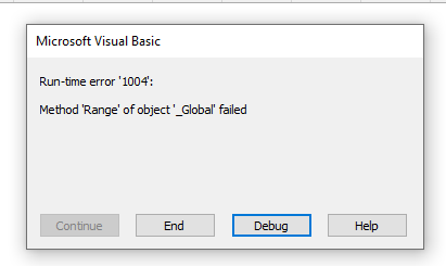

Post a copy of the BOXPLAN.TXT export file created by the workbook.Brian,
when i import a driver from HR on the cubo spreasdheet
i get the below error
and when click optimize i get this box size with a 15" driver
the driver sticks out
