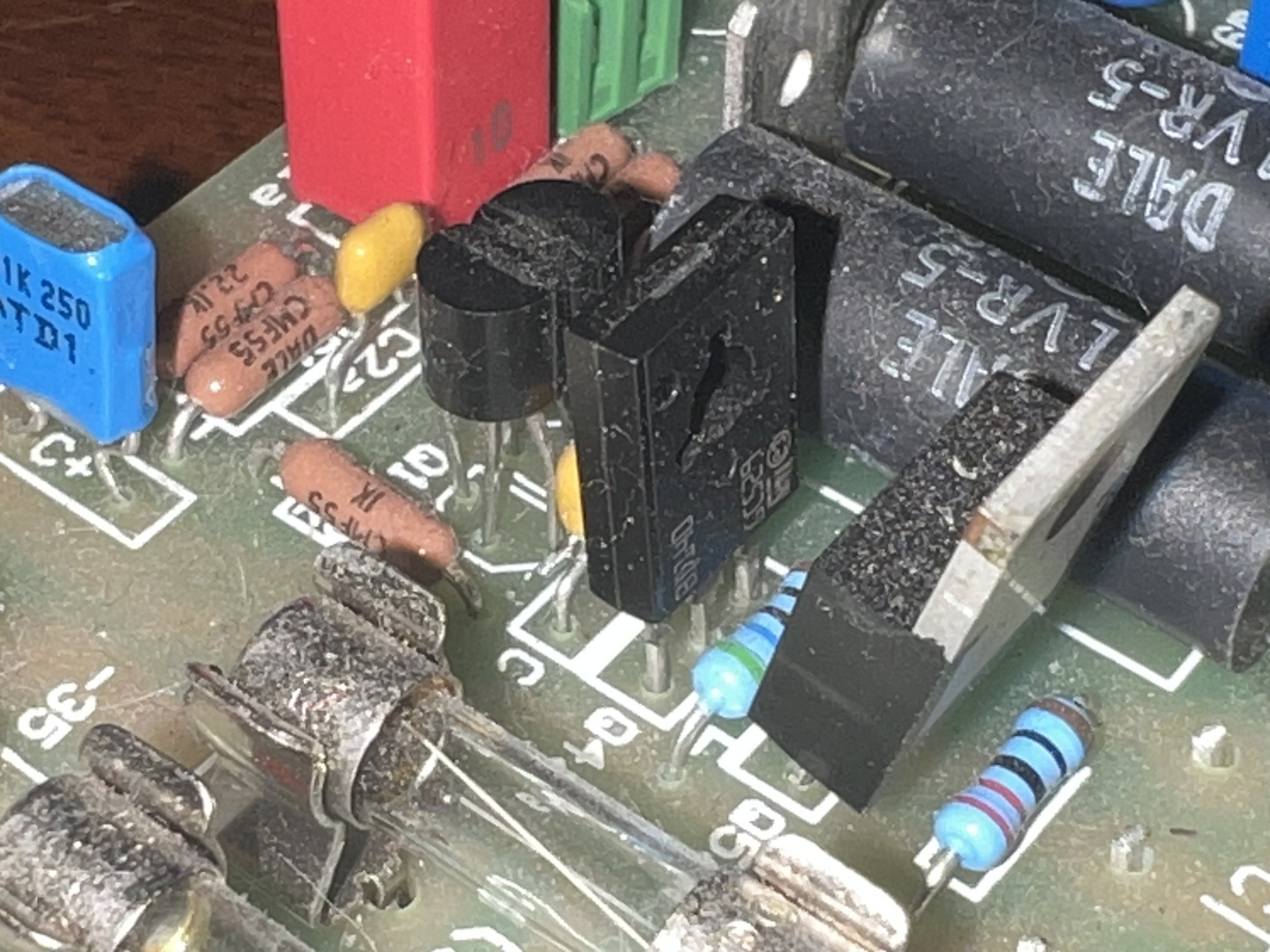

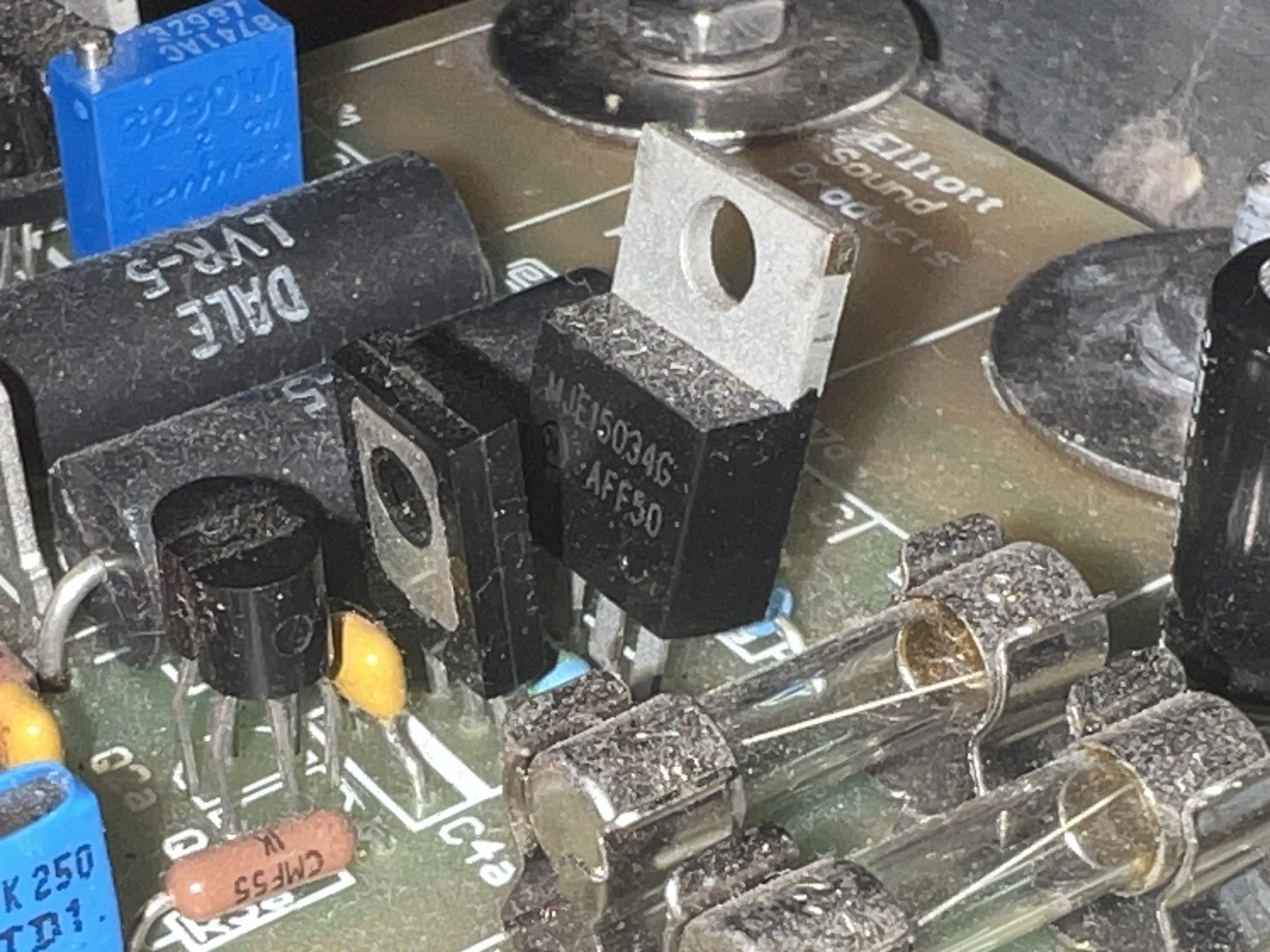

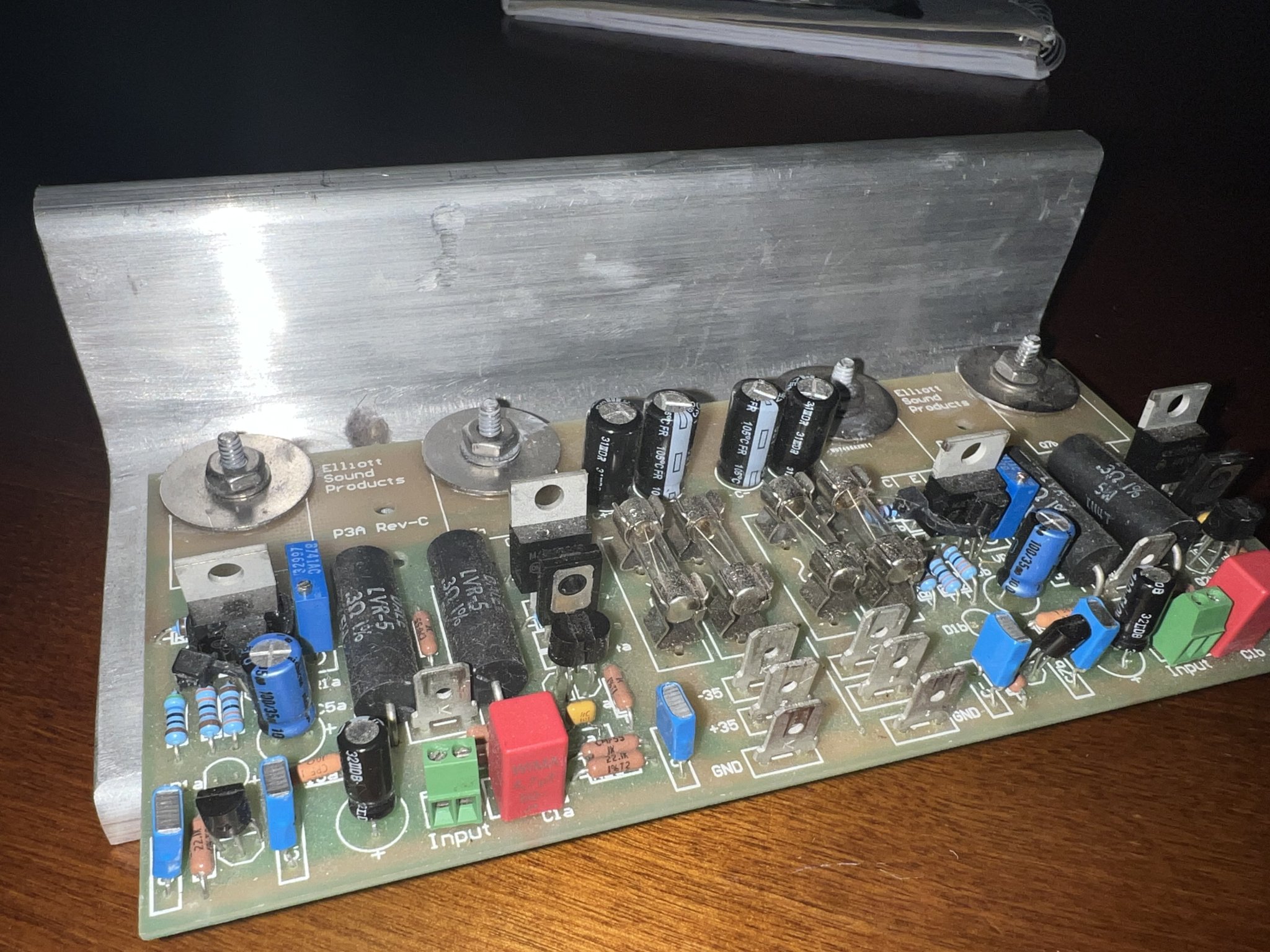

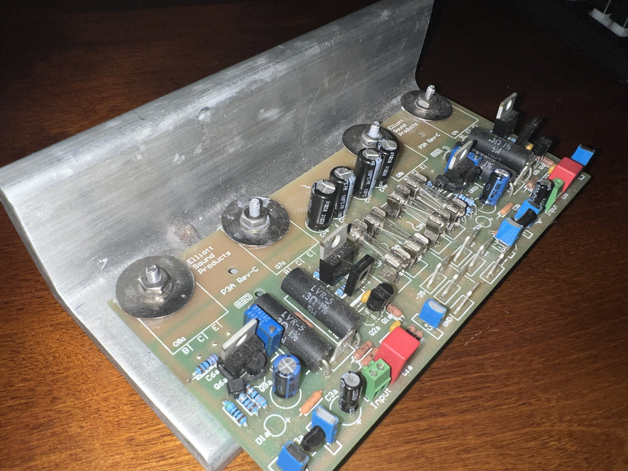

Finally, I found the board , please ignore the dust on the components....
I used mje15034/35 and bd140 for Q5. mjl21193/94 for q7 and q8.
This worked fine , no complains.

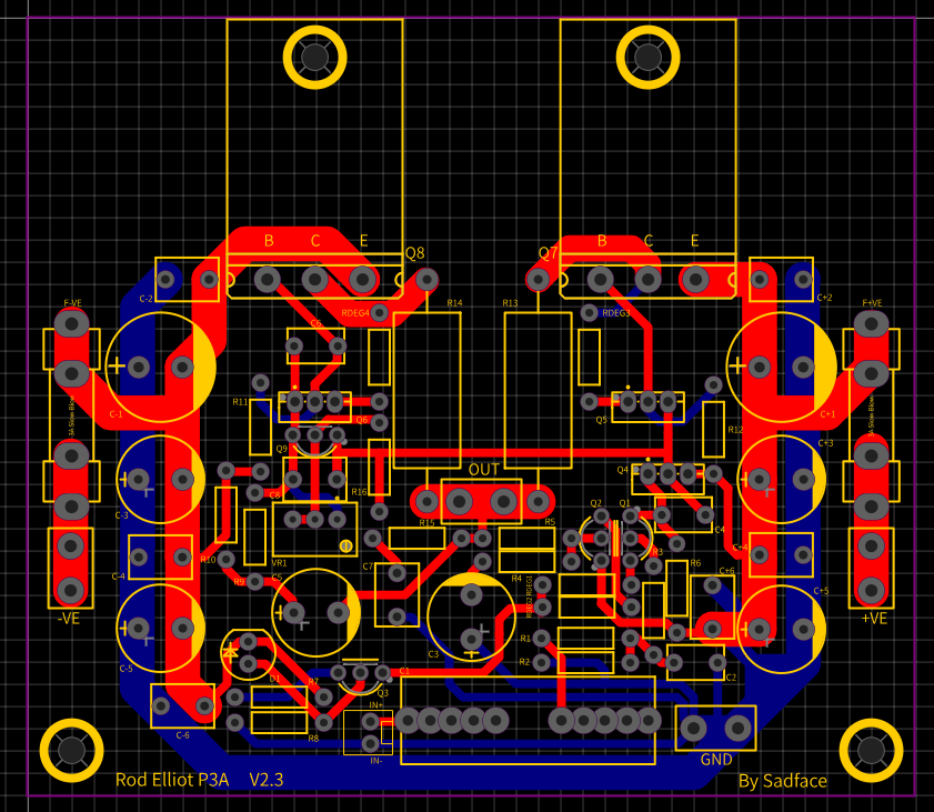

Version 2.3
I reversed the wiring on the trim pot so that the turns go in the correct direction.
Tidied up the labeling to how I like it
Nobody seems to have any negative feedback on the layout so I think I will stare at it for another hour to make sure I'm happy and then place the order.

MJE150XX series is like a tank! You don't need such transistors for P3A, also their collector to base capacitance probably higher than the to-126 BD139/40.Would it be adventageous to use the higher power package?
When you use progressive power supply caps, you usually use RC filters. Like 1R or 2R for the drivers and 10R or 20R for the Ips/Vas. You have the caps but no resistorsNobody seems to have any negative feedback on the layout so I think I will stare at it for another hour to make sure I'm happy and then place the order.
