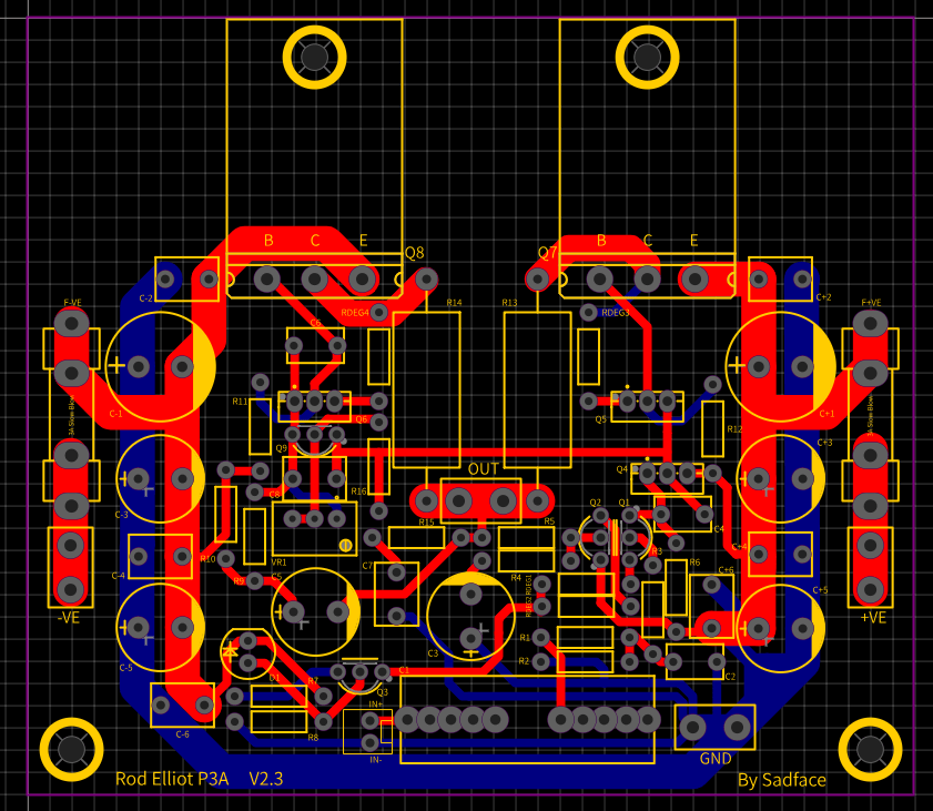

Capacitor Decoupling the front end from the output stages means more than adding a few capacitors to earth at the Vas and Bootstrap connections to the supply rails.Version 2.3
I reversed the wiring on the trim pot so that the turns go in the correct direction.
Tidied up the labeling to how I like it

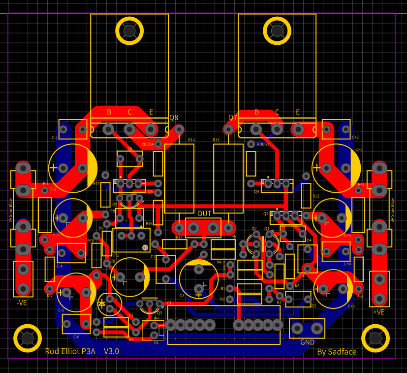

Nobody seems to have any negative feedback on the layout so I think I will stare at it for another hour to make sure I'm happy and then place the order.
If you would allow space for resistors to form RC low pass filter to prevent spuriae on the supply rails entering the Vas and bootstrap connections to get a more effective result. 47 Ohms and 47uF//100n should be enough.
I have seen circuits where RC decoupling has been used on only one rail, here that would be the negative one. The LTP tail is a CCS which has some rejection properties which the bootstrap lacks. The latter will ingest any negative supply rail.spuriae unless steps are taken to prevent such ingress.
The formula where turnover is - 3dB is 1/2pi. R.C. that works out at 72 Hz the filter. Frequencies above 72 Hz will be attenuated at a rate of 6 dB per Octave so the higher the spurious voltage is the greater this will be attenuated. There are on line calculators you can use. You can find one of these in a selection on digikey website. From one of these you should be able to see the attenuation at 100kHz.

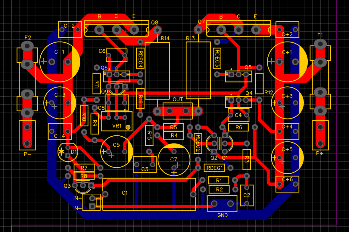

Here is my first draft of a pcb layout to accommodate the stability improvements etc.

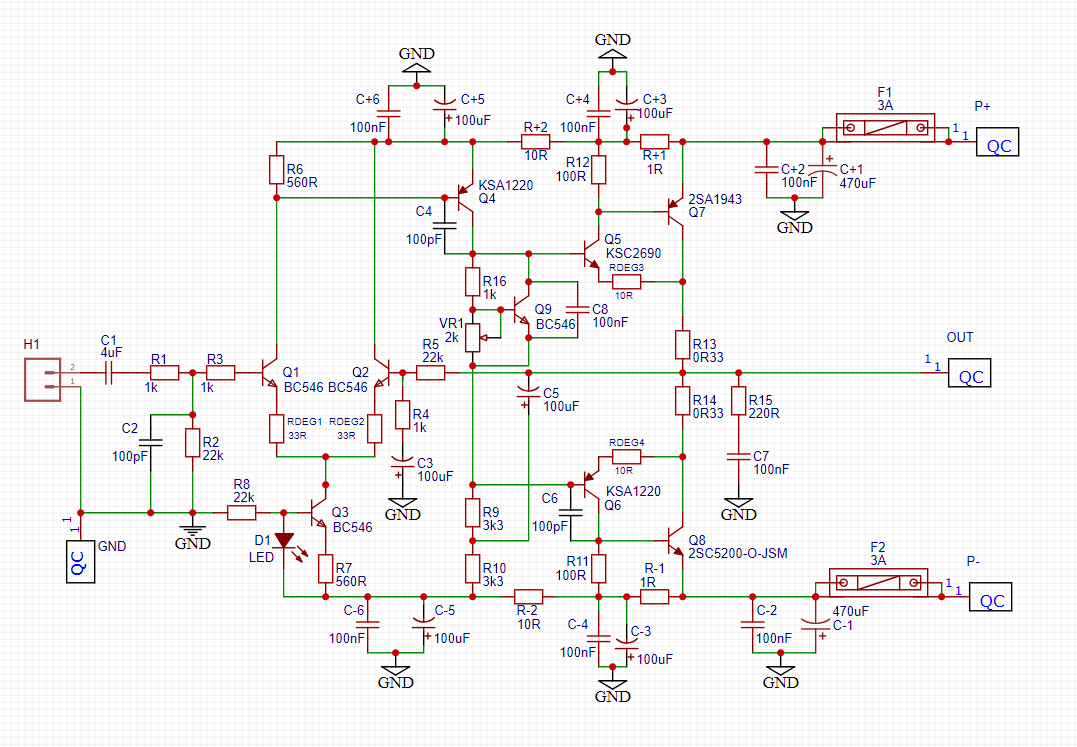

Schematic: I'm not sure if C-5/C-6 are of much importance so I haven't yet put them in the pcb.
From what I can work out the positive rail is more important here.
This is just a first draft, things like labeling, trace width, pad sizes, extra pad options etc are not yet optimised.
At this stage I am concerned with trace routing and parts placement.
This is loosely copied from Rod's part placement for Q4-Q9, VR1 and R13/R14. The rest is just where it made sense to me to put it.

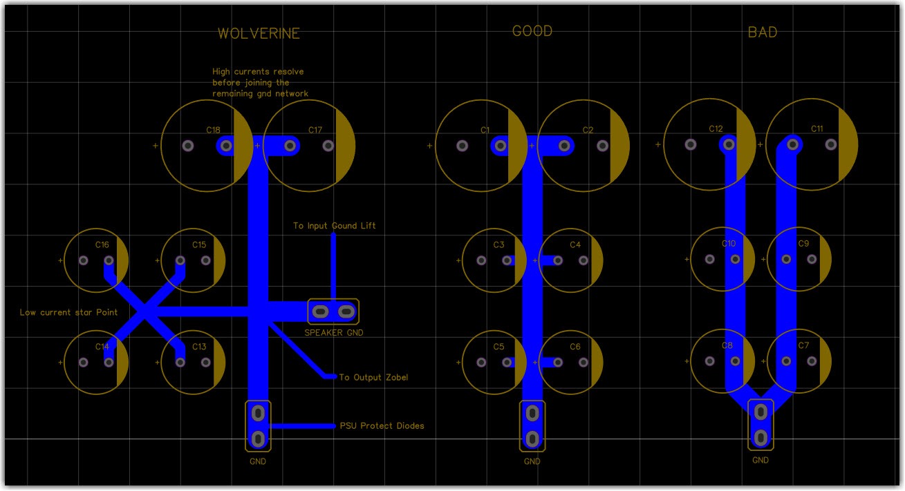

Grounding is often the trickiest part of audio PCB design. Ideally, the positive and negative grounds should resolve locally before connecting to the rest of the ground network. If you look at the ESP's P3a PCB, you'll see this in practice. Addressing this on your PCB would require a bit of reworking.
The Wolverine PCBs are an excellent example of audio grounding done right, using a star on star approach with a ground lift. It's quite a bit more intricate that simpler grounding topologies.
The "Good" version is what is generally recommended and how I see most grounding implemented on most successful PCB designs. I have not tried a PCB with the "BAD" Layout.
Douglas Self describes the reasoning for this in his book Audio Power Amplifier Design (chapter 25):
You can see this approach used in the Wolverine and ESP P3a layout.
The positive and negative rail reservoir caps will be joined together by a thick earth connection; this is called the Reservoir Ground. Do not attempt to usage any point on this track as the audio-ground star-point, as it carries heavy charging pulses and will induce ripple into the signal. Instead take a thick tee from the centre of this track and use the end of this as the star point.
A power amplifier has a mix of high and low currents. You want to control the flow of these currents (as described in the quote from Douglas Self above). With a ground plane, you loose this control.
However, I have seen ground planes used is specific parts of the circuit. Like just the small signal sections. I think Self does this in PCBs he sells for his Blameless amp.
You'll generally see ground planes avoided and specific routing used to control the flow of currents and keep the large output currents away from the small input current.

Moving on, in another oversight the zobel network now shows R15 as 220R?? Even with a proper value this is needs help from additional components.
on your GOOD layout, what do caps C1 to 6 represent?
Thanks for the catch on R15.
you have referenced info regarding the power supply itself.
the issue here is local decoupling on the amplifier pcb.
