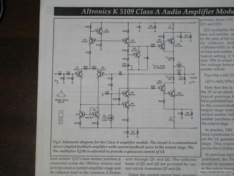

Not yet but I was curious to look at class A CFP. I haven't seen many others.Correct. Did you build the kit?

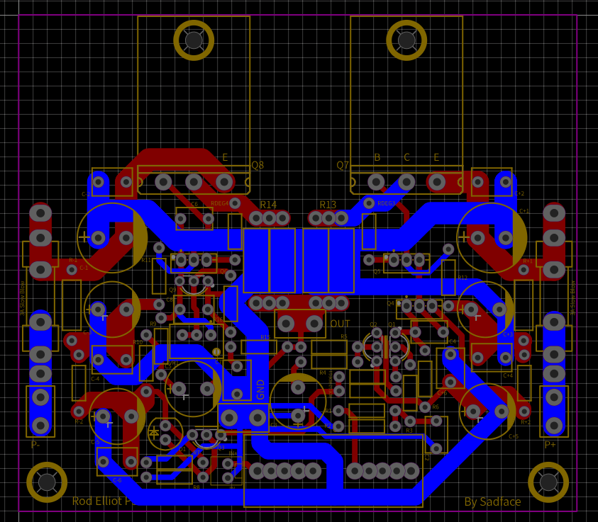

OK I am attaching the top overlay of the pcb the resistors in parallel with the fuse holders are 100R 5W for safe set up purposes without fuses in the voltage rail holders. This strategy has been used in numerous amplifier projects published in Australian Electronics magazines going back at least to the mid 1970's when I built a "Twin 40 Playmaster amplifier - my second power amplifier project. The only trouble I had with this was fitting the wrong value of resistor in the preamp section. The telling multiplier band colour was hard to determine. The second attachment shows the copper pattern. I am not trying to divert attention from the P3A in posting these images but with the thought they might inspire/help Sadface in his objective to design a new pcb for his P3A.
One thing you will see is that sticks out is the location of the Vbe transistor free standing with small air gap between this and a reflection of the front face of that transistor on the heat sink shiny side. Since Class A amps run hot this is understandable however there is a large heat sink for P3A where the Vbe transistor is tied to a driver if so why is there a need for such a large heat sink?

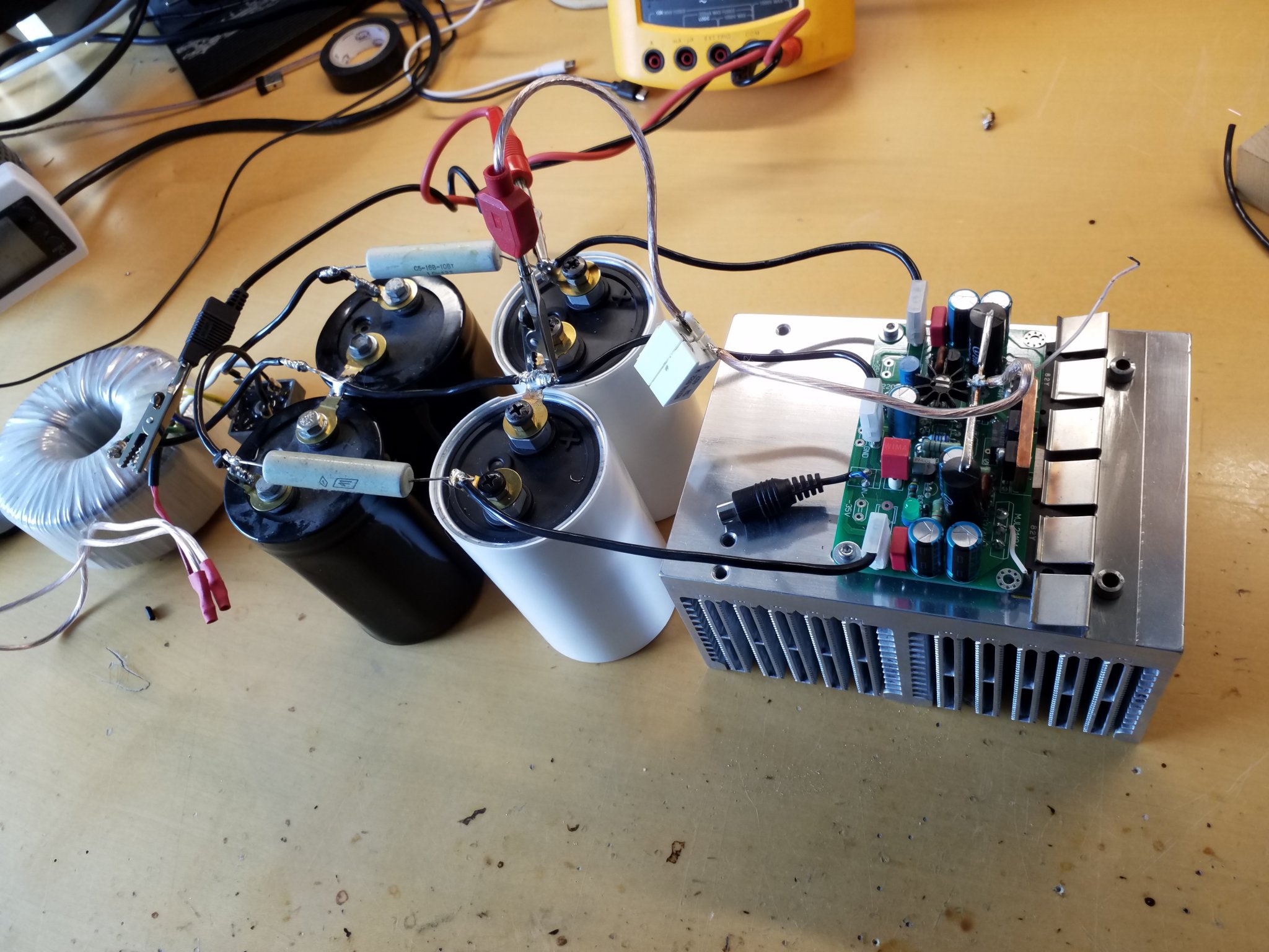

I've tried with crc today and will also try chokes.
Ps nice boards sadface I like the 10r ground and degen resistors, a group buy in future?
Pps nearly wetted my pants earlier, a ground crocodile clip hit the plus bus bar, jesus, 150000uf discharge

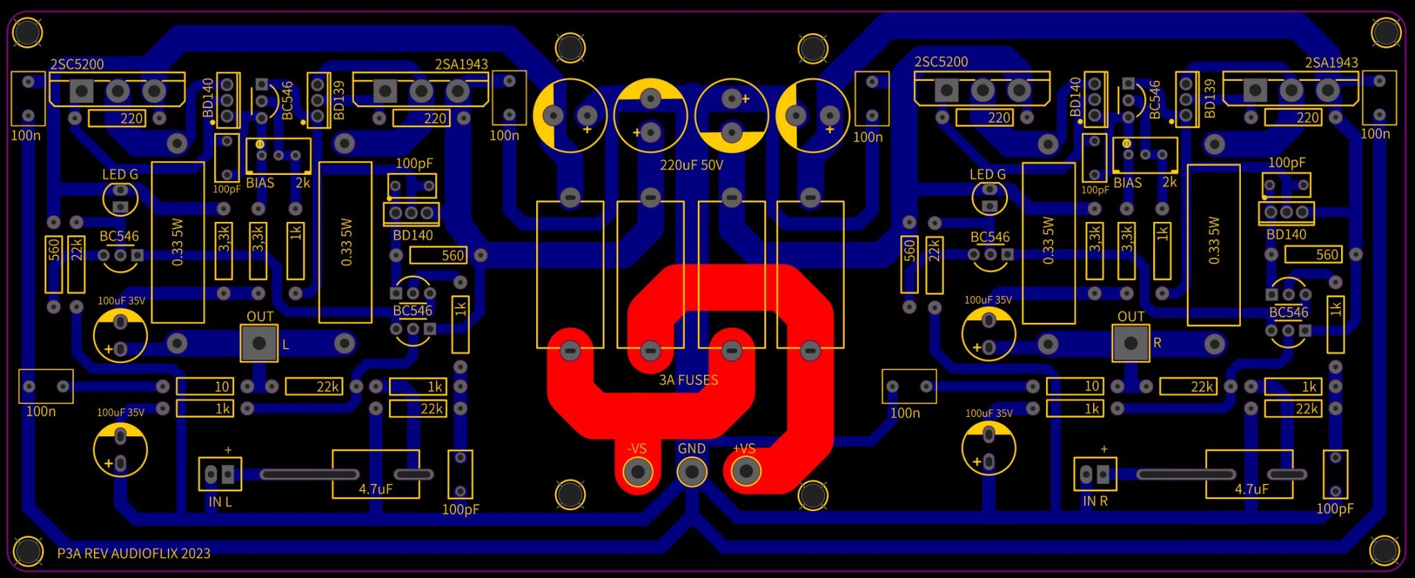

Interesting the way that the power rails are separated before the fuse so the fuse only goes to the outputs, I've not seen anything like that before.OK I am attaching the top overlay of the pcb the resistors in parallel with the fuse holders are 100R 5W for safe set up purposes without fuses in the voltage rail holders. This strategy has been used in numerous amplifier projects published in Australian Electronics magazines going back at least to the mid 1970's when I built a "Twin 40 Playmaster amplifier - my second power amplifier project. The only trouble I had with this was fitting the wrong value of resistor in the preamp section. The telling multiplier band colour was hard to determine. The second attachment shows the copper pattern. I am not trying to divert attention from the P3A in posting these images but with the thought they might inspire/help Sadface in his objective to design a new pcb for his P3A.
It makes sense since there shouldnt be multiple amps going anywhere else.
The grounding layout looks very similar to mine: power ground around the outside and signal grounds all collecting at the central GND connection.
Is the relevant detail here the central high current ground trace?
It does follow the idea of connecting the positive and negative before connecting to the star.

Happy it was a small metal one that snapped at me, I'm no steve irwin, chassis is ready but still trying out various power supplies, until now the crc with 47000uf after rectifier then 1 ohm and 100000uf is not bad.
Yes I know its overkill, but had them already.
Will try a pair of chokes later, instead of resistors, 15mh dc resistance 0.2.
Also pulled out the wima 4.7uf input cap and replaced it with a Russian type k73-16 1uf 400v, sound stage feels deeper.
Lots of fiddling to do..

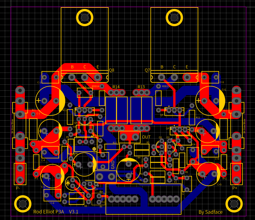

OK,
I think I have managed to keep the extra rail decoupling and fix the grounding.
The input cap was changed to 13mm width to fit a Wima MKP4 4.7uF
R13/R14 changed to be 3x 2W 1R carbon film resistors.
I also added the extra pads to solder in the safety resistors over the fuses as I really like that idea.
