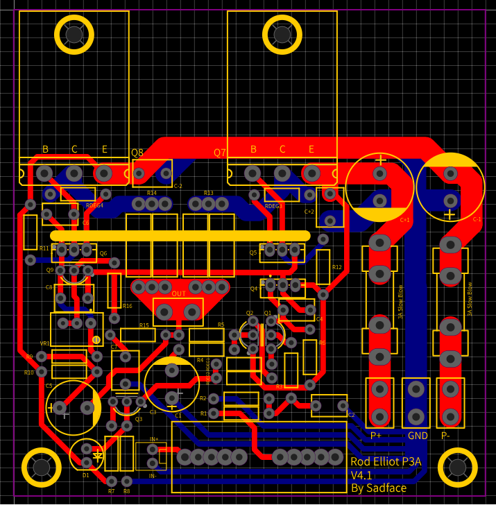

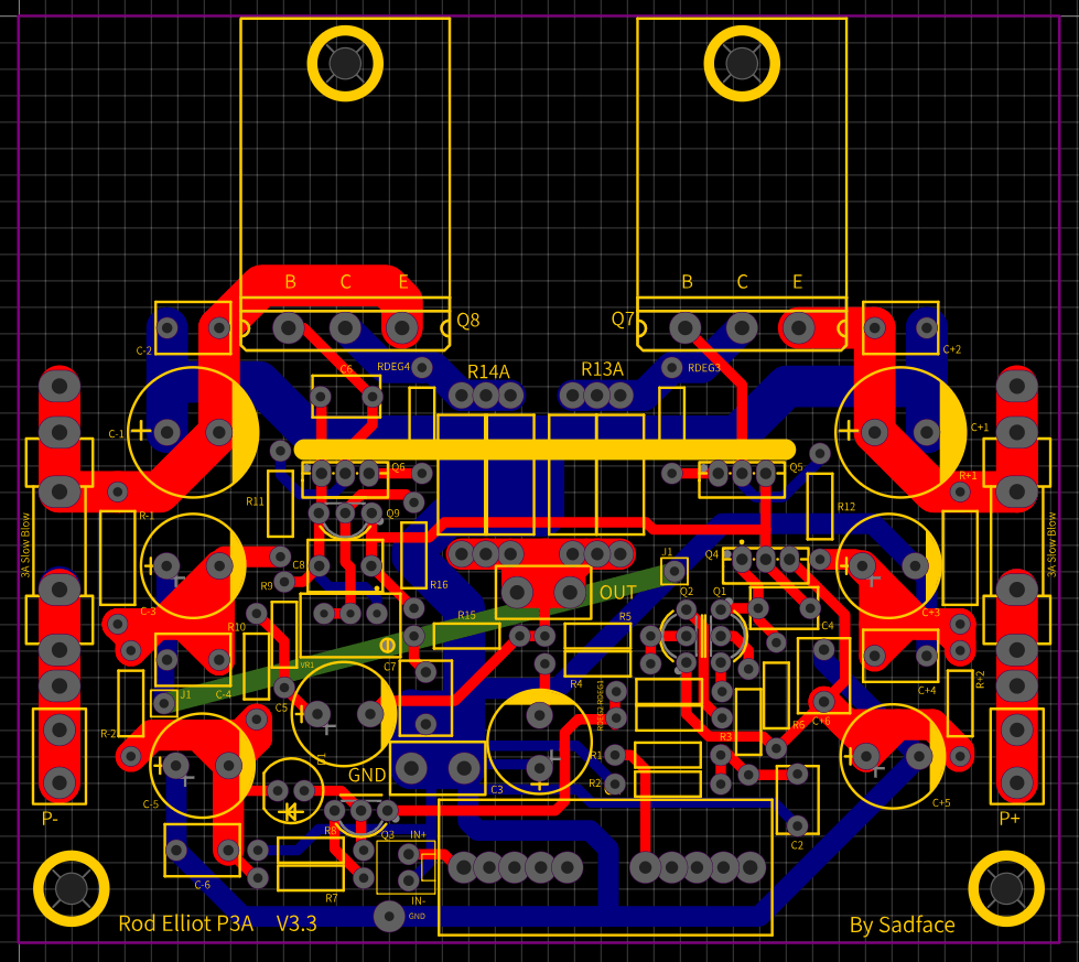

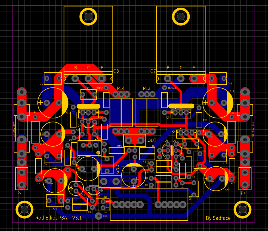

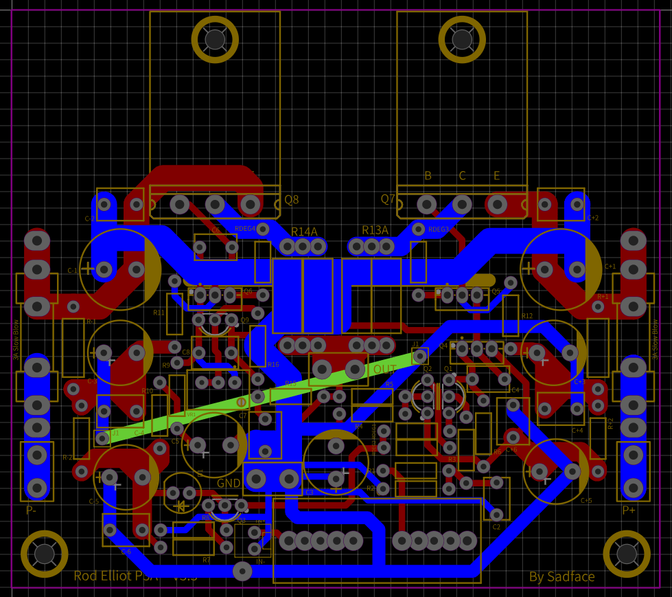

I figured out how to get the driver stage decoupling ground trace from the positive rail to the star separate from the output stage ground trace.
However I can't figure out how to resolve the negative rail with the positive rail separate from the star.

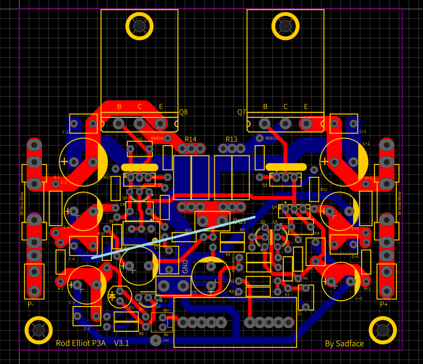

The best I can come up with is to use a jumper like this:
This would allow me to resolve positive and negative grounds from the various decoupling stages separate from each other and still keep all the signal grounds separate too.
I have also indicated in yellow where I will place a heatsink across the 2 drivers. My plan would be to cut some 2mm aluminium with a cutout to go over the top of R13/R14 so that the 2 drivers are on the same heatsink. My plan would also be to drill some holes to either side of Q6 so that a cable tie can still be used to thermally couple Q9 to Q6 as Rod recommends.
The other option would be to do as John Ellis suggests and use a BD139 for Q9 with some flying leads so that it could be bolted directly to the driver heatsink. Or plausibly with a lot of rework on the layout, Q9 and the trimpot could be mounted in between R13/R14 so that it is mounted in the centre of the driver heatsink; equidistant from the 2 drivers.
Oh I also added an extra hole on the ground trace at the bottom as an easily accessible test point. I figure that the holes added for the safety resistors on the fuse rails serve the same purpose as test points.

Not recommended. You want the junction of the bias transistor as close as possible to the drivers junction to thermally track it with as little thermal lag as possible.Or plausibly with a lot of rework on the layout, Q9 and the trimpot could be mounted in between R13/R14 so that it is mounted in the centre of the driver heatsink; equidistant from the 2 drivers.
I have revisted the simulation I posted on the other thread about linearising the P3a. I did not look at changesto the LTP.One of the advantages (perhaps the only?) of a CFP design is that the quiescent current can be held remarkably constant because of the local feedback which excludes the Vbe of the output pair.
For this to work well, the drivers and bias regulator need to be mounted on a small heatsink together. That means insulating the heatsink, of course, and using a BD139 for the bias regulator which can be easily mounted with its mounting hole.
It is also better to keep the drivers running cool and putting small heatsinks on them. In the past I have mounted the bias regulator underneath one with one of the drivers on top. The heatsinks are small 20x20x20mm finned types. The insulator was between the bias stabiliser and heatsink so that the driver had direct thermal contact as did the other driver.

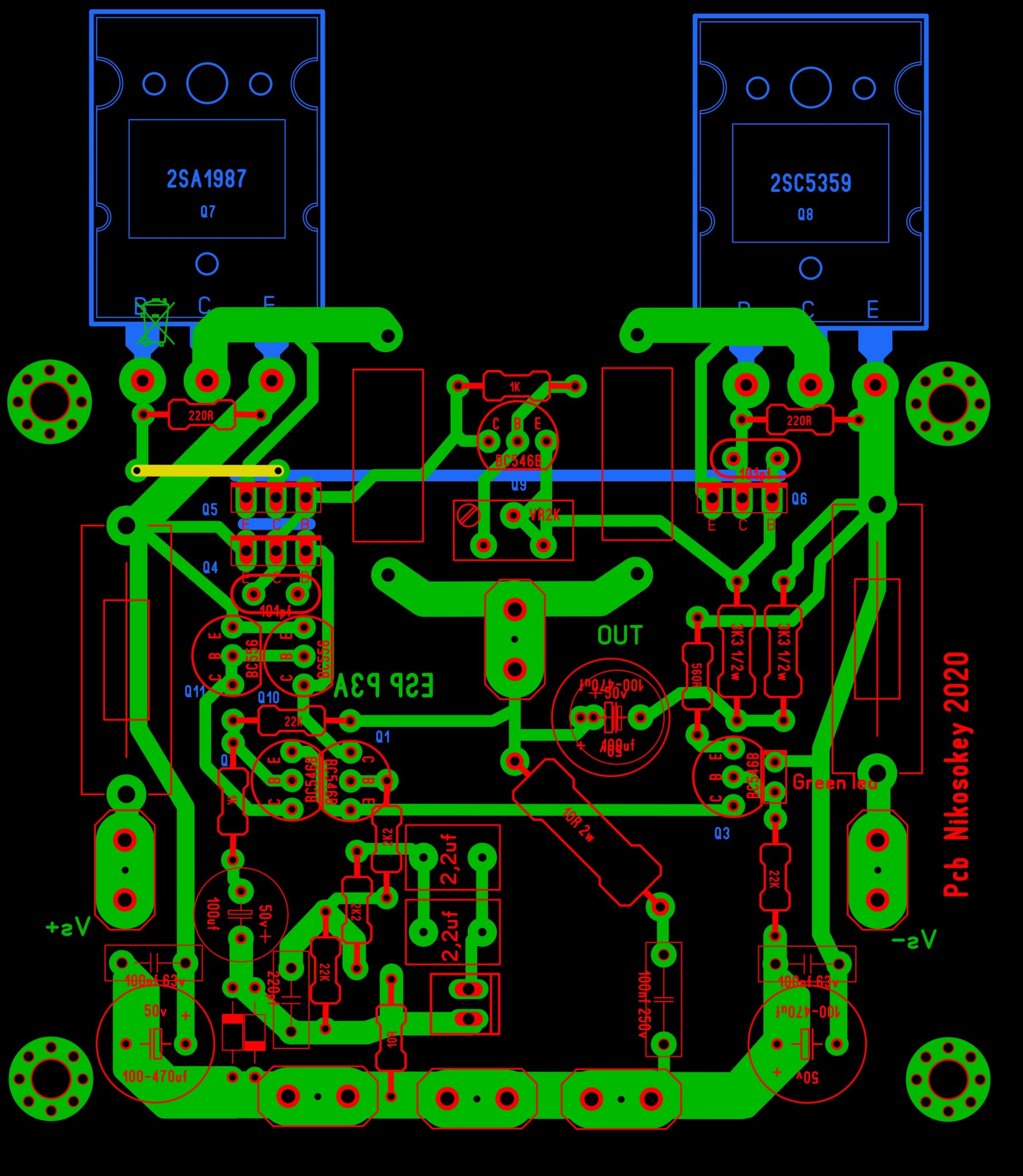

Not sure if this will help resolve the layout questions, but the best tool to use is to analyze where current flows. Keep in mind that the charging currents for the filter caps are rather nasty haversine waves, flowing only at the crest and valley of the AC power cycle. The return trace should be considered as a series of small value resistors. Current flowing across these resistors creates a voltage drop. You don't want the more sensitive circuits positioned such that different components are at different points along the voltage drops in the return path as this induces the voltage drops into these circuits. This is why the ground "star" is helpful, as long as the star itself is not part of a high current path. And yes, it is complicated. The PCB layout is really a "component" in the circuit.

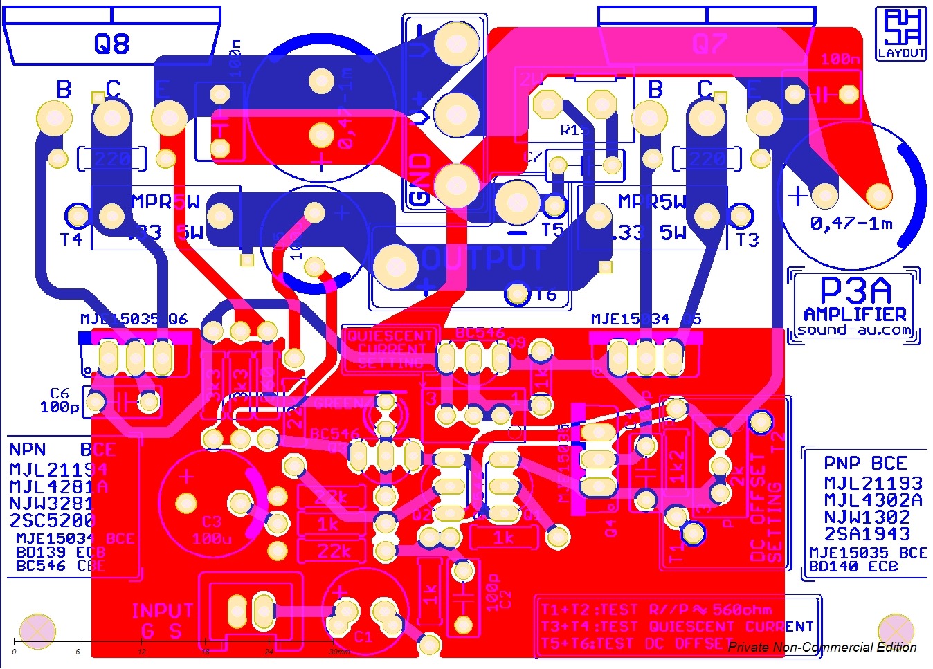

A few months ago I made pcb for this amp out of curiosity (according to the original scheme).
Trafo 2x20V 300VAC, 2SC5200+2SA1943+MJE15035/34 from Mouser. Other elements are standard 1% Beyschlag resistors and caps from Panasonic/Rubycon/Nichicon.
DC offset after +-20min warming was 13 and 15 mV. Thanks to helitrim (2k) I added in parallel to R6 (1k2) i set it up to 0V.
Q5 and Q9 coupled with a piece of copper sheet.

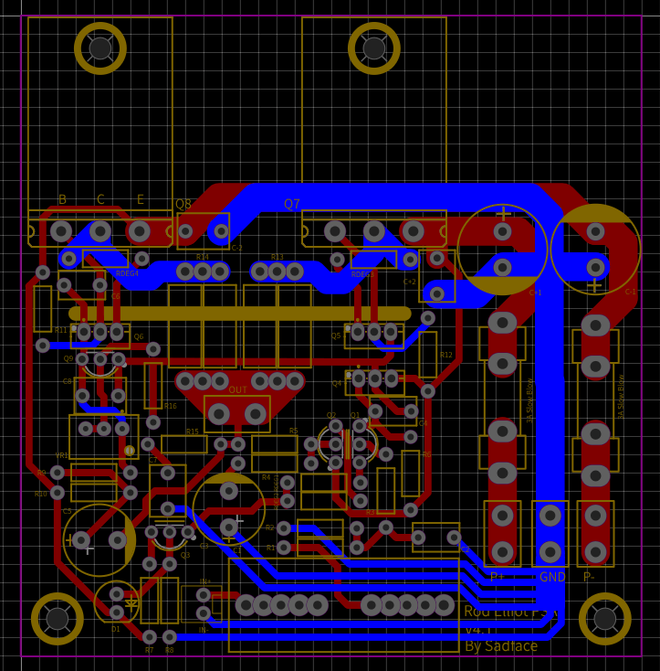

Ok guys, according to the track and trace, I should have BD139/140 by Friday.
While waiting, I've been fiddling with the layout some more. Since the previous layout seemed to not be preferable, I've gone back to basics.
I've chopped off the the extra decoupling stages and gone back to a plain old Rod Elliot style layout.
This is pretty darn similar to Rod's layout however he biggest difference is the extra degen resistors, the larger input cap, larger diameter decoupling caps.
I understand that Q9 should be mounted as close as possible to the Tj of Q6 which I would take to mean the metal tab side of Q6.
However I of course want the metal tab side of Q6 on a heatsink.
Am I over thinking this, should I just be cable trying Q9 to the 'front' side of Q6 and forget about it?
