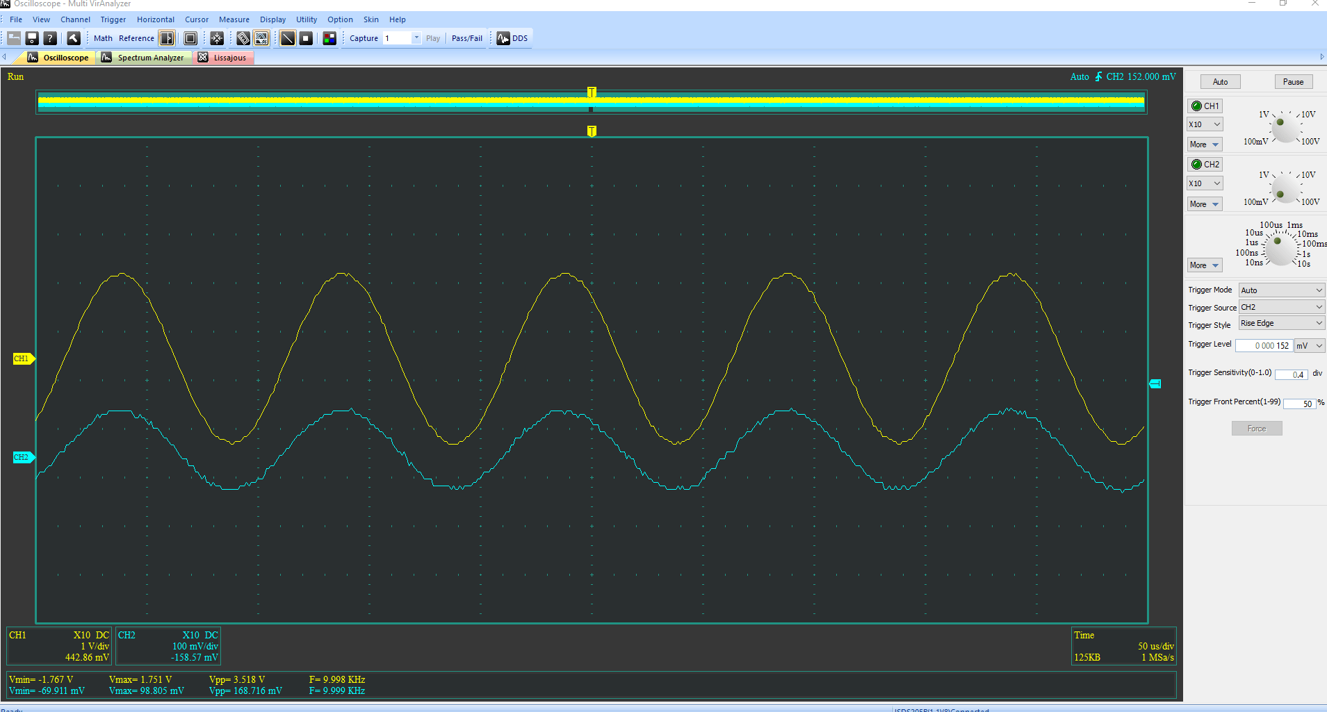

G'day Guys,
Last night went well. By using my usual stereo system as the sig gen. My sine waves now look much cleaner.
I used a 1kHz/10kHz sine wave as a .wav file. Using the volume control in FooBar to get the signal to the normal level I test at.
RCA cable was used straight from the output of my dac directly into the amplifier.
4R
4R + 47nF
4R + 470nF
4R + 2.2uF
Not only is the sine wave looking clean but it is looking stable with up to 2.2uF in parallel with a 4R load.
All going to plan, tonight I will try some more square wave testing with capacitive loads.

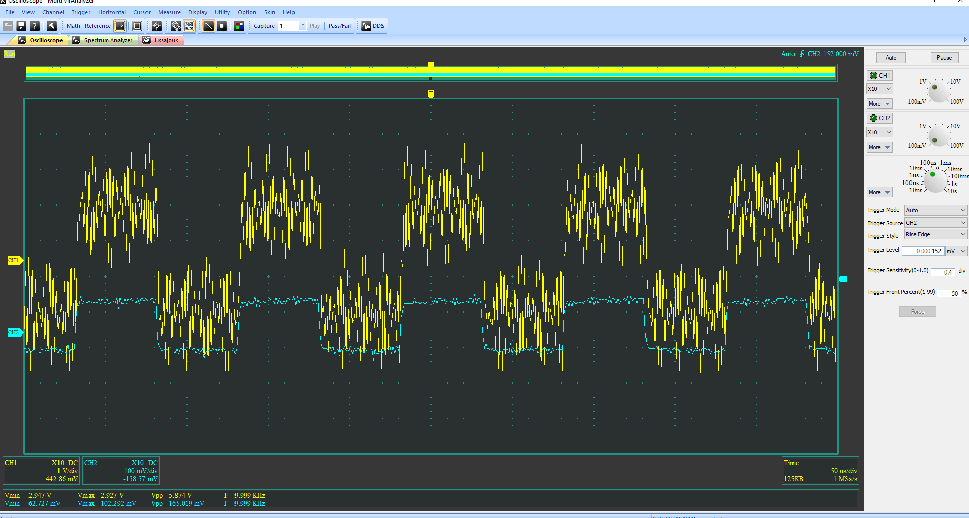

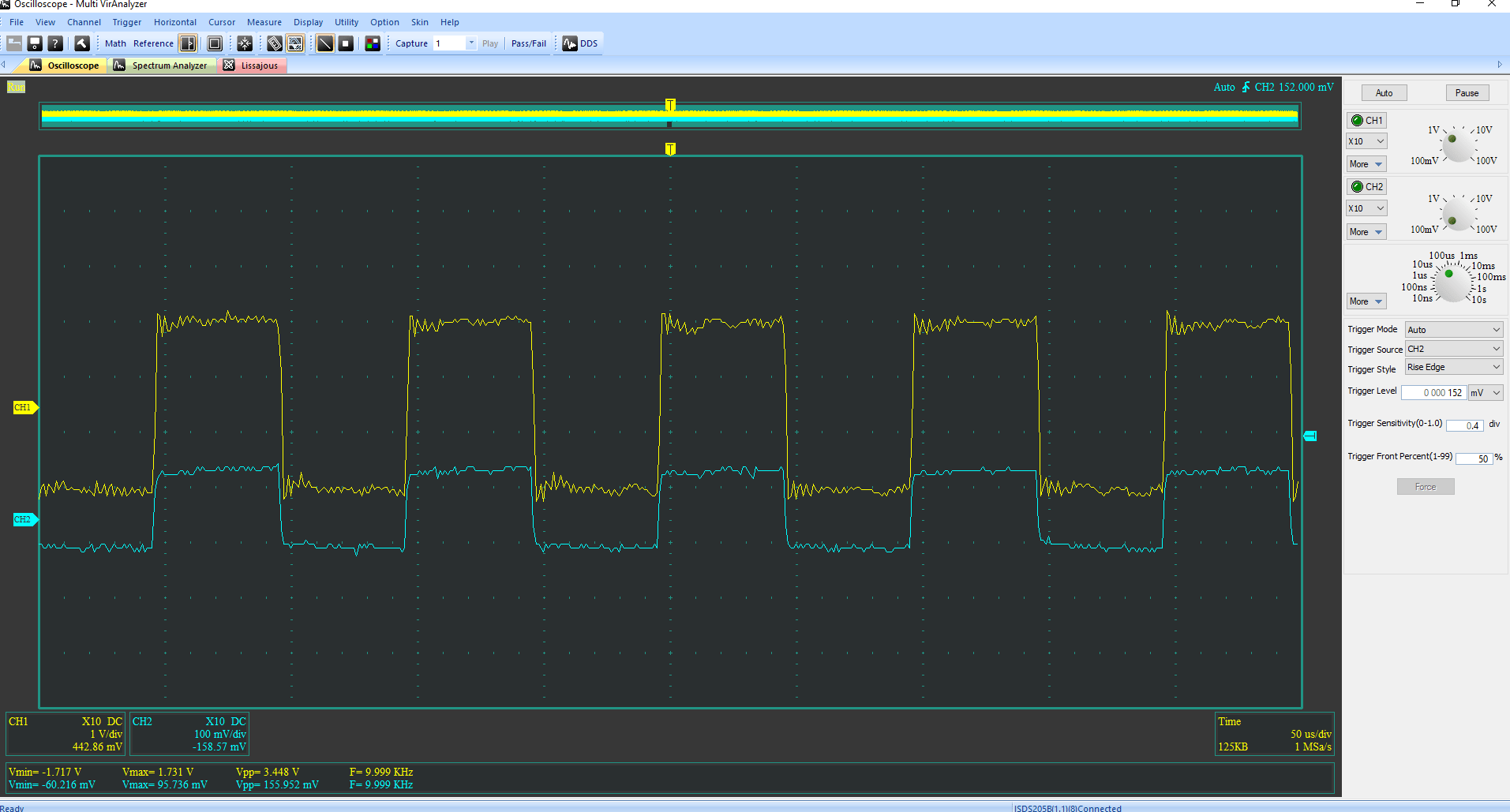

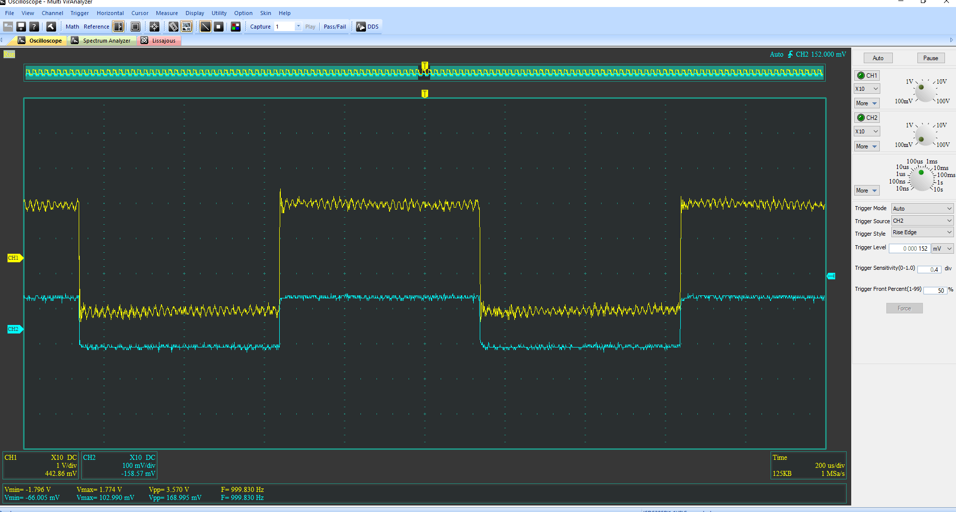

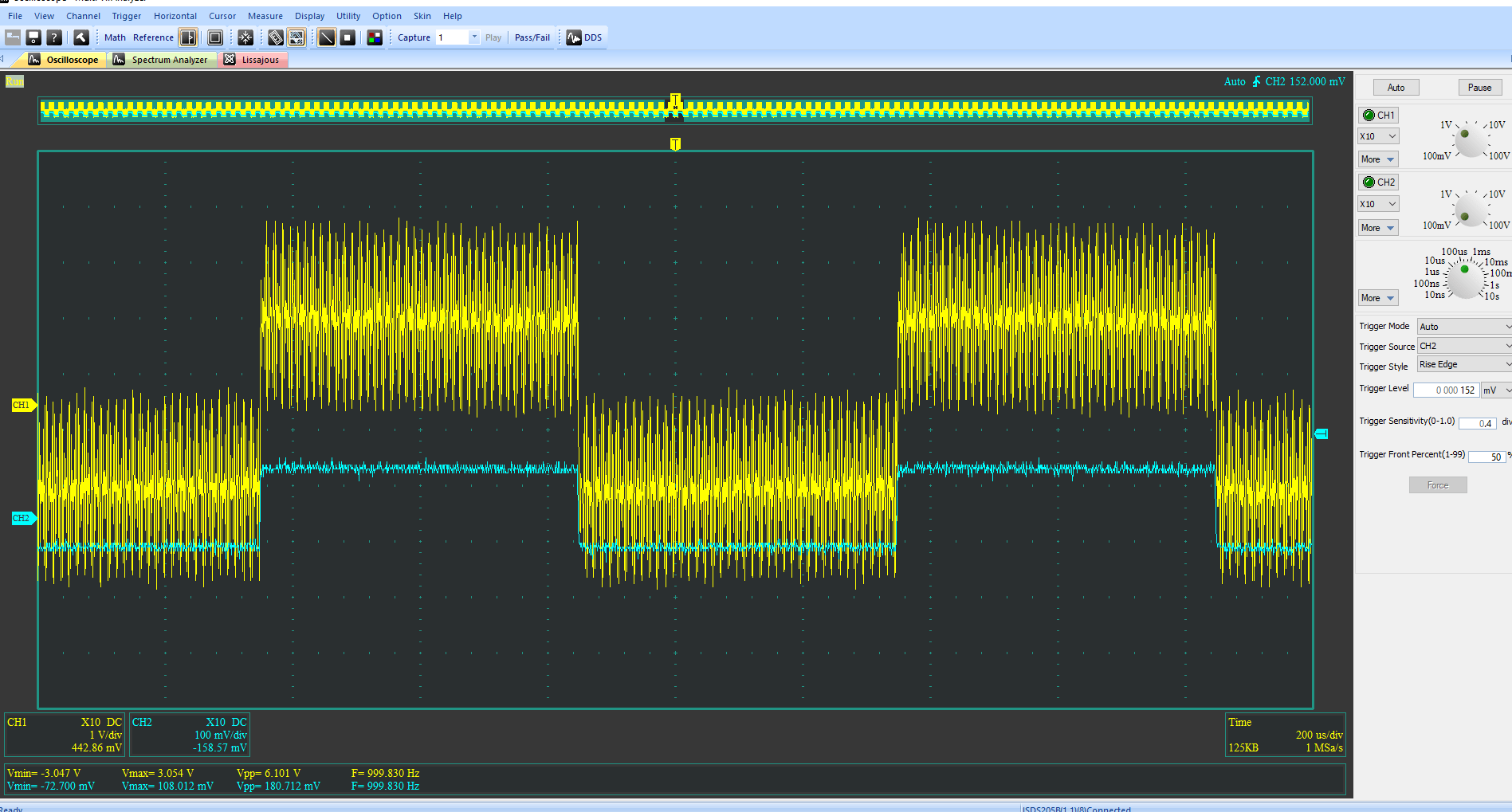

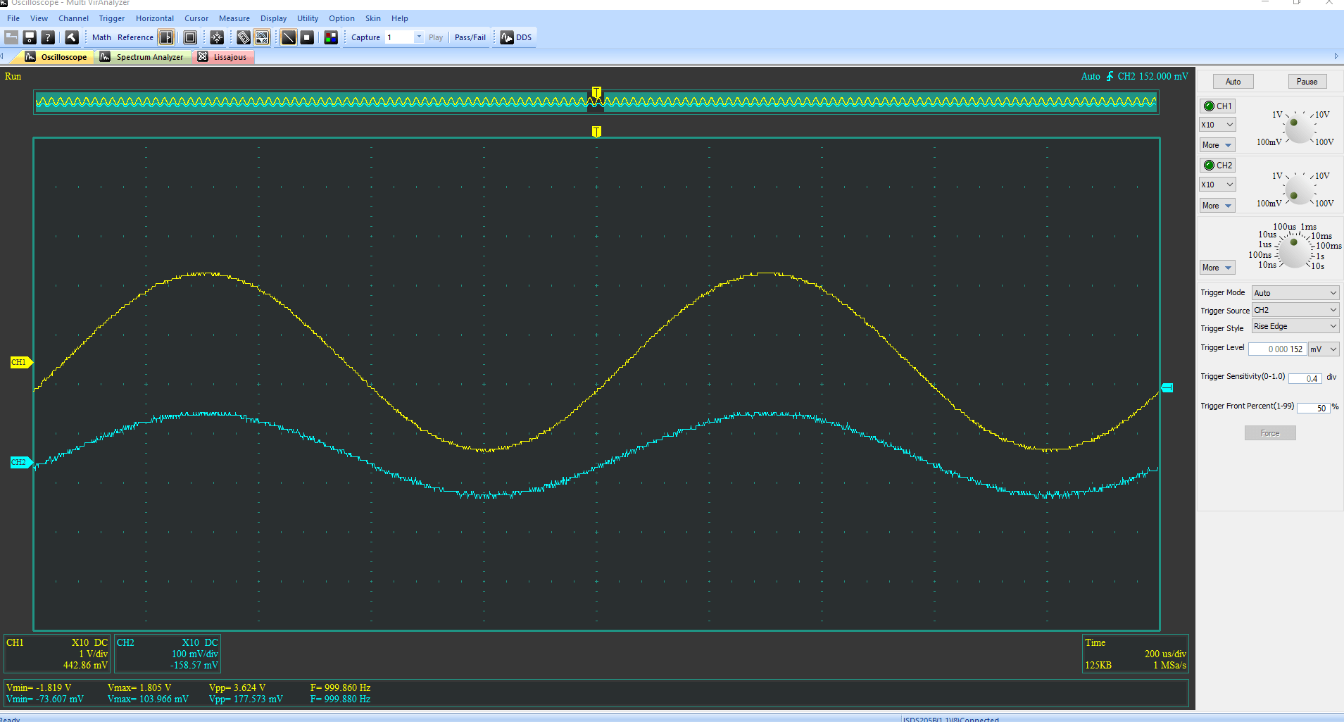

G'day Guys,
I've been doing some square wave testing.
My conclusion is that the amp is unstable producing squares waves into a load of 4R and greater than 100nF of capacitance in parallel.
4R + 47nF
A little bit of overshoot but it recovers quickly.
4R + 100nF
Same thing, a bit of overshoot but it recovers immediately.
4R + 150nF
Oscillation!
The peak voltage of the oscillation gets worse as I increase the capacitance.
So the question is: What is an acceptable margin for capacitive loaded square wave testing?
Given that the amp had no issues with 4R + 2.2uF on sine waves.
I would think that square waves into 4R + 100nF is a pretty tough test to pass.
It seems to me like I can call this amp stable and continue on with finishing the build.
However I am just an idiot on the internet so I ask the members with more knowledge, experience and wisdom than myself: Is this an acceptable margin of stability?
