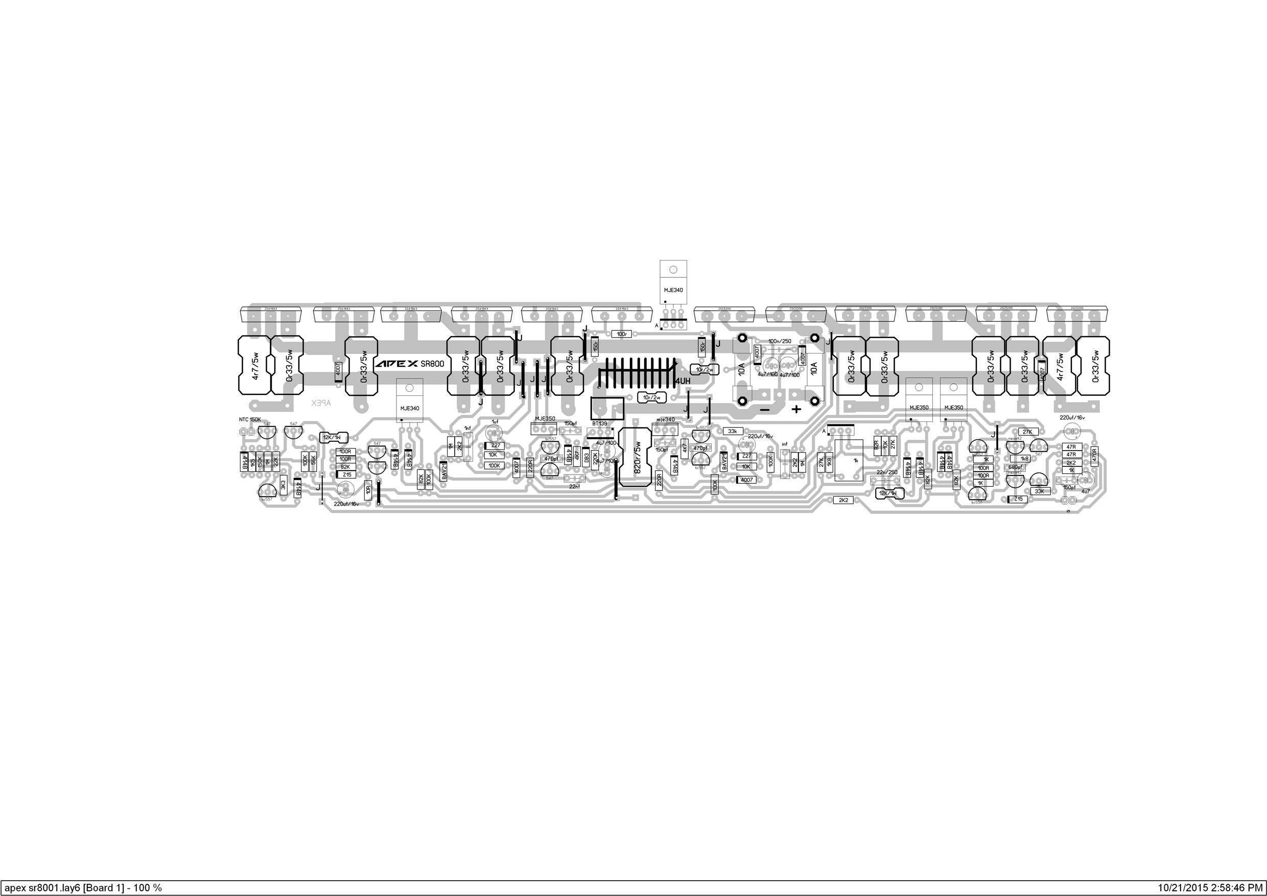

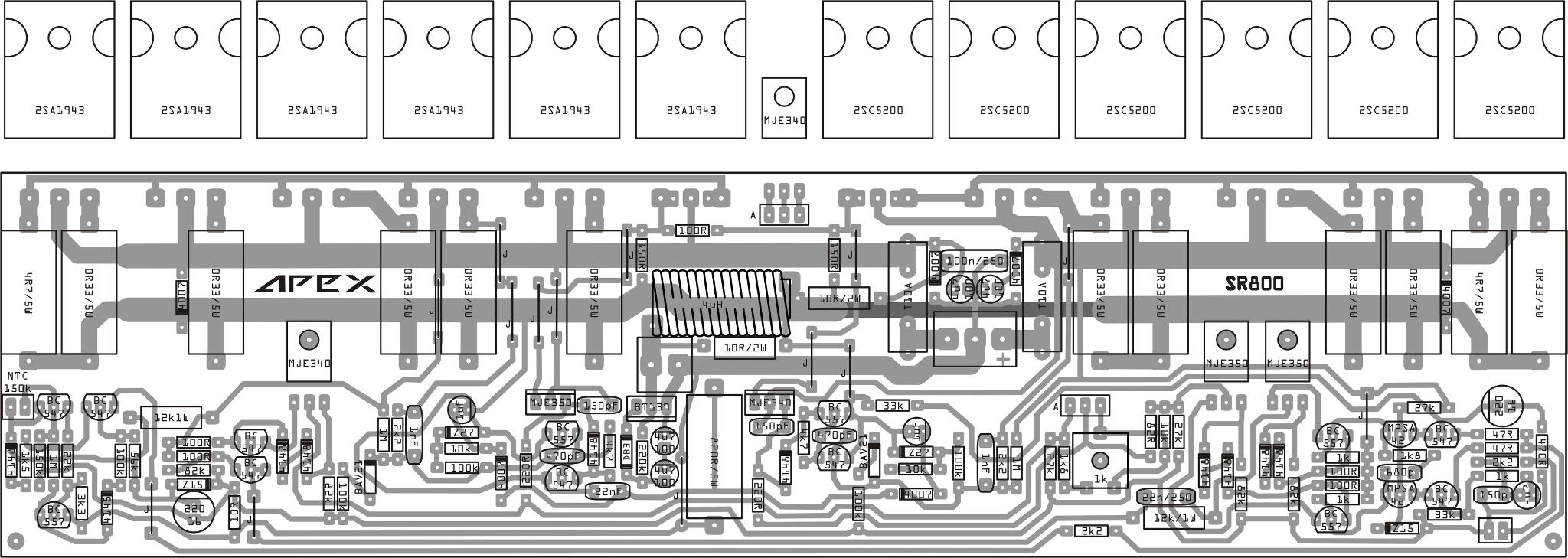

Hi all.
I'm trying to make psu of sr50
but It's my first time making amp
and there's something I need your help
1. i see two 2SC5200 in schematic
but there's only one in pcb
is this pcb wrong? or is this ok?
2. and.. what is that 2k2 resistor tie to MPSA42//MPSA92 ?
just simple resistor or something else?
i don't know what to buy..

hi apex sir is this working i want to make this amp. i will make pcb if you don't mind.please suggest me sir.thanks.
Hi Rohin,
I have tested it on my local pcb(A different pcb modified) I think its error free and working fine...
Hi Rohin,
thanks mr. kamranyousaf for quick reply.
Anybody who can share this pcb?hi apex sir is this working i want to make this amp. i will make pcb if you don't mind.please suggest me sir.thanks.
hi
mr apex .what is the minimum voltage can be used for this SR200?
+/-35V
