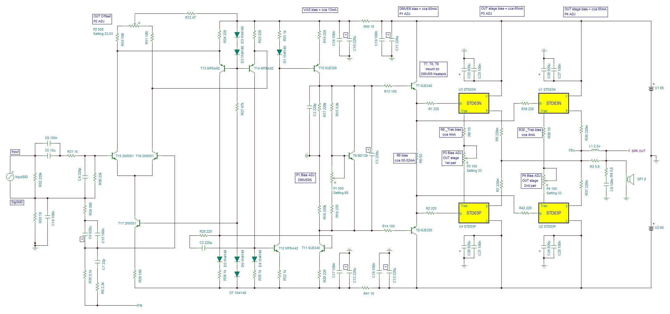

If we plans to make output stage with multi pairs of STD03 to achieve more output power (150, 200WRMS...),
they must be closely matched (pairs) and then we go with step-by-step adjusting pair per pair idle/bias currents
in little alternating steps to obtain bias current 65mADC per output pair,
also drivers needs more current (+30mADC per additional output pair) , bigger heatsink, we need then higher PS...
There will be some interactions in this adjust steps and also we need to check "in-between" to re-adjust the driver+Trak bias to 26-27mADC and 4mADC respectively!
I forgot to mention that each of multiple output pairs need an own multiturn bias trimmer,
so we can precisely adjust even output bias current distribution per output pair (... slightly different darlingtons parameters, Beta, V_formard Trak diodes, R_e...)

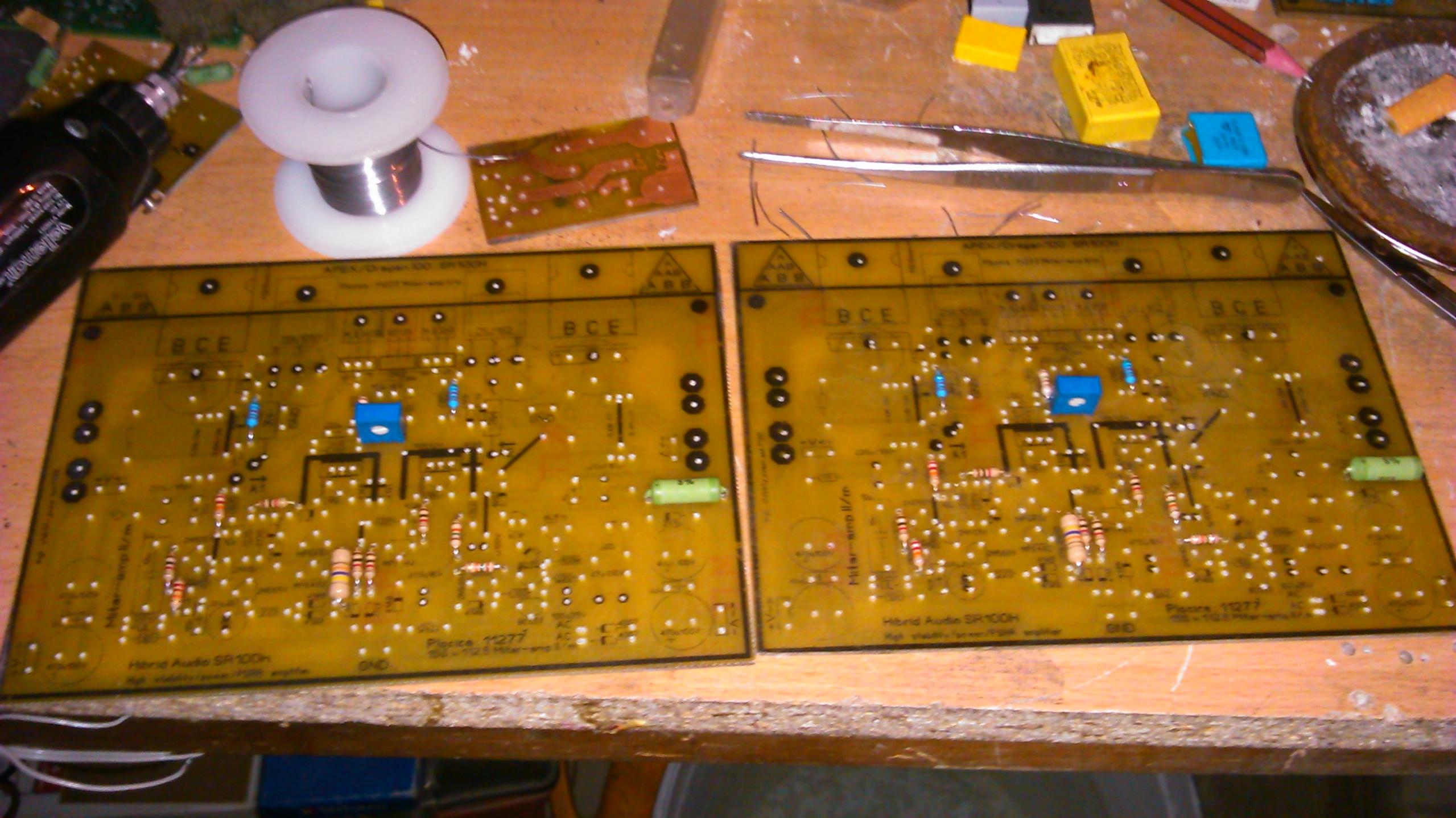

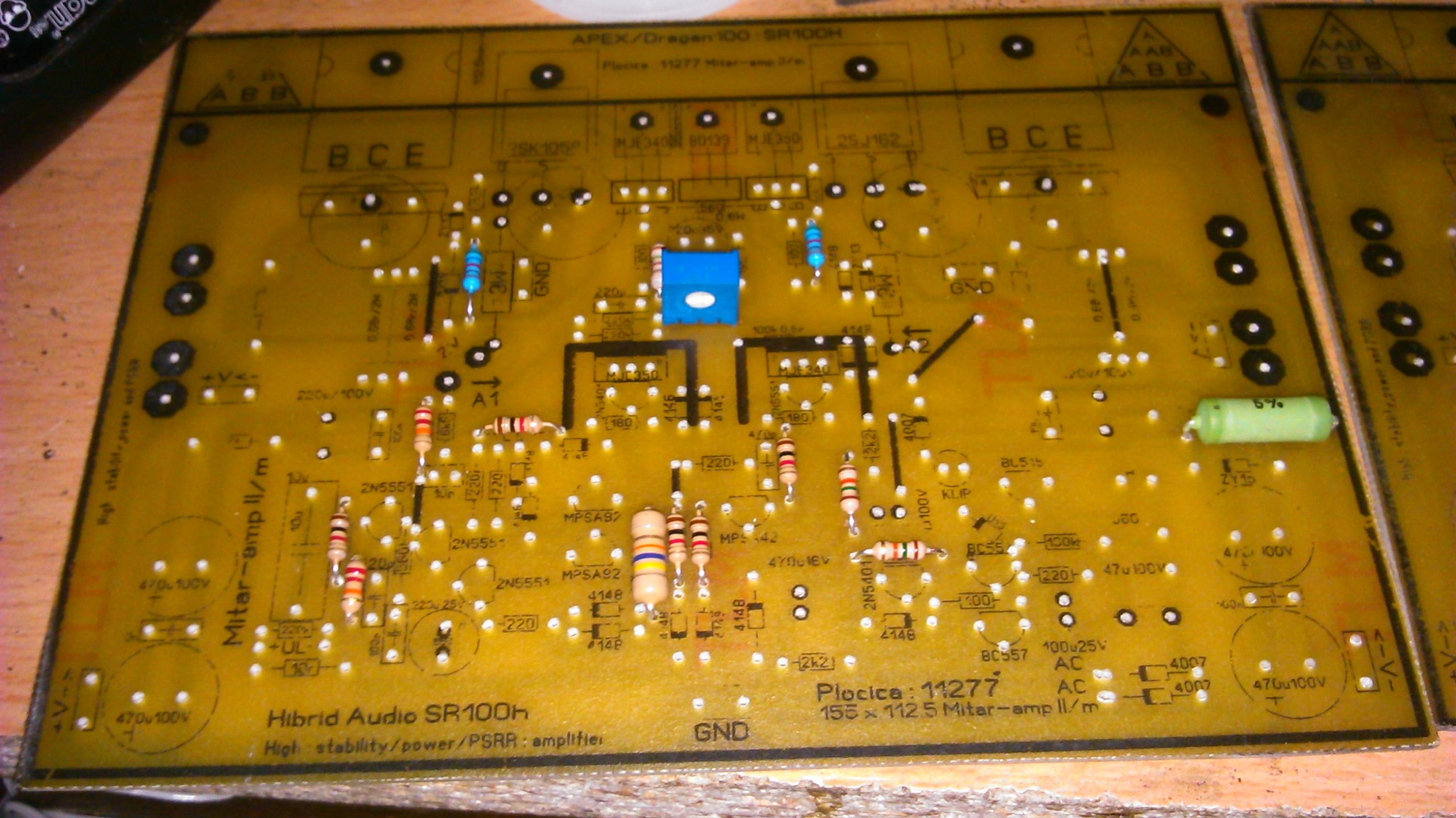

Hi Mr Apex,
I've finished the SR200 with 50Vac input and DC offset is 1mv for both board, I am not test the sound yet, because I want to integrate PSU board to the amp
- I use the 2 x 15000uf/100V for this amp, is that ok?
- The trafo is 50x2vac, 250W, that's enough for this amp?
- That capacitor is screw type, so can you please to help me design the PSU board have terminal with the rail of screw, so that make me easy to connect the wires!

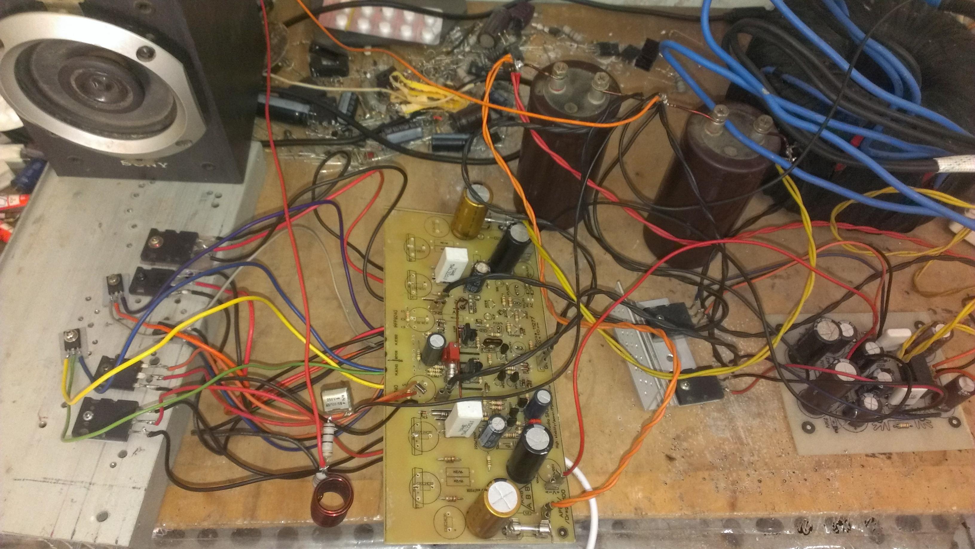

Hello to all!
I want to build 4 chanels SR200 for my custom studio monitors based on 15' tannoys DC drivers (8ohm).
I started my project with regulated psu based on Mr. Mile's scheme.
Here first question: can i use 3 pairs of output transistors to supply two SR200 with relevant transformer about 600-800VA@50vac?

I've got preaty big caps and decide to put em outboard either transistors.
This is a not an issue?
Here is PCB.
Is there any bug on it?
