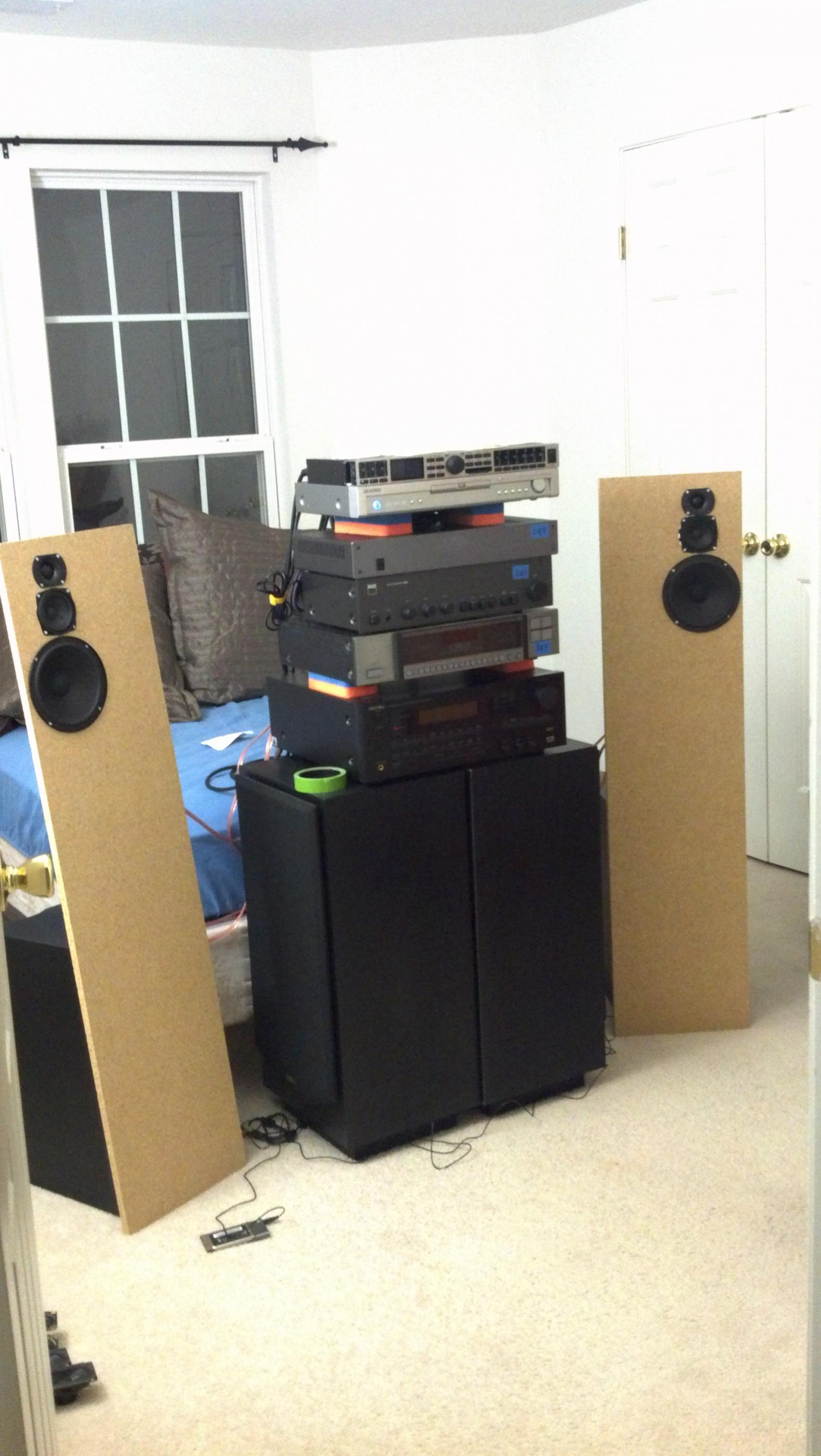

...(see my fancy shmantzy test rig attached)..
If I haven't already.
Greg
Nice rig, Greg
