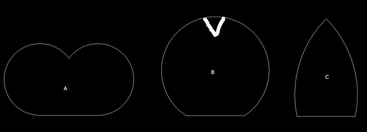

So here's something different. I assume you've all seen the Kuze line array project on P-E. What about taking a hint from that for cabinets? I happen to have access to very large schedule 80 (thick walled) PVC pipe, so I'm tempted to play. I'm worried about standing waves though, even if I divide the pipe into 4 driver (or 2 or individual) chambers. What could be done is to modify the pipe by cutting it and gluing together segments as in A or C (B&W style), or just adding something like L channel or a piece of triangular molding at the back. I have NO IDEA how to design cabinets to reduce standing waves other than irregularity kinda generally being helpful.
I thought about the divider shelves, and I think that grooves in the inside of the PVC can be made with a small rotozip or dremel router attachment and small shelves can be cut from thin plywood (or something less resonant). Maybe throw a few pounds of epoxy in there... Baffles made out of MDF.
I'd bet that a little sandpaper would make piano black veneer really easy to apply to PVC. BTW, I'm sorry about B, I forgot to add the little arrow into Draftsight before JPEGing and deleting the dwg, so I painted it in after. You get the idea.
Greg
Oh that's right, 4-way.
To be honest, I don't entirely see why you want to make things this complex. The table that I made up to calculate combing of drivers based on C-C shows that 10" woofers won't comb until 1351 Hz. That means that even by the more stringent lambda/2 qualification, they're good to the same frequency that I'm using now for the 525s, just not with a 1st order filter. The 525's that I have are definitely only good to about 800 anyway, and actually, despite my success with the Aura 3's running to 7k, they're going to comb again between 4-8k, since 4kHz lambda is in the 3" range. I may end up going back to a 5kHz LR4-6 for the tweeter, depending on how audible the combing is. The whole point of the tweeter was to quell that.
Greg

I break up standing waves in my array box very easily, the back panel has angled wood scraps, the huge amount of wiring, crossover filter boards, fiber fill and braces make it a maze. Not pretty but throwing in braces at all sorts of odd angles really helps that issue.
PVC pipe is pretty cool, it would have the standing waves of....well, a pipe organ.
I thought about PVC but figured it would be a huge pipe to get the bezel attached so scraped the idea. A pipe with just NS3 mids would be a great option if running bass bins. Since cutting the pipe would be a royal pain in the butt, I'd use that really stiff plastic foam and cut discs to slide into the pipe. Compress it a bit, throw some RTV in for a seal and run it up and down the pipe. The foam will stop standing waves, absorb vibration and naturally seal the pipe without requiring cutting the pipe into pieces. If your worried about standing waves inside each enclosure, use bits and pieces of the foam to glue to the back of the pipe to keep it uneven. Put that smelly RTV/foam PVC pipe out in the garage for a week to let it cure.
Another option is that plastic square cross section stuff called fence post. You can get it in various sizes and it would be much easier than pipe to make small enclosures. Get the 5 inch version, cut away a slot 3.5 inches wide down the front so you have 0.75 on each side to attach the bezel? Use some 1/4" plywood to stiffen the back of the enclosure, use the plastic foam blocks to divide it and fill with fiber fill.
