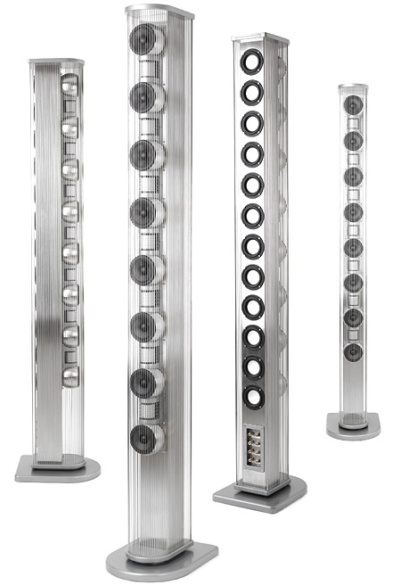

Any comments on the Anthony Gallo Line Arrays from you guys?
Came across these today and like their sleek design.
attachment.php
Quite a different approach on the tweeter placement between the mids....
comb filtering would be about the same as the 25 driver from Owen and the one I am planning to build. Who knows, maybe one of you will visit CES and give these a listen (if they are there, they were in 2008).
They sound horrible, I would stay away. Comb filtering is plainly evident, plus the interposition of the mids and tweeters make it worse if anything.
And there is no low end to speak of. I had heard them in a showroom that was about 300 square feet (should have been enough).
Finally, that grille in front is made of thin, and weak steel rods. They jangle (no kidding).
