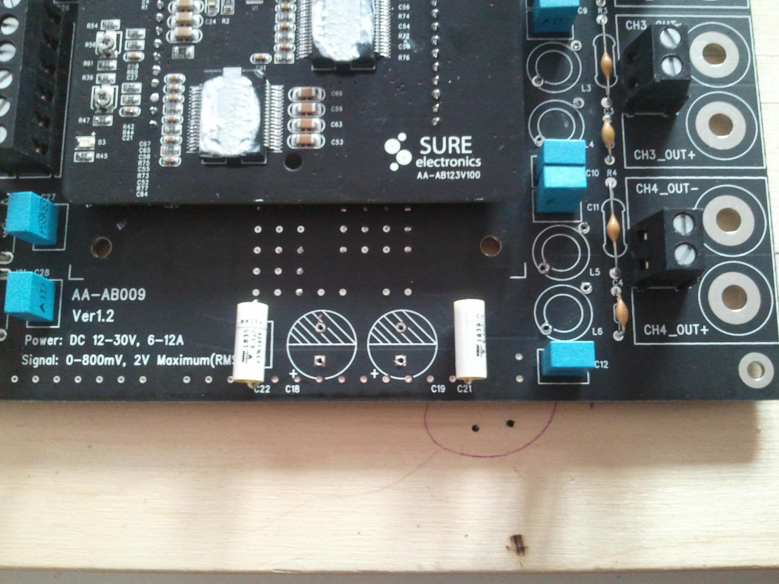

I too have purchased two of these boards and started modding them slightly. I intended to replace the input capacitors, among other things ofcourse, but was wondering if it would be possible to just remove them all together?
Thing is, they'll be used as poweramps for a 8 channel dsp amp where the signal will be fed bij two minidsp boards wich already got pretty decent 470uF Nichicon Muse output capacitors.
Annyone tried such a thing yet? Can't get less signal alteration from the caps then by removing them altogether i thought 😀.
Greetings, Reinder

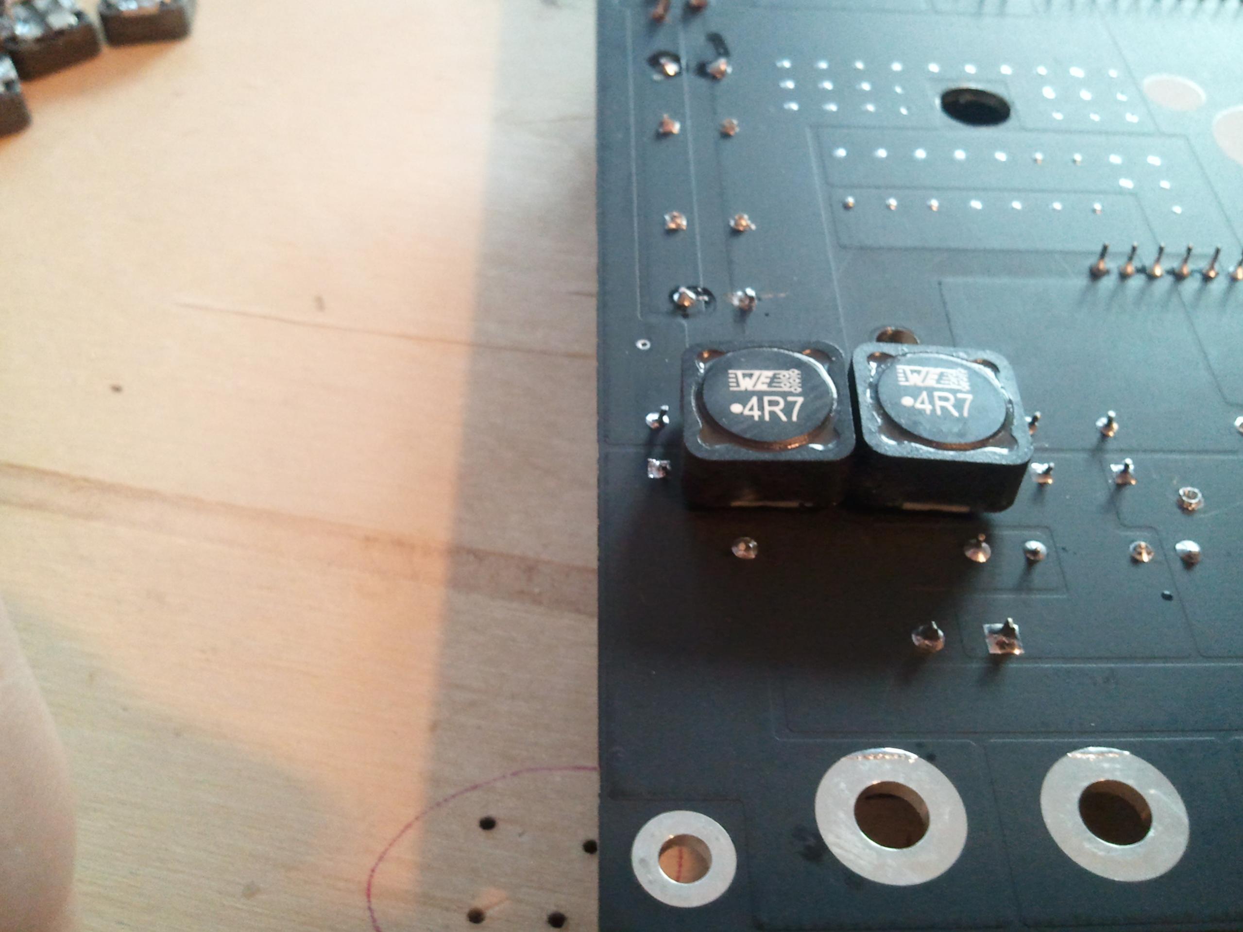

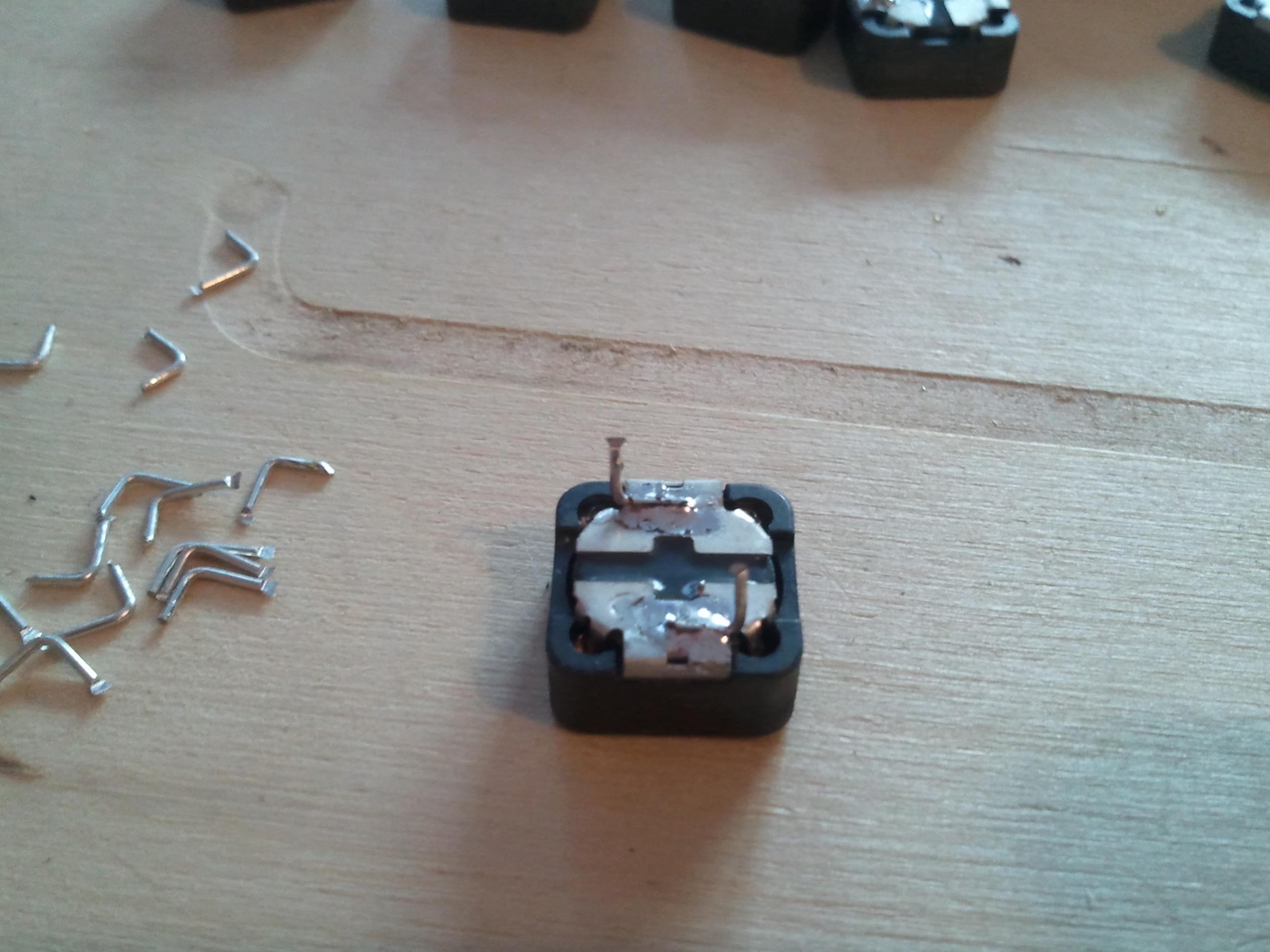

And some pics of the work in progress. Replaced the buffer caps with Rubycon ZL 1800uF & Vishay 1839 0,1uF bypass. The inductors with Wurth 4,7uH shielded smds parts, had to solder legs to them for easy through hole mounting and mounted them on the back of the board because there's more space there. Shorted the resistors for the dc Offset part of the board. Still have to replace the caps for the low pass filter with WIMA mkp4's and then'I'll probably leave it at that for now, possibly add some Clarity Caps as input caps if the experiment with no input caps isn't satisfactionary.

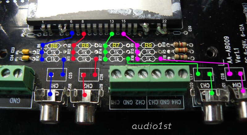

Since the information about these 4x100 boards is very disperse I will put down a list of mods I've done to my board.
MODS ON THE MOTHER BOARD AA-AB009 v1.2
Tank caps:
- Replaced tank caps with Panasonic FM and FC caps by 1000uF>1000uF>100uF>10uF>1uF . I've made new holes onto the pcb to accommodate the new caps.
Input
- Replaced input caps c25, c26, c27, c28 with mundorfs mcap 450v 2.2uf bypassed with 10000pF polyestyrene .
- Removed the resistors ; r10, r13, r6, r11, r12, r8, r17, r14, r7, r16, r15, r9 and connected the inputs directly to their respective pins on the daughter board. Take a look here
* Pay attention that by doing this mod the MAX input signal the board can take is 2000mV !
-Replaced c15 and c20 with wima mks2 63v 0.1uF
-Replaced c24 and c23 with wima mks2 63v 1uF
149886d1260526616-sure-electronics-new-tripath-board-4-100w-class-d-amplifier-board-sure4x100in.jpg
- ch1 to pin 6
- ch2 to pin 8
- ch3 to pin 13
- ch4 to pin 15
If you want to use the input terminals (not RCA ) after that mod you should provide their path with input caps !
Output filters
For low pass filter I have
- L= 6.5uH ( selfwound 16AWG air coils )
- C= 0.68uF (RIFA PHE426 0.68uF 15 legspam 15mm. I made new holes on the PCB to solder )
Zobel High pass
- R= 10 Ohms 4W MOX
- C= 0.47uF RIFA PHE426 250v.
You should have a reading here and simulate here
