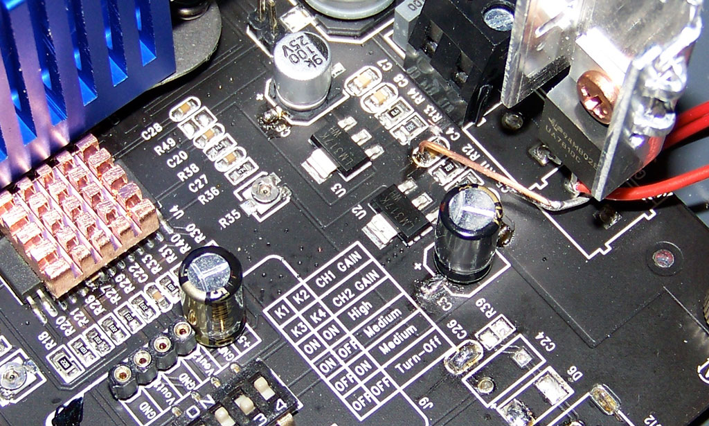

Hi there,
latest PCB have the slots for Sure's volume control. 2 pins are on the 5V line prior to the TC2000 and TP2050, a good place for a cap, as the post reg cap is now far away from the ICs. You can choose or just try caps in the pins (plug it off !) or remove the pins and solder it through holes.
My speakers are nice but not the best, and I've added a 10V reg before the LM317 so can't tell what impact the most, but I feel there is an improvement in mids clarity. I've put what I have in hands, a 100µF FM close to pins (and in fact very close to the TC2000) and a 330µF FM post reg. Anyway, with the "in pins try", you can check and flavor to the best sound, free of solder!
