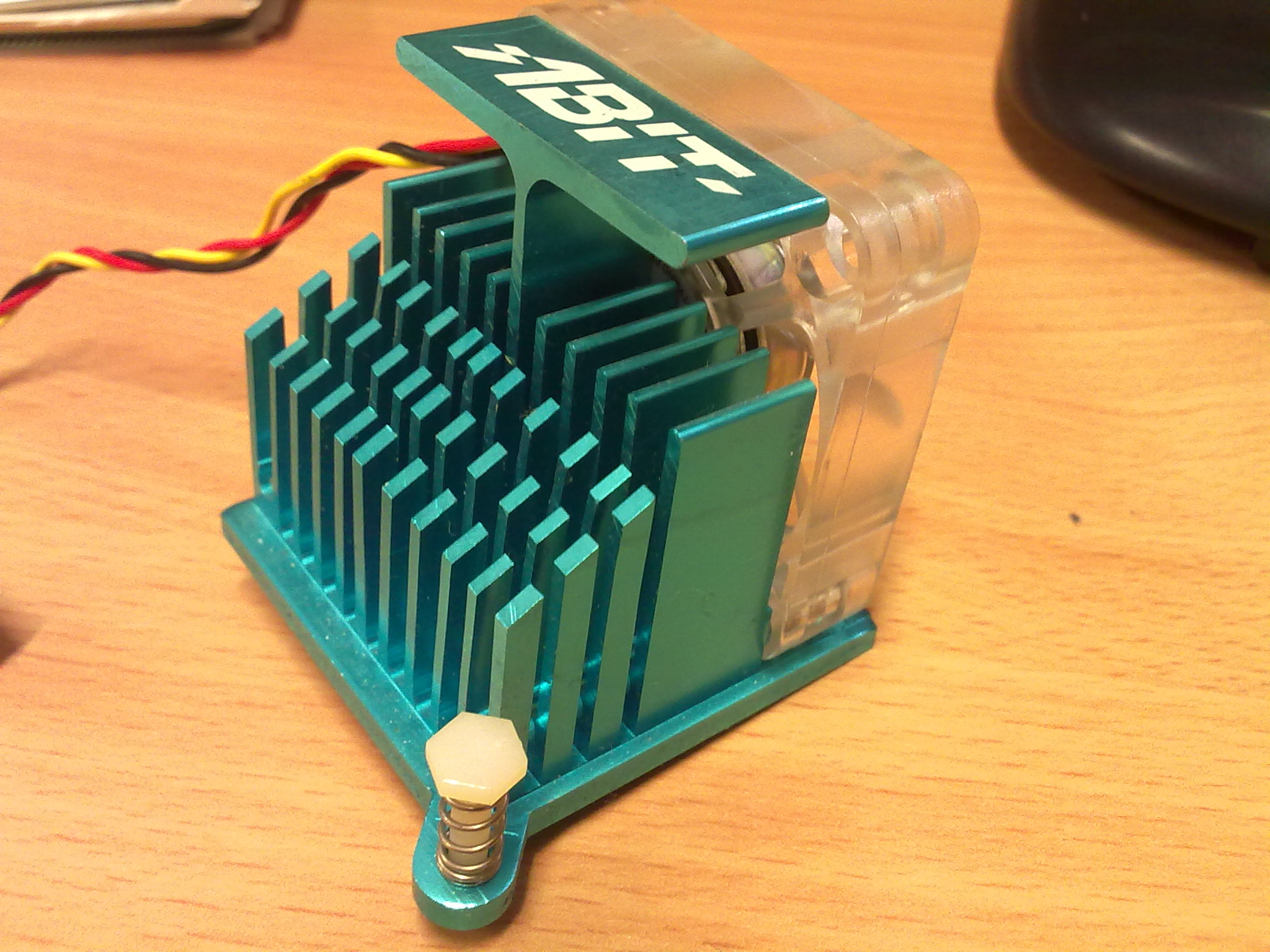

i found a nice cooler fan !!
I will put this one on my board.
It can cool the inductors easily too.
Here is the link that i bought it from :
http://stores.ebay.ie/coolerfanshop
By the way, i'm not related with this seller. I think it is a good solution against the crap quality "Sure" is using.
