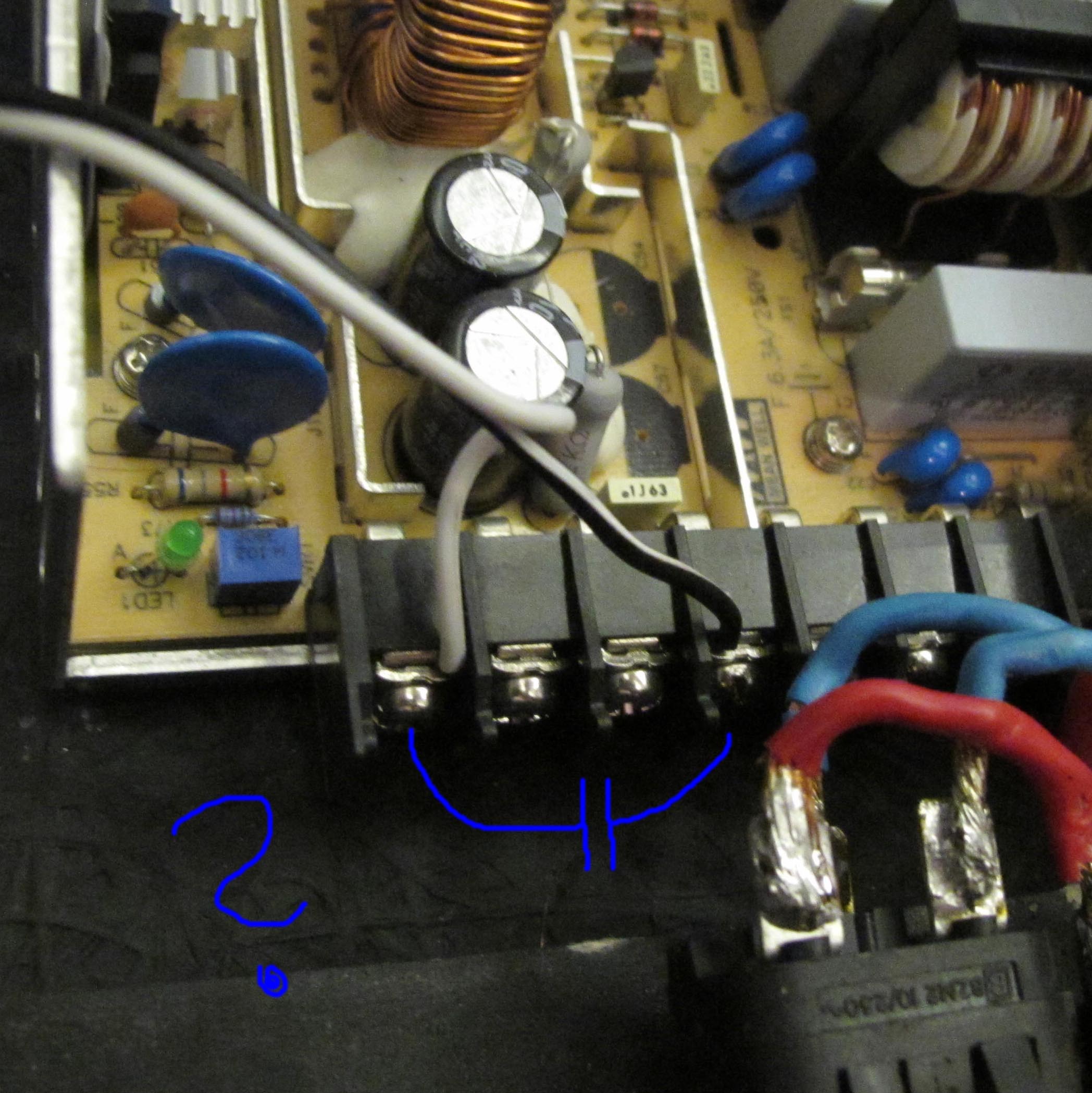

Need help on SMPS feedback (?)
Hi. How do I make a short between COM and ground ? Do I use only capacitor or also resistor in series. What values ?

Connect one leg of the cap to GROUND and another to COM. I think 0.1uF is enough.

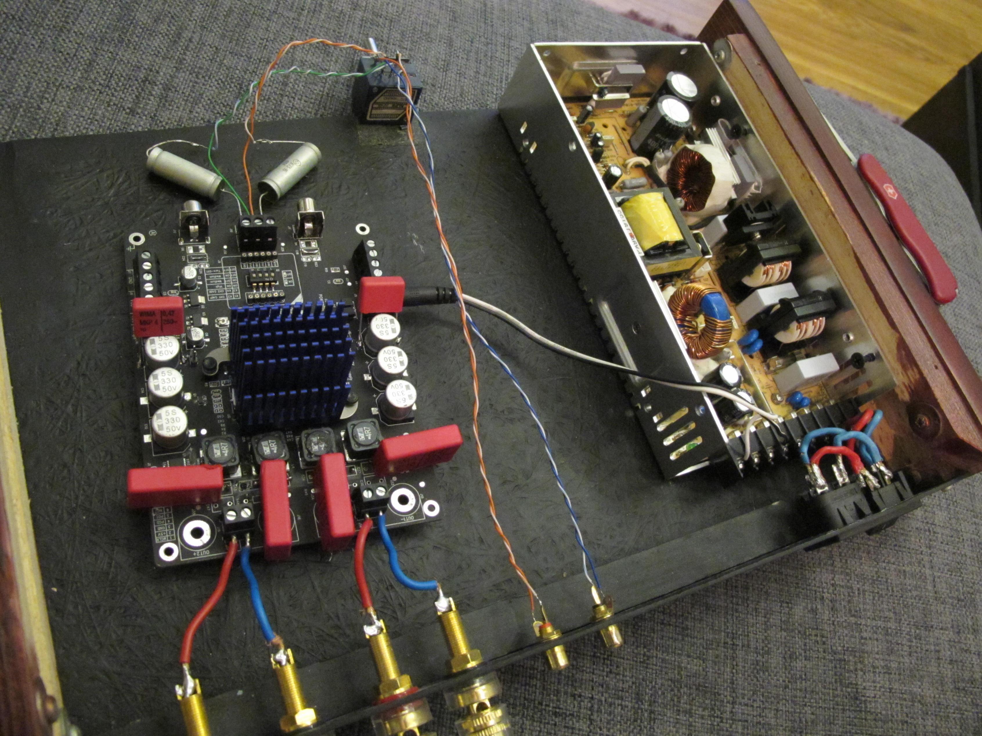

This alone might not work to get rid of the noise since all the caps you replaced have those long legs that are working like antennas and polluting your signal. Bigger is not always better.
HF feedback, you should be glad the amp is not extremely powerful, smoke is not excluded from the special effects if it would have been.
That is a high frequency output filter, you may have noticed the inductors have an extremely low value, close to just a wire. All the 'extension leads' you have added to the parts that don't actually fit on the board will introduce tremendous parasitic inductance radiating and picking up the switching signals. Apart from that you have chosen extremely inductive capacitors. As said above small is key in a high frequency output filter!
I've never seen a Tripath amplifier on which grounding was done properly either, not even my most favorite ones. I always take extra special care to make sure the ground at the audio input side (AGND) is not making any unnecessary connections, then one single connection to the power ground (PGND) through a little inductor (to block any unwanted switching noise) and then keep all these isolated from the casing/earth.

What would be the point of more capacitance on an SMPS? It runs on high frequency and that tops off the caps in a split second. Apart from that the high capacitance can cause the PS to oscillate as it becomes rather a big load on the high switching frequency.
100nF is fine, just to shunt any noise to ground, but it should already be present on the amp. They are most effective nearest to the load and furthest from the lead inductance. Placing it on the PS output is therefore far from ideal.
Another look at this pic suggests even more that you are not that aware... What would be more important, keeping the input leads short or the output leads?
Surely the input leads. Hence the use of extension shafts in many designs for the potentiometer. I am not even that worried about thise twisted pairs, they'll do fine when kept short.
Good lay-out and proper grounding is far more important than sticking on a couple of 'fancy' parts....
I am now 🙂 When I did this amp a year ago I had no idea.. 🙂 Anyway I have no skills/resources/time to make an extension shaft. But I would be vary glad to have one istalled.
Do you think there is any point in adding this 0.1uF short when I have those caps on input and output ?
