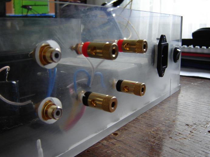

Re: pic1
where you get your toroid inductors that fit in also perfectly? How do feel assured that these toroids are of good quality? Is you PCB 2*50W or 2*10W version?
please report back how it sounds.
thanks.

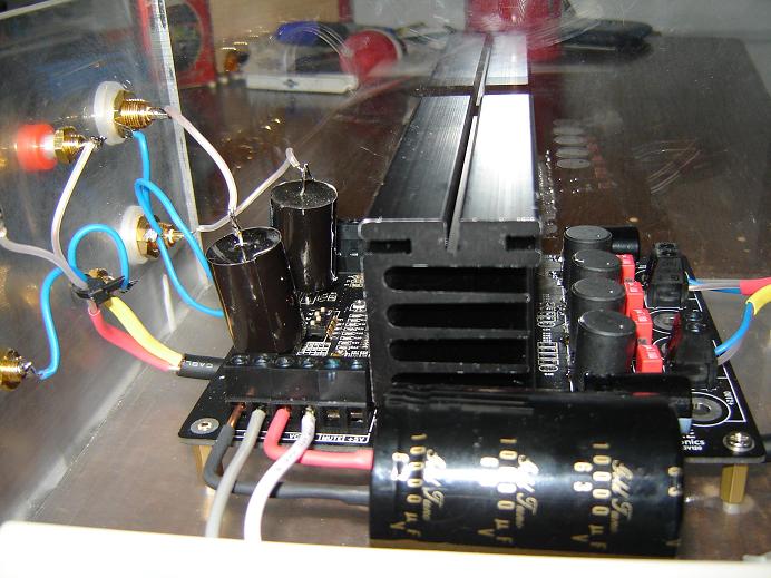

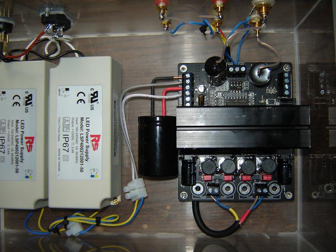

mravlcax said:Well here is my board in case, still isn't completely finished.
The board with this big heatsink doesn't go over 30°C, I also changed output coils to 10uH and caps to 470nF.
thanks.
Re: Re: pic1
Well I had these coils laying around and they have thicker wire than those stock coils, thats the reason I changed them. My board is 2*100W version and it sounds great for the money that was put in the project. I compared it to a solid state amp that uses 2sc5200/2sa1943 on output and has all high quality components(dale resistors, nichicon muse, silver mica, jantzen superior z on the input, etc). This amp has natural sound and the highs are very relaxed compared to this sure amp which has a bit aggressive highs but it has better bass. Overall I can say that the solid state amp is better. The test was done on the tannoy m1 modified speakers and the source was asus xonar D2 soundcard.
thanks.
Regards Aleš
basic newbie question, what compound do u use to "glue" the heat sink to the chip? Does the stuff used for CPU ("thermal silver??") also has the glue properties?
thanks,
gychang
My heatsink is so big that it can't be just glued to the chip. It is screwed from the bottom side. If you look at the picture on sure page you will see two holes and between the chip and heatsink is ordinary thermal paste also used for cpu. You were also asking which DC adapter to use, I suggest something that has 24V and 5A. My psu is a bit underrated but I don't listen very loud.
